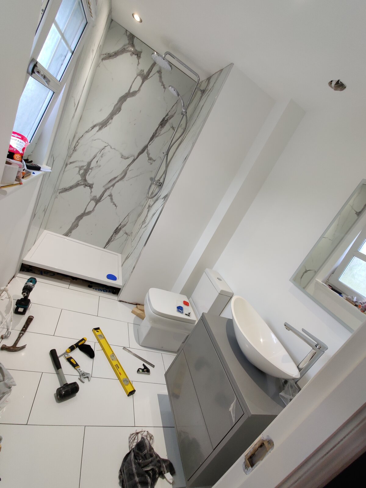

I've got a bit of an issue whereby I've installed a 760x1000mm shower tray but unable to locate a suitable door for it! Pic attached.
Ideally I'm after a hinged or pivot frameless door. I seem to be smack bang in no man's land between a 900 and a 1000 door. My smallest entry measurement is 947mm and I think my longest is 957. The adjustable ranges of the 900 and 1000 doors seem to not be able to accommodate my entry! E.g. 1000mm typically 960 to 990. Where a 900 door might typically be 865 to 890mm.
Has anyone fallen foul to this before, how did you get around it?!

So basically, go with a 900 door. Ditch the wall profiles that come with it, then use aftermarket wall profiles that have a little more reach? Is that basically how it works?
Not quite ,the profile extensions get screwed to the wall ,your enclosures wall profiles screw to the extensions, and effectively reduce the width.
