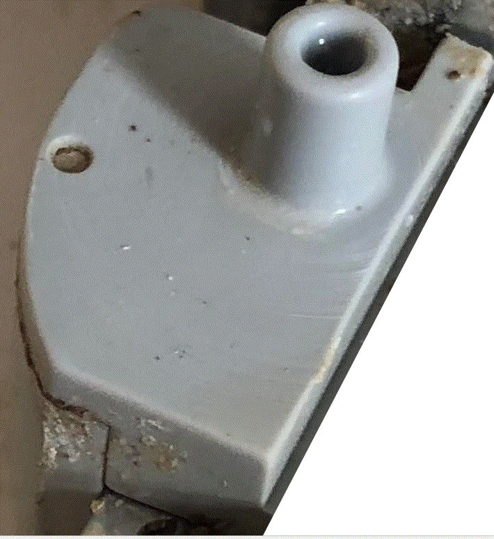

Hi, hope this is in the right sub-forum...
The bottom part of my shower door moved out of vertical alignment the other day and I figured it meant the bracket holding it on the bottom rail needed unscrewing and moving along a little bit.
However, upon further investigation, it seems the shower door wasn't actually properly attached to the hinge or bracket it sits on. I think I need a replacement.
Does anyone know where I might source one of these? And, even better, what's it actually called - I'm thinking it's a shower door pivot hinge... but Google is not returning me anything that looks like this when I search. I popped into Wickes, no joy, and the Bath Store, no idea.
It's all made of plastic. Really need a replacement.

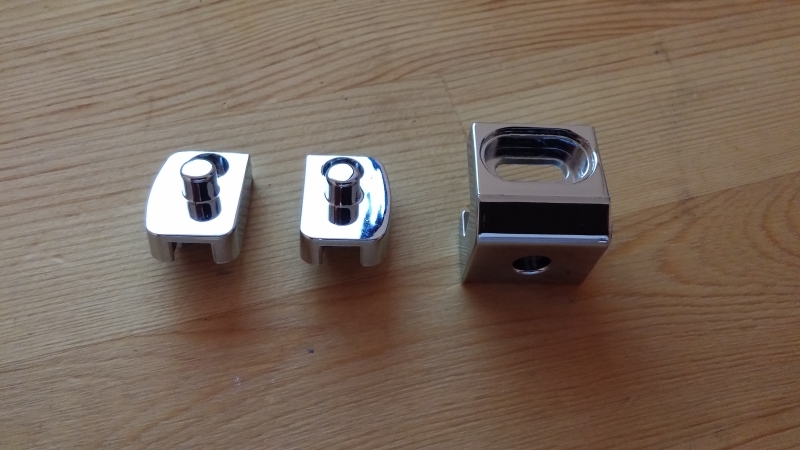

I found the spares that I have. There is a pin which is attached to the glass door at the top and the bottom. This pin sits in a socket which attaches to the frame.
Your photo shows the socket which I think has the broken off pin stuck in it. So that part is OK if you can get the broken pin out, but you will need a replacement pin which attaches to the door.
The pins look to be slightly different top to bottom.
I have attached a photo of the spares I have which show the socket and the two pins.
The manufacturer has a lifetime guarantee so i'm sure they would send you out some spares - their contact details are:
Manhattan Showers Limited, Marsden Hill, Brunswick Street, Nelson, Lancashire BB9 0LY
Phone: 0845 257 9030.
If you get nowhere with them, PM me (and let me know if it is the top or bottom hinge) and i'll send you one of mine, I've got two sets of spares so I should be OK even if one of mine break in the future.

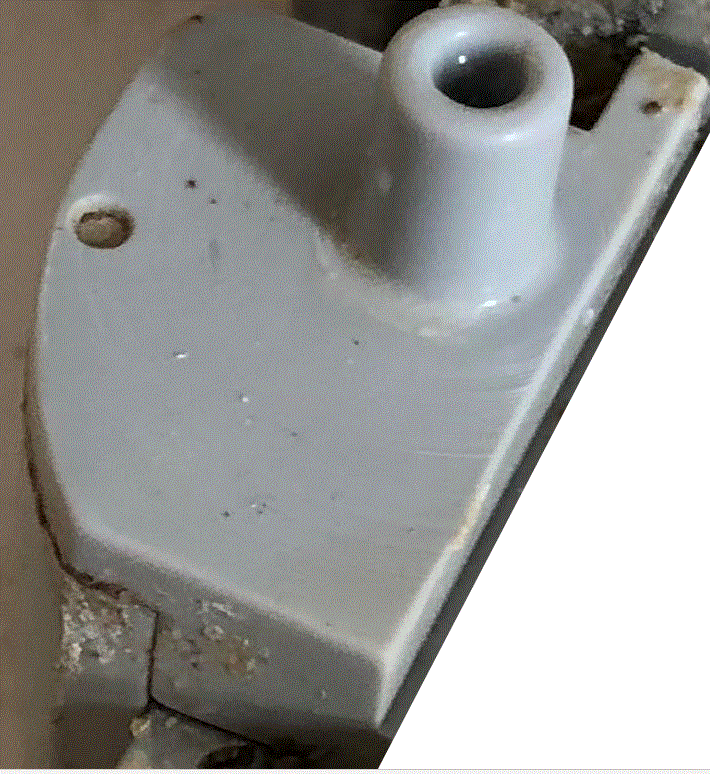

Hi, My pivot shower door's pivot is broken. I am attaching photo. Can anyone please guide me as from where I can buy it.
Regards,
Imran
