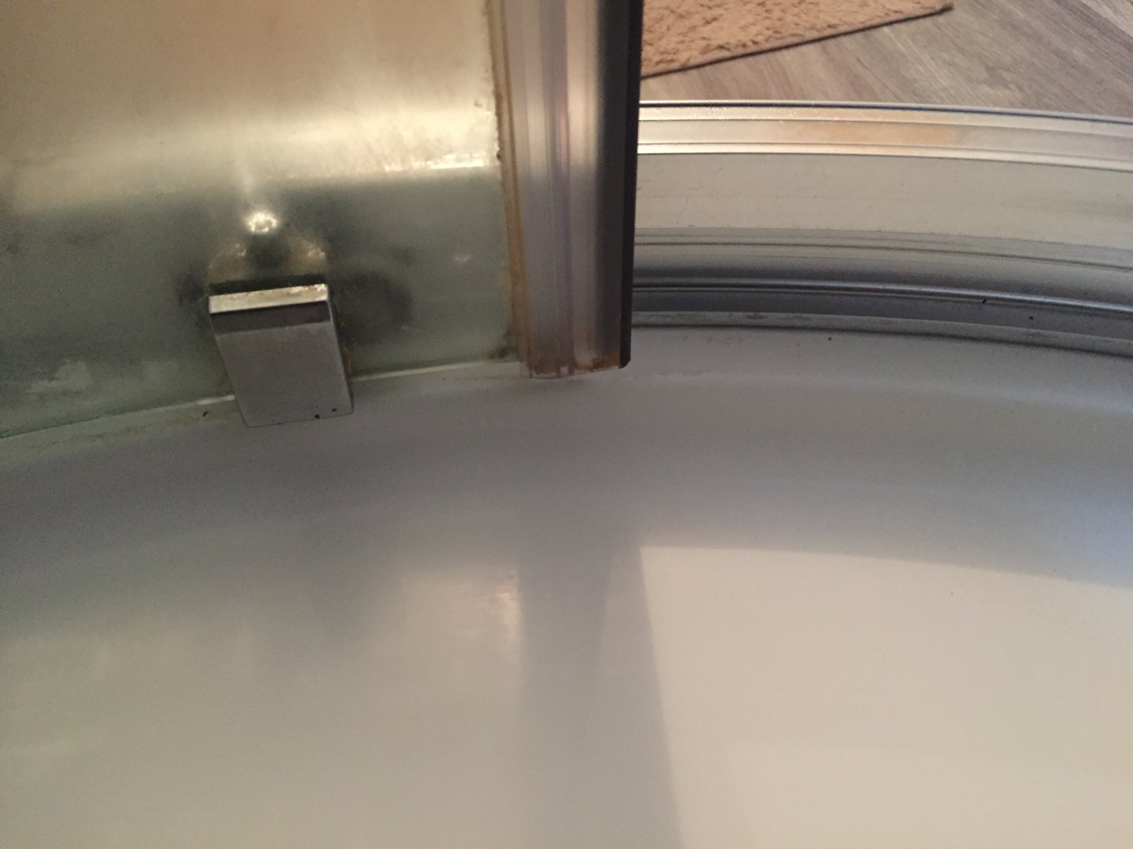

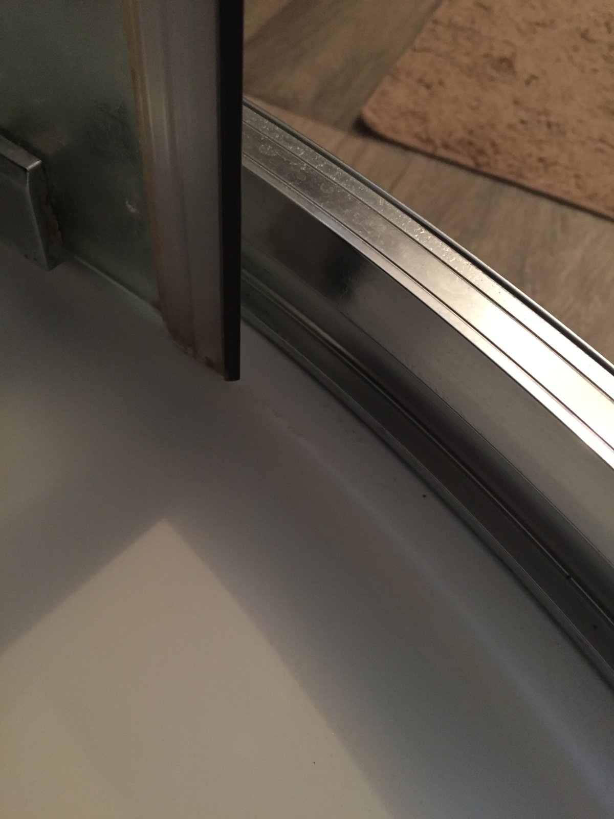

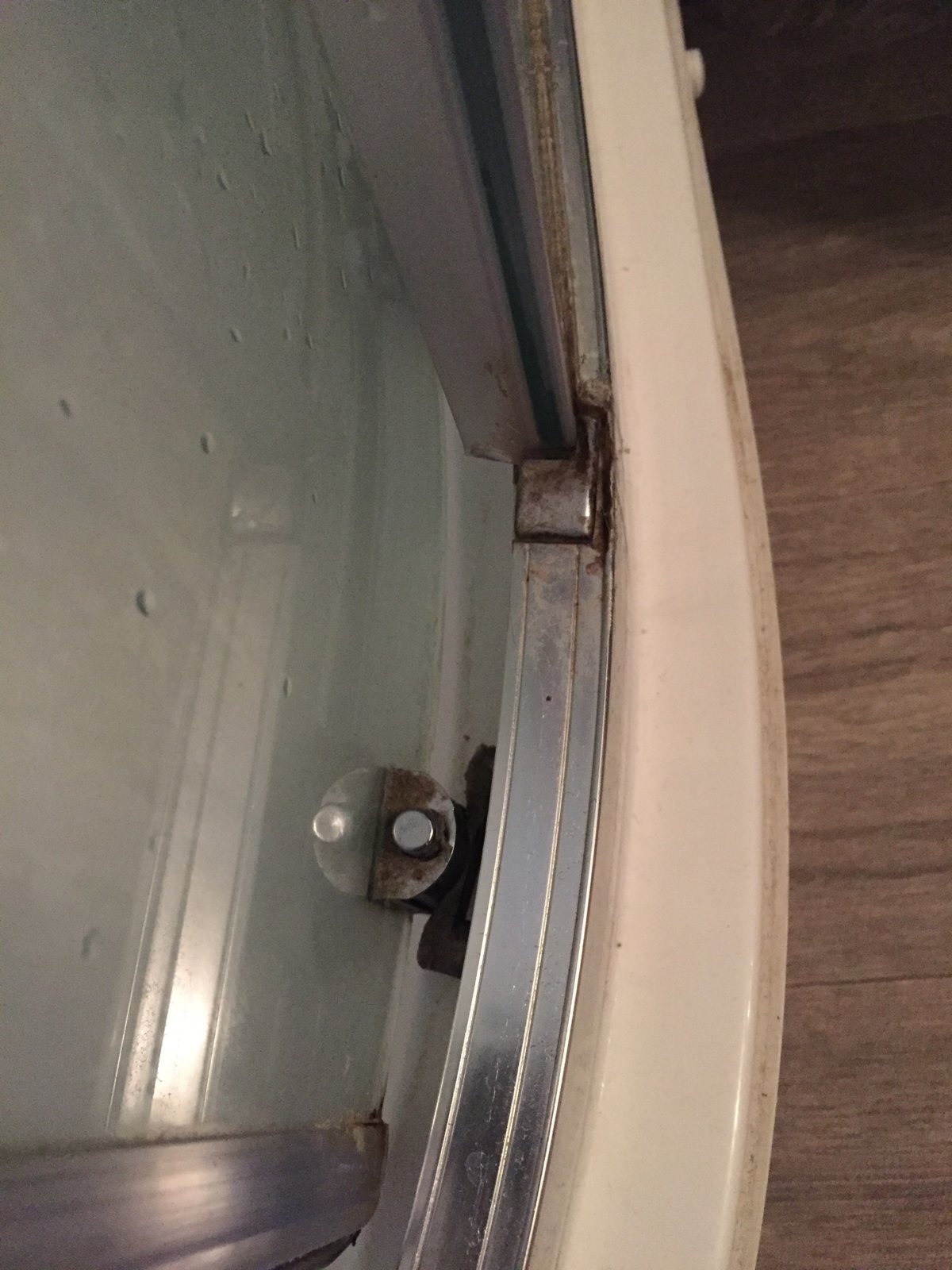

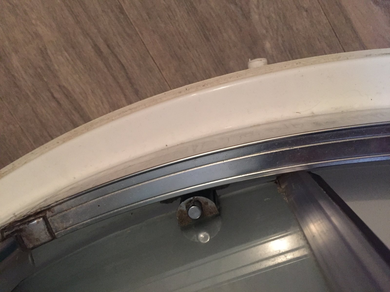

Is there a quick and simple fix for a Shower door (curved) that keeps coming out of its runners?
I have attached a photo, but most days, this keeps popping out at the bottom, and it needs to slide back in to its runner, which can be tricky?
If there are any tips, to keep these 'on track' then great, as its a pain sliding them back in all the time, by taking the door all the way back?
Thank you

The one instance when I have seen that problem there should have been clip at the bottom corner of each side of the door & they had snapped off. Can you post pics of the inside of the bottom of the whole door.

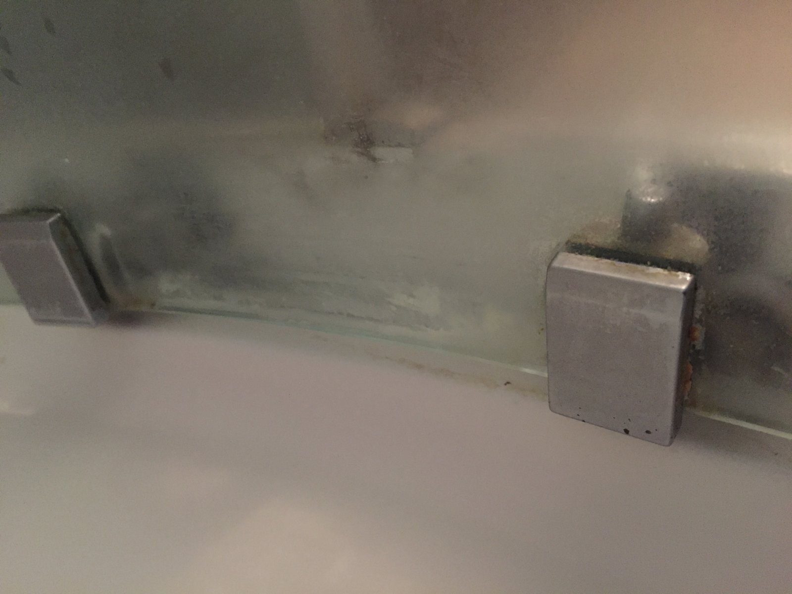

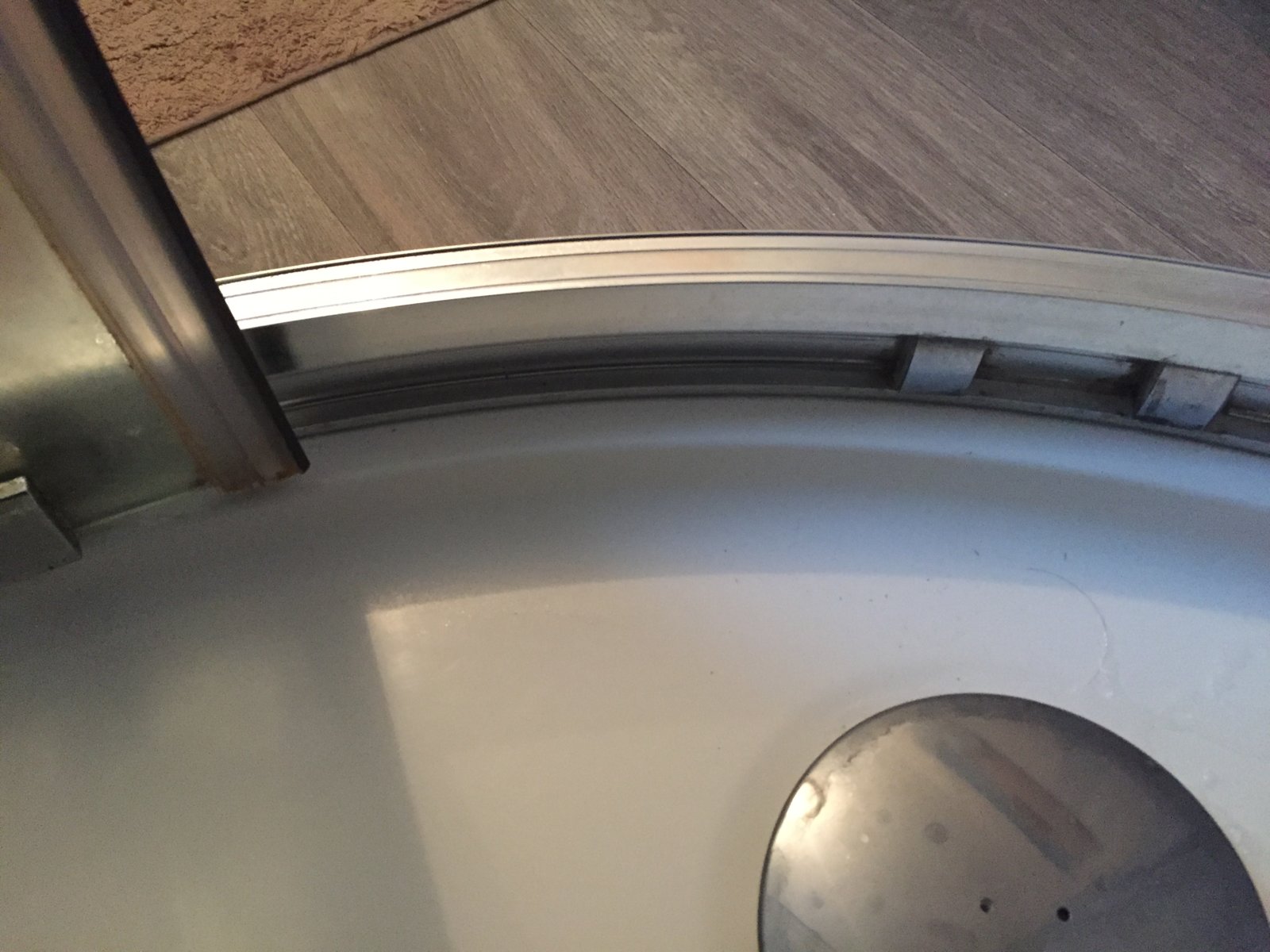

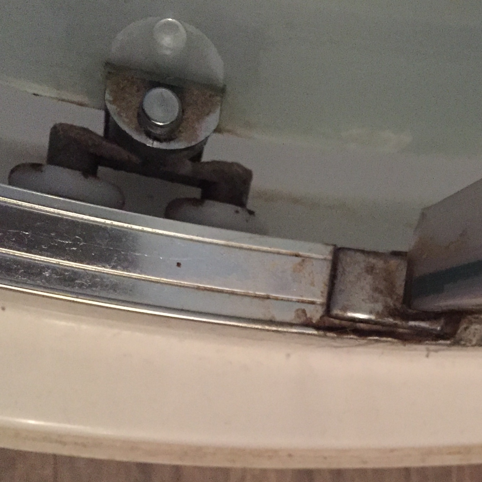

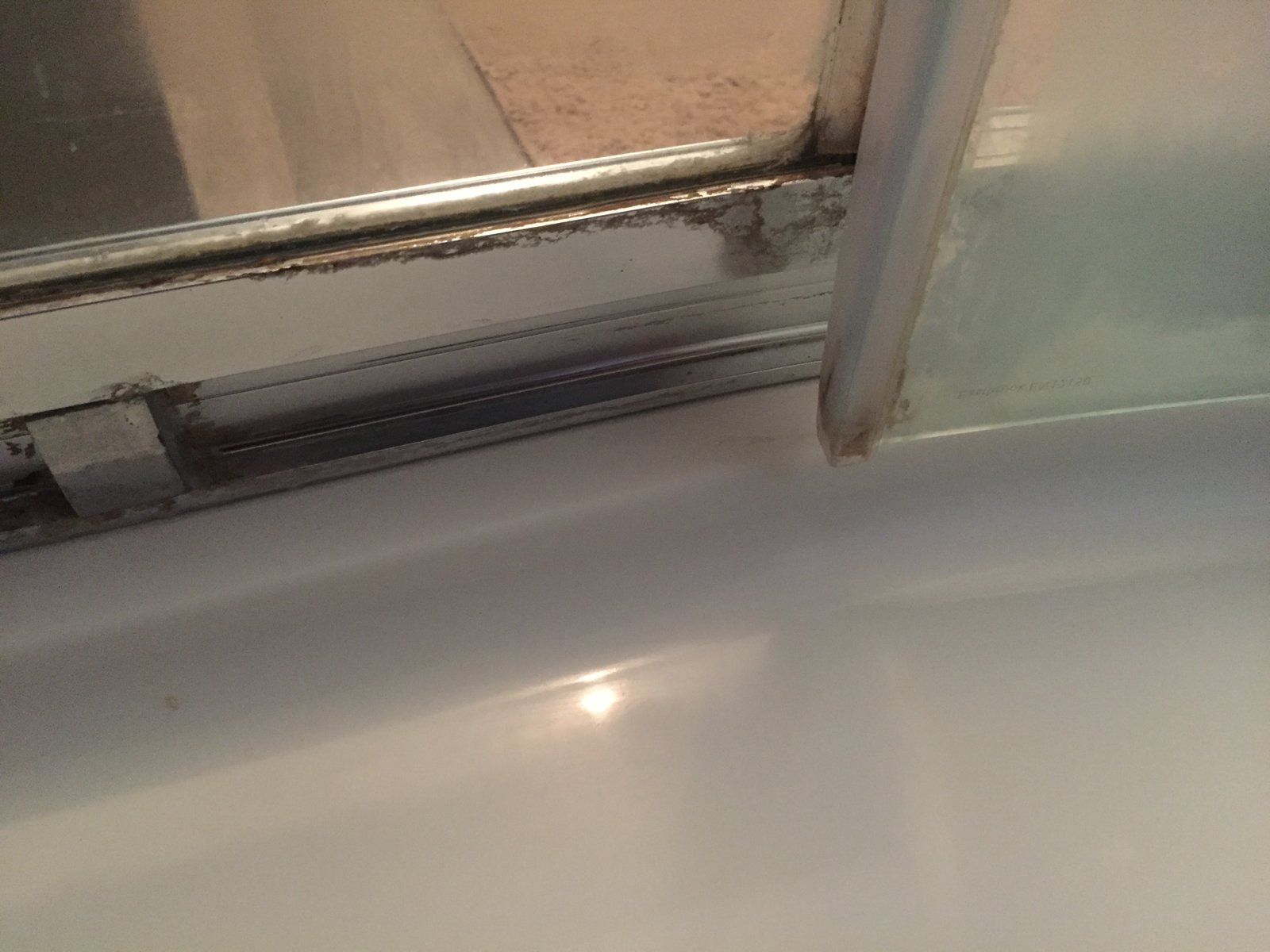

Thank you jj4091, please find attached some pictures that i've tried to take as best I can with regards the bottom of the shower door in that light..
If indeed these clips are missing, is it easy enough to buy replacements?
It sounds like and looking at your pics , that the pair of wheels have gone stiff and are not pivoting any more.
I'm assuming that this problem has only started recently and the doors worked fine before?
