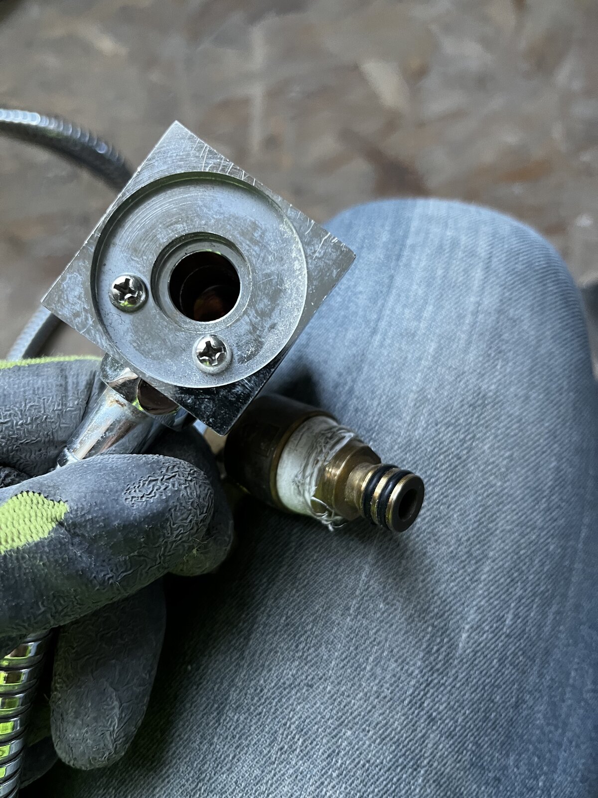

Here is the photo of the fitting.
Also cant understand how this get secured to the wall with those screws at the back. Am i missing some metal plate perhaps ?
Maybe its like those briston easi fit taps.
