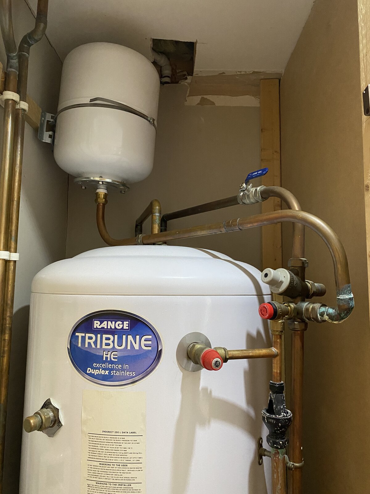

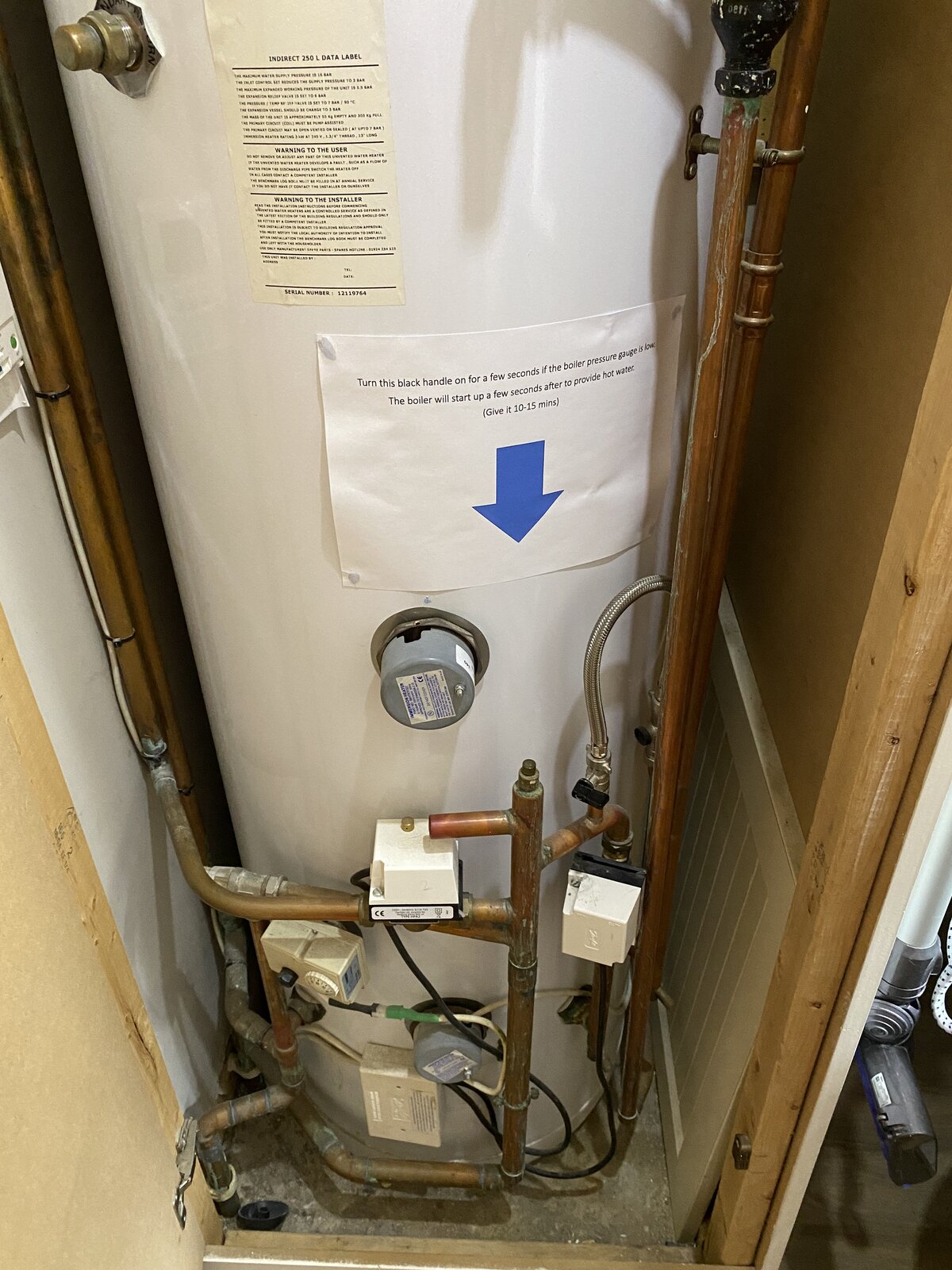

Sorry for the late response on this.
I've attached an image of the tank.
Could the undersized pipe feeding the cylinder be replaced if required?

22mm to that cylinder so you wouldn't usually need anything larger than that.
AS suggested, the issue you will have is when the cylinder fully heats up, the Expansion Vessel (EV) becomes pressurised. If the pre-charge pressure on the EV isn't set correctly then that pressure can end up being a bit higher than the mains supply pressure. When you open the tap the EV gives the pressure a little boost until it balances out.
The trouble is the EV pre-charge isn't set correctly and you have been misled into thinking that you have more pressure than the cold mains could supply.
You need an experienced qualified engineer in to service and check/setup the system properly.
Unfortunately though, if there's nothing wrong with the combination valve and the reducing valve (PRV) and EV is set correctly, then you won't be able to increase the pressure, that's dictated by the max available mains pressure and the PRV setting @3bar (if the dynamic mains pressure is above that)
Looking at those pics, the tundish is marked. Probably due to discharging.
I think expansion vessel for the unvented cylinder is full of water. It needs pumping out and pressurising correctly.
