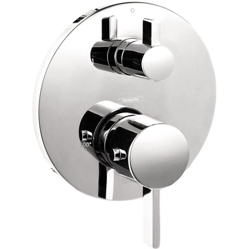

Hi everyone,
I have a grohe shower and with a dual tap arrangement (one controlling the flow and the other for temperature adjustment). The tap controlling the volume of hot water has a safety button on it which needs to be depressed before it can be turned. The problem is that the tap doesn't turn even with the safety button depressed, so there is no temperature control. It is stuck in a relatively 'hot' position and it's not possible to shower for long before the water turns uncomfortably hot. It looks similar to the one in the pic below.
It's probably a simple job to fix, but I was wondering if anyone had any experience with similar problems on similar taps. Or if anyone could recommend a course of action that I could try before going to the expense of calling someone out.
Thank you in advance for your help!
It will need a new cartridge - thats the water mixing device behind the control.
These are available from Grohe direct or the showerdoc.com - they are expensive though.
You may get the control to move more easily when it is cold, and if it does move it will free up to some degree.

Thank you for your reply Burnerman. It sounds like it could be a difficult job to fix.
Its not usually such a bad job - the knobs are removed and then the chrome embellisher plate behind.
With that out of the way, the cartridges are exposed and removed.
Obviously nothing can take place unless the hot and cold supply can be isolated!
Grohe do have a home call out service through their agents.
John :)

In London, lime scale is a highly probable cause. If you are handy, I'd suggest:
a. Identify exact model and get installation / servicing instructions.
b. Make sure you have the right sized spanners / allen keys etc, silicone grease
c. Turn off hot and cold water supplies to shower.
d. Refer to instructions, remove cartridge.
e. If it can be done, take cartridge to pieces
f. Soak cartridge (pieces) in lime scale remover (Kill Rock, Ataka or similar)
g. If dismantled, re-assemble using silicone grease to lubricate O rings
h. While shower is apart, locate and clean hot and cold water inlet filters
i. Replace cartridge in shower body.
j. Turn on hot and cold and test.
If you're lucky that should get you a few more years of use out of it. If it doesn't work, buy a new cartridge but be prepared for an eye-watering price. Then as above omitting e. through h. inclusive.
Repairs like yours are difficult to cost. If it all goes smoothly, maybe and hour to an hour and a half. But the old cartridge will be difficult to get out, the water may be difficult to turn off, O'rings may be damaged and if a non standard size will need to be ordered.
Good luck
