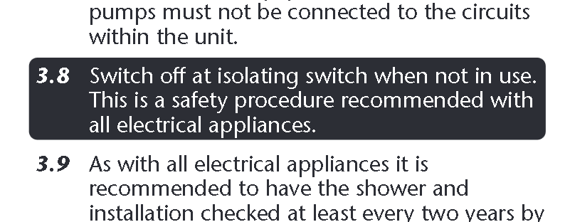

This sort of wording appears in many, if not all, shower manuals:
It's even highlighted in this one.
When Winston says "no requirement" he means "no obligation."
Which is not the same thing.
There is a requirement, here's another instance:
MI's show the requirement whether or not 7671 insists on it, if not fitted the warranty or insurance can and will wiggle out of it if they can.

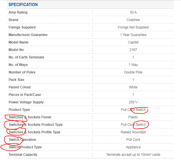

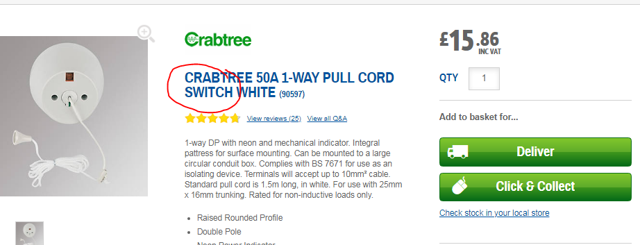

Local isolation is not a requirement of the Wiring Regulations -
so how can you say what purpose the person had in mind when it was fitted?
... so how can you say what purpose the person had in mind when it was fitted?
Quite so. If, as some do, they have the switch fitted so that they can (for whatever perceived reason) operate it before/after every shower, then it is clearly nonsense to say that, in their case, "The switch is only their for isolation".
As for "... a great deal of wear and tear on the switch", I would imagine that most light switches are operated at least as frequently as would a shower switch used before and after every shower, and that many are operated far more frequently that that. My ageing memory may be a litle dusty but I cannot recall any occasion in the 30+ years I've been in my present house when I had to replace a light switch because it had failed due to 'wear and tear' - and that despite the fact that, unlike shower switches, light switches are invariably operated 'on load'.
Kind Regards, John
I have had one light switch fail here in a slightly longer period and I agree, they rarely do fail, but they are wall switches. Ceiling light switches fail rather more often, they are maybe more complex/ more delicate and abused more - yanked by the strength of an arm, rather than a finger tip. An additional problem is the current the have to carry, even if they don't switch it - up to 45amp, in what is a fairly compact space. They also use a similar mechanism to many ballpoint pens, to convert a pull into on on/off. The mechanism of lots of these pens fail. There are also lots of complaints of shower pull switches failing in this forum.
I have also never heard of a wall mounted shower isolator switch failing.
