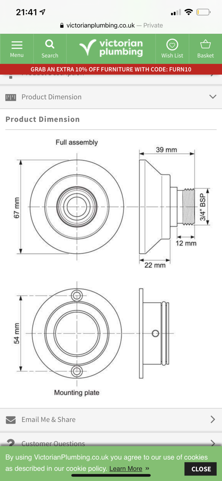

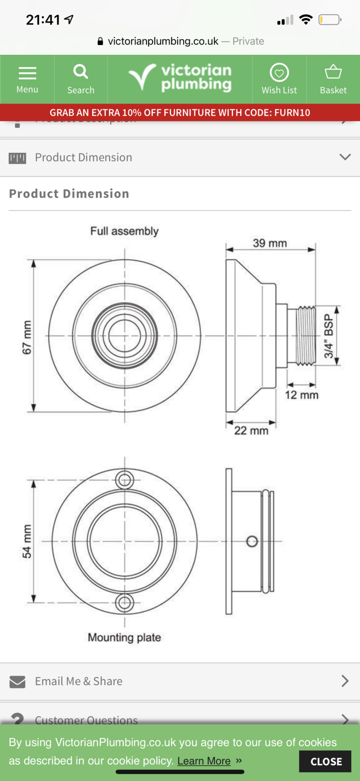

I think it’s just a bit of lazy ness . He has now replied to say he will sort it. I presume if that doesn’t work he can shower by different sleeves like the one in pictures.
