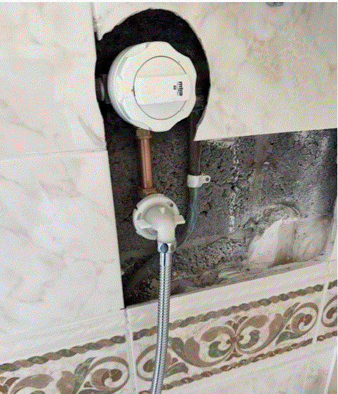

I’ve got a leaking shower valve and the leak is behind tiling that fixes onto plasterboard onto brick outer wall.
In order to get to the leak and replace the faulty valve, I’m thinking of cutting out the tiles around the valve so these can be re-used using a multi tool.
My concern is that the plaster board complete with tile will be removed and that the process to replace the plasterboard ready for the tiles to be put back on will leave a weak point that water could penetrate should the tile growing break down over time.
What’s the best way to approach this?

Hi All.
I had a leak from the outlet joint on my Mira88 shower valve and the leak was behind the wall tile. Using a multitool I managed to remove the tile without breaking it and I've now repaired the leaking joint. We've check for leaks and all is now perfectly sealed.
Next step is to replace the cut-out plasterboard and then fix the orignal tile back into place. I'm looking for some advice regards doing this correctly. Ideally I don't want to cover the pipework with bonding plaster inorder to fix the plasterboard in-place has this would make future repairs very difficult.
Anybody that can offer some advice would be most appreshated.

Make a template from cardboard.
Few blocks of wood the correct depth fixed to wall.
Cut to correct shape the elements board then screw to wood.
CT1 around edges.
Tile and grout
