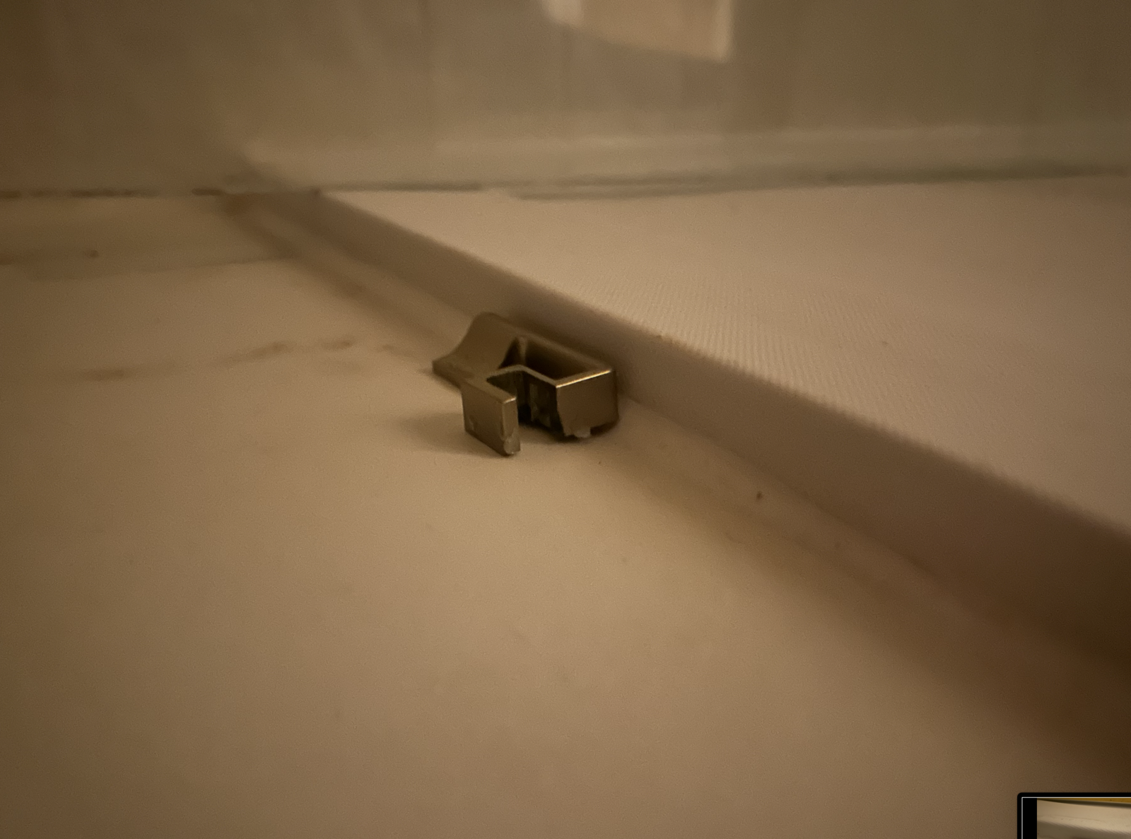

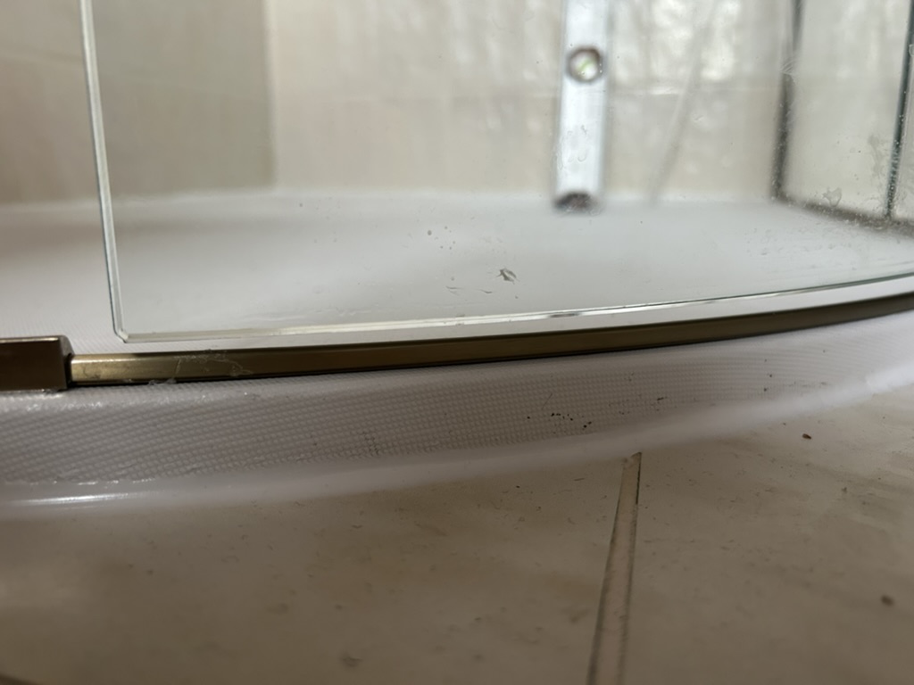

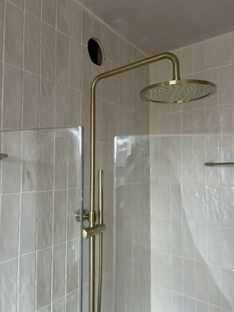

Entering the final stages of the bathroom renovation and the enclosure was installed on Friday. The fitter struggled with it and said that 'it wasn't right'. When the bottom seal was installed on the shower door, it wouldn't clear the rail designed to deflect water into the shower and there were some very obvious issues with the panels.
The most obvious issue is the drop between the wall-mounted shower panel and where it meets the door. It isn't obvious here due to perspective but the drop is perhaps 15mm.
You can see at the bottom that the door (bottom seal removed) and the rail don't run parallel:

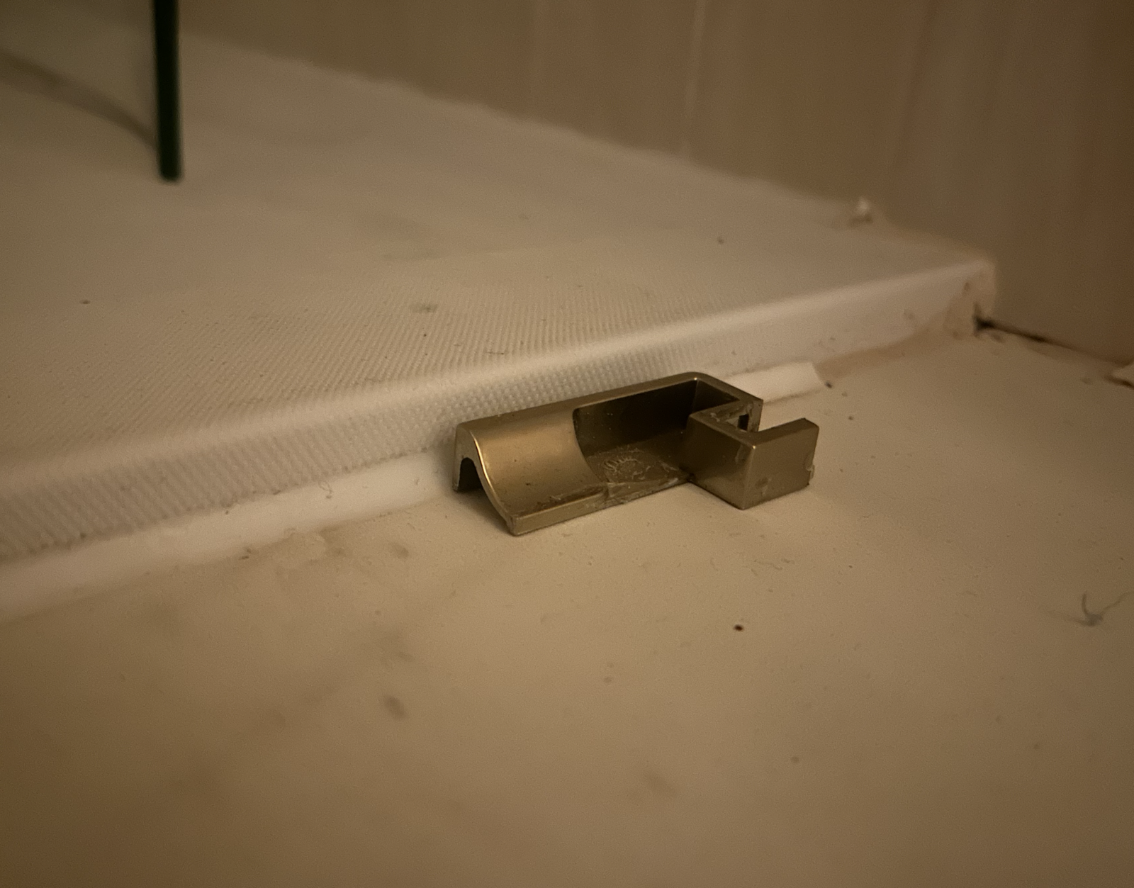

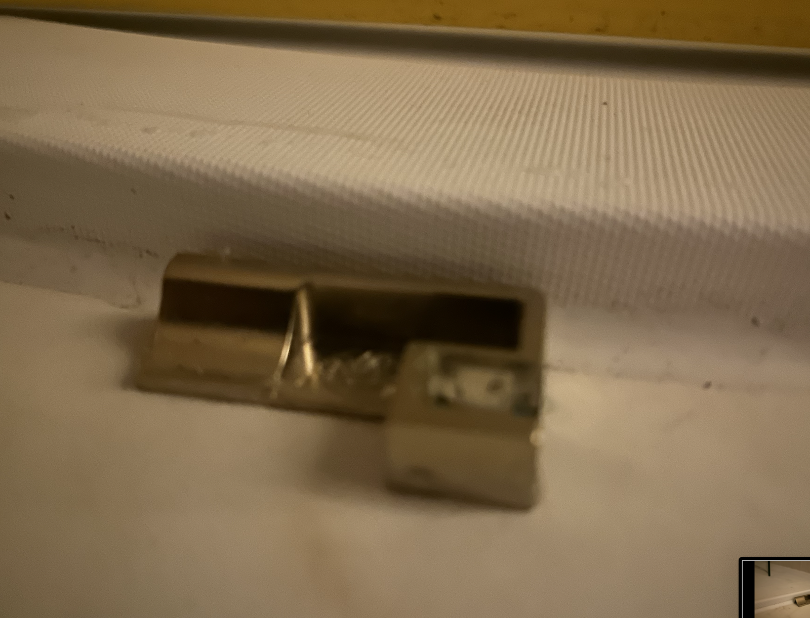

The fitter had also installed the retaining bars for the glass the wrong way round (appreciate this doesn't paint a good picture) so I removed the enclosure myself for the tiler to replace the drilled tiles.

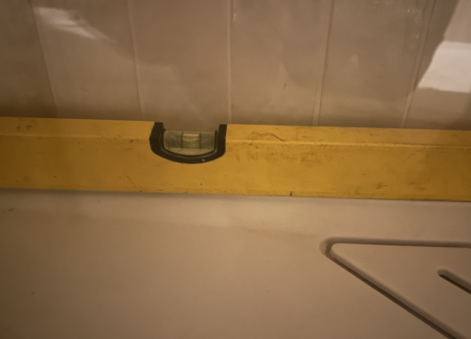

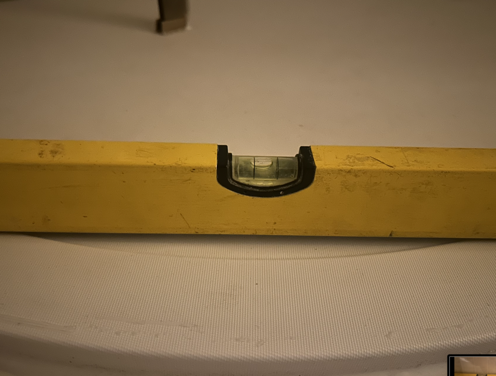

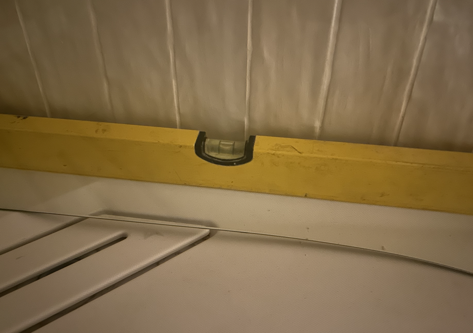

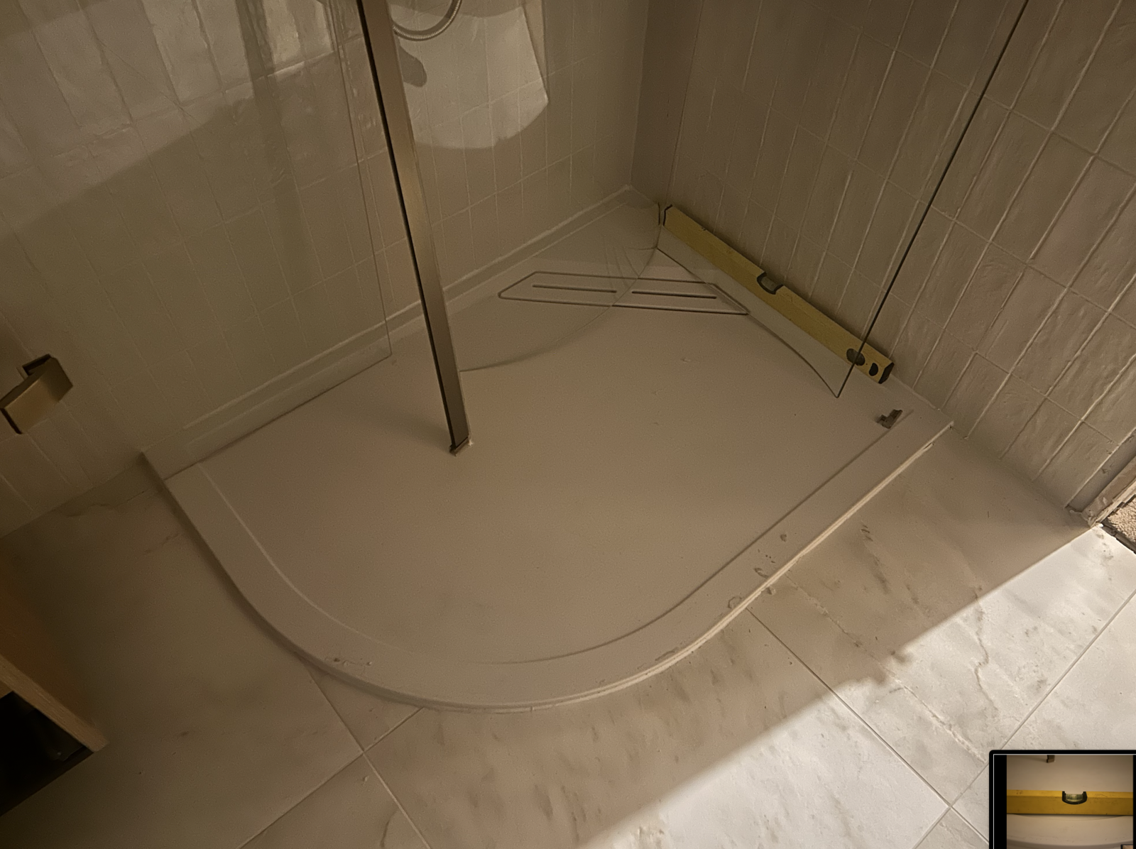

In doing so, I found the issue. The tray is level across the back walls but not around the curvature and you can see it 'sinking' into the floor as you trace a finger around the curve.
Screenshot 2025-02-19 at 21.50.45.pngScreenshot 2025-02-19 at 21.50.52.pngScreenshot 2025-02-19 at 21.50.58.pngScreenshot 2025-02-19 at 21.52.52.pngScreenshot 2025-02-19 at 21.52.54.pngScreenshot 2025-02-19 at 21.52.58.png
Due to a quirk in ordering the enclosure, I effectively ended up with 2x the metal parts so can do a clean install with fresh parts other than glass but theres no way to vertically adjust the panels/hinges. I contacted the manufacturer and they maintain the tray must be totally level. So my options are:
1. Get them to rip out the tray (possibly damaging it) and re-level. No idea how destructive this would be. Fitter is at fault and is onto his next job but I have £1500 in reserve that I've not paid him yet on the original agreed price.
2. Attempt to reinstall the enclosure knowing the tray isn't level along the curved side and try to make it work. This might mean having to remove the seal entirely from the door.
3. Swap the hinged door enclosure (paid £625 for it...could maybe repackage and sell for half that) for a sliding door enclosure that might hide the issue more easily.
I was tempted just to go for option #2 as we're keen to get the job finished now but looking at the tiling and the adjustment required, I'm wondering if option #1 might be more straightforward than I realise.

I don't mind that it isn't level with the floor but the enclosure didn't look great. The seemingly slight deviation is exacerbated by the projection of the glass and door hinging from the lower panel.
Reading around the topic, I think the best course of action is to have the fitter relay the tray. Will see how that conversation goes tomorrow.
If the tray hasn't been laid level then unfortunately it simply hasn't been installed correctly. That's sits fairly and squarely with the installer and it's for him to fix. I see it's flat to the floor, hopefully it is sitting on some nice solid sub flooring and the space has been tanked?
None of the pictures of your level, show the level to be level
If you don't want to remedy this you might be able to re-hang the door so water drops off it into the tray depression rather than onto the raised edge of the tray, and perhaps there is enough fall on the tray bowl to stop water pooling and remaining in the corner on the short edge opposite the drain
Bodging it this would annoy me though, and every time I took a shower I'd be reminded it was wrong. YMMV?!

Yeah - jackoboards are lightweight backer boards, good for the tiling. I would still like to have seen the space tanked, that's a waterproof membrane that is typically painted onto the wall and floor with waterproof tape used to seal up corners/edges and any seams.
As far as bedding the tray is concerned Kudos do say a sand a cement mix is to be used but the tray must be installed level along all of it's axis and if it isn't then it needs to be corrected, again back to the installer. Understandable he's not happy but it's his fault so good he'll sort it.
