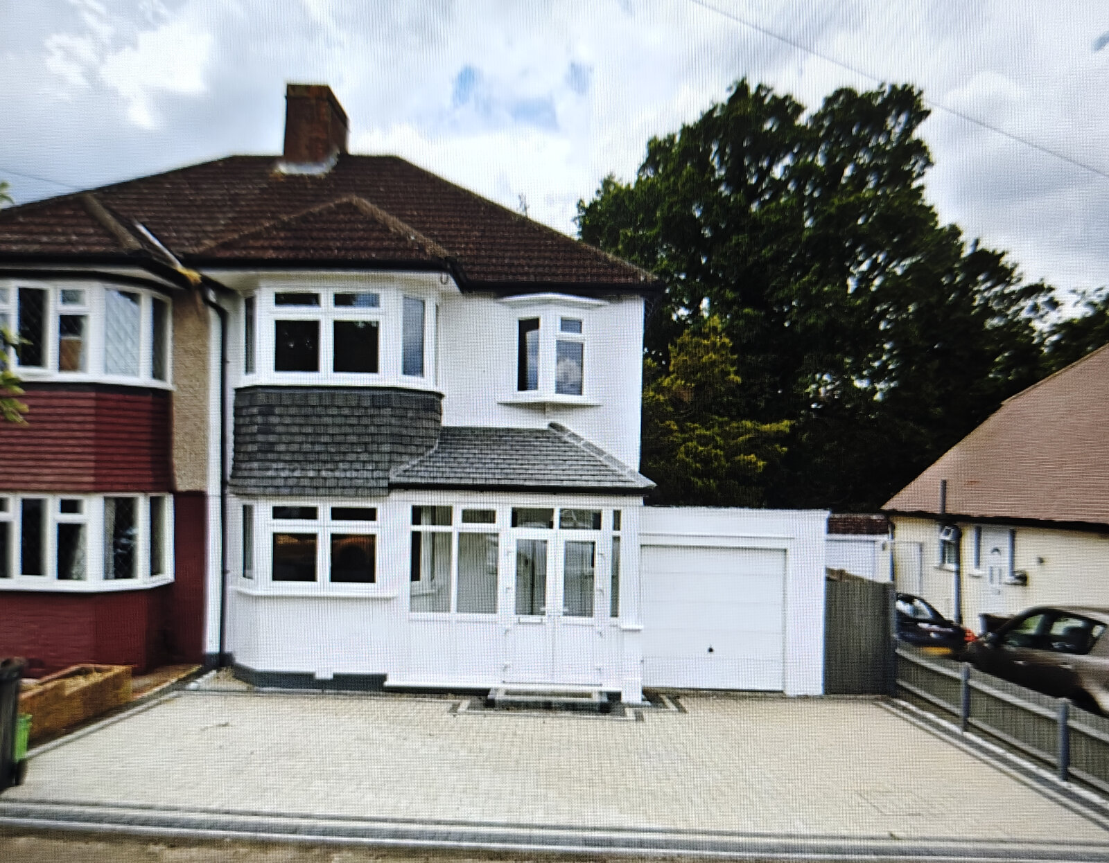

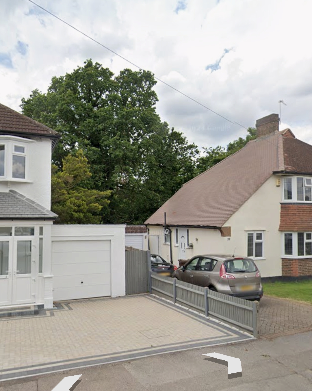

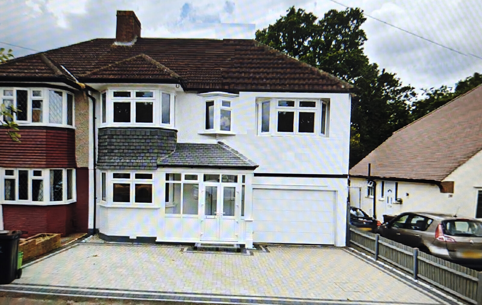

Hi all
We have a semi detached house and I am considering the possibilities of a 2 story side extension.
I would like to keep the garage on the ground floor, making it wider.
The only question i have is, would i be able to create an extension like the 2nd picture, where it comes upto the boundary as much as possible?
Some have said to come up to the side gate, and leave a gap to avoid that terracing affect.
But the considering the style of my neighbours house (3rd pic) i dont think it will create a terraced style view
Please excuse the poor drawing, it was done on Microsoft Paint.
Thoughts?

DON'T lose that alleyway. You will regret it.
Bear in mind if you want the widest extension you’ll probably need the cooperation of your neighbours to build it and they don’t have to give you access
Even now, we often find ourselves going through the garage door instead of the side gate.
I wouldn't mind keeping the side gate, the only thing which is annoying is that, the garage isnt wide enough to fit a car in "comfortably".

Can't see any obvious reason why that shouldn't get planning.
Yes you can build on the boundary line but that probably would stop your neighbours doing similar in the future due to the terracing effect.
Id probably build it inline with the single row of light coloured block pavers, I'd guess that will give you a 300mm gap to the boundary and still give you alot more room inside the garage.
First thing I'd do before anything is speak to your neighbours and show them the pictures you've done above and discuss it, nothing will **** them off more than the first they learn of it being the planning letter coming through their door, and there's no need for it and undoubtably at some point through the build you'll need some goodwill or grace from them.
Looking again I'd probably redesign that porch bit too so it's roof extends out over the garage as it'll look more tied in.

If you build right up to your boundary then your soffit and guttering wound overhang your neighbours land which so you will have to have a boundary wall gutter which I dont think is a good long term idea.
Could you make it as wide as you can but still maintain a side access, the one you have looks quite wide, can you get away with smaller.
Or build to the boundary but still have a side access like and entry so the bedroom above is to the boundary.
