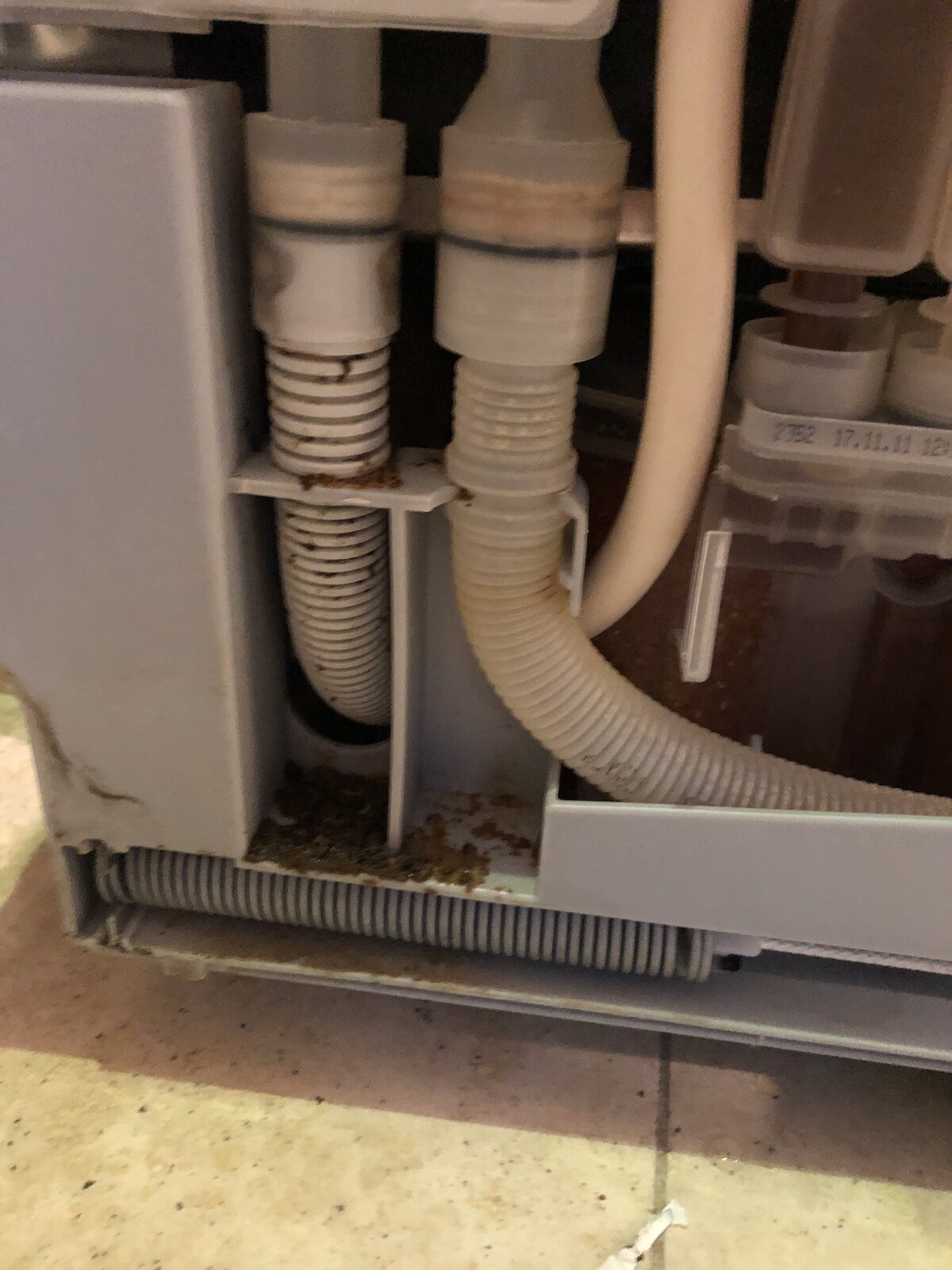

The description of your work 5 years ago is very helpful, but I can't quite figure out how to remove the big plastic water manifold -
Here's a useful YouTube video:
@NotaJock - no, I never found out why it refused to throw an error code. Guess it will remain one of life's little mysteries! That YouTube video you posted is a LOT clearer than my description so thanks for adding it. If you look at photo Leak1, my Siemens machine is a slightly different manifold design - there are no torx screws, there is a slide-up plastic hood over the bottom screw inside the machine (see photo Leak6), and only one clip securing the manifold to the body of the dishwasher. In the video he mentions lifting the manifold up - but you actually have to pull the top of it it outwards so the bit with the seal on (Leak4) is clear of the hole in the machine (Leak3)- and then it just lifts up, but it needs a bit of brute force to pull the manifold off those flexi hoses with the O rings. I managed to do my repair without needing to remove the inlet hose, as I just needed the manifold clear of the body of the dishwasher to do the clean and re-seal.
Now that is going to be really helpful to know.
Unless I decide to try to clear the gunge inside the manifold (what I discover is often called the matrix in other places) - a whole new level of complexity... I need a little more If It Ain't Broke... restraint.
Thanks again.
@NotaJock you're welcome. Looking at your photo, I'm just thinking that you have a lot more gunge below that left hand joint than I had, yet it's still surprisingly clean above it. I've just dug out this posting of a similar example where you can see the point I'm trying to make - i.e. it is a mess above the joints too so it's obvious the leak is from above. So don't rule out that O ring as a possible cause unless when you run the machine, you see tell-tale traces of water where I have the red arrow in photo Leak2. Hope you get it sorted.
