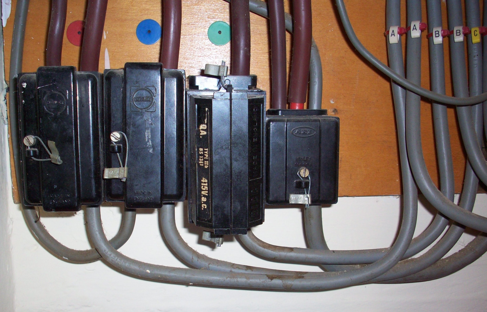

Hi all
I'd just like to know out of interest, in these days after harmonised core colours in cables e.g. where a 3 core & cpc cable changed from red/blue/yellow to brown/grey/black, how does the DNO identify the 3 phrases? I believe they were originally red/blue/yellow too, are they now known by different colours?
What brought me to ask is that certain areas of my town had a power cut tonight and it reminded me of the time my terraced house and the two adjacent had no power but the rest of the terrace were unaffected, am I right in thinking it was the particular phase we were on that had tripped out at the substation?
Cheers
Matt

As for the colours, they were red/white/blue before the yellow arrived. DNOs and the electricity boards before them used various identification methods including other colours, numbers, letters and various combinations of all of those.
In my opinion switched wires should be identified with another colour. In Australia they were white in red/black days, not sure what they do now. In France switched wires are mauve or orange, or both used in two way switching systems.
It would mean having special cable with brown and orange or all three but so what?
Was green a phase colour once?
My 13th Ed. has the three phases listed as R, Y and B but Phase Y is listed as being white.
I have an iron in the loft from the '30s with brown for the earth wire, so maybe green was a phase colour then.
Historic remnants next to the DNO fuses for my supply suggest that the answer is 'yes' (The 'A', 'B' & 'C' phase identifiers on the cables which enter the meter are also rather novel!) ... (and I've commented previously on the red insulation of the incoming neutral - which they've now hidden with some grey silicone!) ...
Kind Regards, John
I've established that brown/grey/black are the colours used to identify the 3 phrases now, as they are the colours used in 3 core cabling. OK Then.
