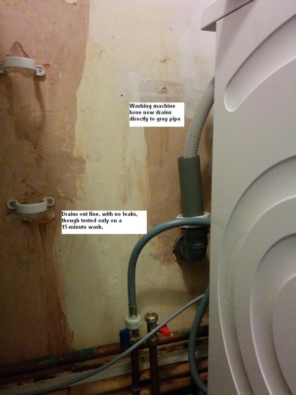

We've just replaced our washing machine and in order to get a straight connection to the cold water pipe I had to temporarily remove part of the drainage pipework, as it was in the way. When I connected it all up again I had a leak and I *think* it's because it had been bodged before by the chap who did our utility room and maybe I dislodged some sealant or putty or something.
But looking at the system of pipes, I don't see why it had to be so complicated and I was wondering if I can simply stick the machine's drainage hose into the final part of the outflow pipe, without having to connect up all the various bends again. The previous washing machine's hose simply hung into a TALL vertical pipe which then wound round to the final outflow. Can I stick it instead into a SHORTER vertical pipe? What does the U-bend actually *do*?
I'm new on this forum and the image settings are different to what I'm used to. I have uploaded "before" and "after" pictures at //www.diynot.com/network/pat9367/albums/22788, to better explain what I'm doing. I'm not sure how to attach them to this post.
Anyway I'd be really grateful for any advice on the drainage connection. Thank you.

The u bend or trap creates a break in the air rising up from the sewers through the pipes and into your kitchen. It's necessary.
I think there should be a flexible washer under the big "nut" that squashes up when you tighten it onto the lower part. Then you wouldn't get water leaking from it.
But then shouldn't the bottom end of the vertical bit be threaded? It's not, it's just a piece of pipe, so you can have the big nut as tight as you like and the pipe still just pops in and out. And the copper pipe is green directly underneath the u-bend, so there seems to have been a leak here for some time, though probably minor enough to evaporate unnoticed. No doubt taking these pipes apart has made it a lot worse.
... for the sake of a fiver I'd just replace it.
Good advice I think! I already bought the bottom part from Wickes today before I realised the other part isn't threaded. You live and learn!
The height is necessary as if the waste pipe from the machine is very low, the water inside will flow out continuously, or if it's moderately low the water can syphon out of the machine.
