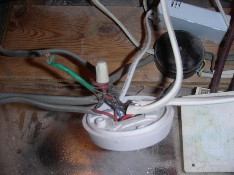

I currently have three cables coming into my upstairs lighting ceiling roses.
I would like to convert these to the simple one wire solution so there's just one Neutral, one switched Live and a earth.
Is it best to use a junction box, choc box, or strip connector and insulate with tape.
If junction box is best how many ways should I use and what amp rating?
Is there access from above?
Don't use chock block and tape it up - yuk!
Yes - Loft is above.
I plan to tackle this tomorrow, I may as well do all my upstairs lights whilst I'm in the loft.
What rating of JB should I use?
5A for a normal 5A lighting circuit however for what it is worth you may as well use a 20A one and give yourself a bit of room. You'll probably need the 4 terminal one if you have 3 x twin and earths in there - note which one is which before you disconnect. One will be the cable to the switch.

Most new fancy light fittings have only three connection terminals - L.N.E
Before I board the loft i'm gonna future proof them and save myself hassle in the future if I even change from the standard ceiling pennants.
Just remount the ceiling roses at a convenient position in the loft with a flex down to the fitting, you don't need any junction boxes.

Thats a totally crap way of doing it. The existing pendant fittings are not suitable for that.
The existing wires go into the base of the pendant fitting. What did you have in mind, just leave them laying loose under his newly boarded loft?
What about the requirement for strain relief on the cables?
TTC.. I can see where you're coming from. However, strain relief (I guess you're talking the flex here) could be provided by the rose, and by using 3 core flex, you have a cpc, too. Secure the rose, though.
This would be acceptable, surely? Maybe not usual, but acceptable nonetheless?

I was talking anout the three (maybe more) fixed wiring cables that go into the existing pendants. The pendant itself would need to be screwed to a joist and the cables come out of the base, not the sides.
Otherwise it will look like this:
The cables themselves need to be secured (clipped) and
The outer covering of the cables will need to be inside the pendant.
Its not impossible to do that with the pendant but it would be a real hassle.
He's going to have to disconnect the old penndant fitting to remove it and then take it into the loft to re=teminate. I dont see the point of saving 50p by not using the correct terminal box.
A fine piece of work TTC, well done.
A bit more than that, but he's only got 3 to do, so why not use something ideally designed?
