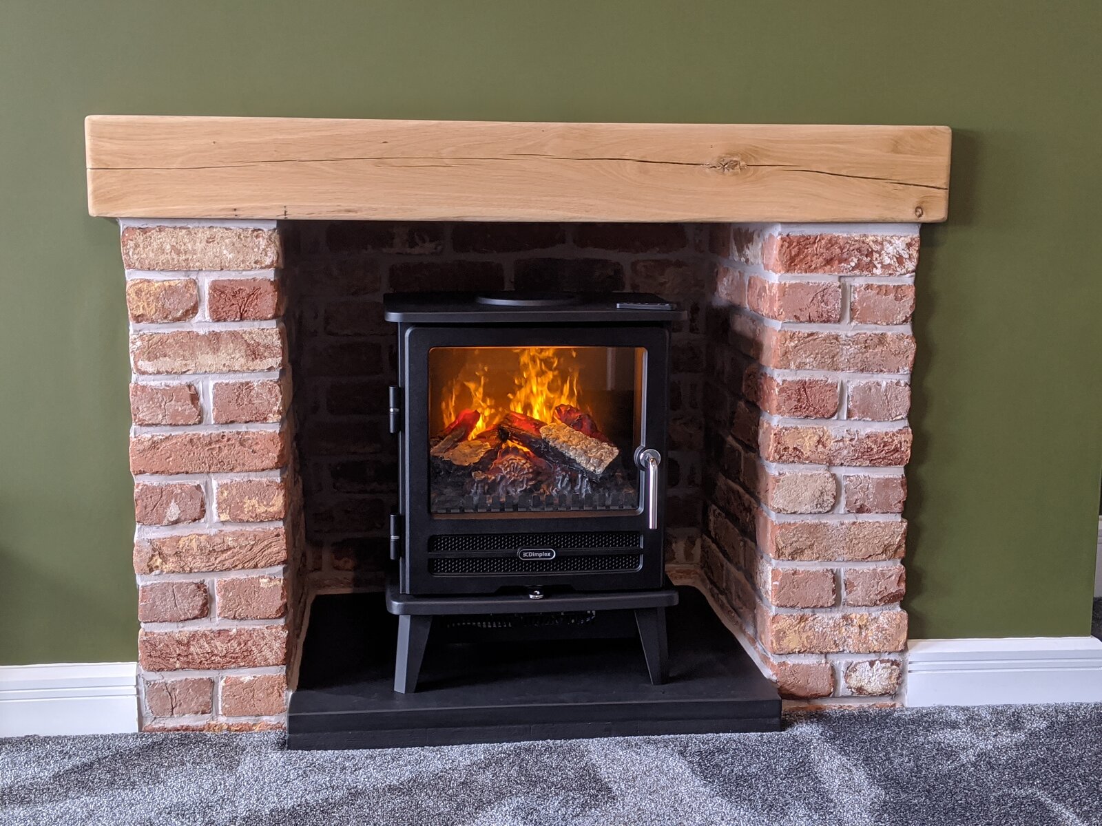

Haha mine doesn't look quite like that.
Not perfect but good enough for a DIYer.
That looks really nice, much better than my attempt.

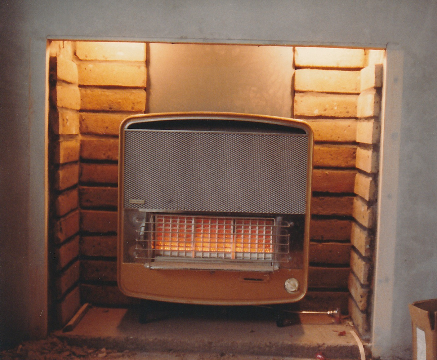

The batten across the top was just for the plasterer and was removed and finished with dark hardwood, a 6x2 fixed under the lintle sticking out 4" and 3x1 down the sides sticking out 2" something like this:
The sides are slips but the bricks at the rear are whole to create a narrow chimney and mortar was a dark grey. Then the dippy 'er indoors decided she wanted brick effect wallpaper on the chimney breast. Base was finished with Dark brown floor tiles with grey specks when the fire was changed.

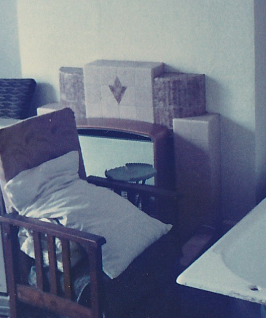

I only started the project because the original tiled surround came away from the wall and the builders rubble cascaded out when I moved this detritus and stood on the hearth:
