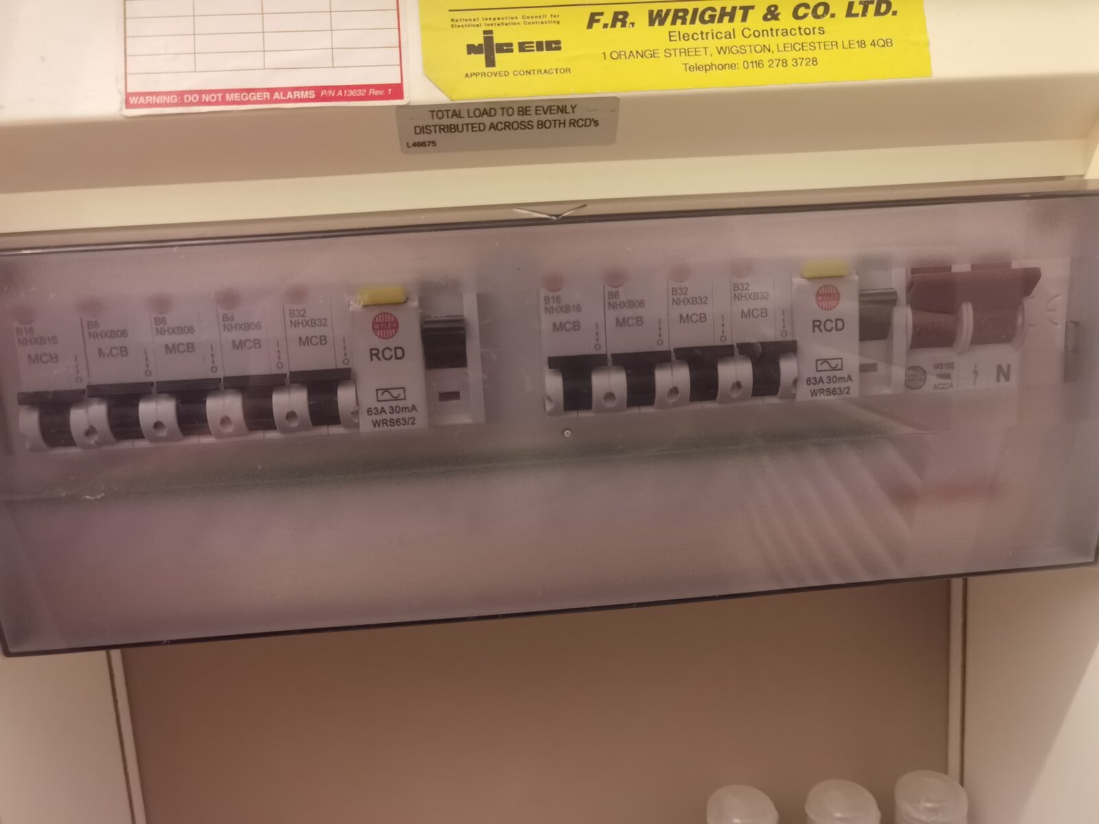

Those are all MCB's, an RCB, or RCBO will have a button marked T or TEST. You need to have one of those, protecting your new socket, or at least use an rcd socket. I would suggest a metal-clad socket, and arranging some form of protection for those cables.
I think I'll just leave it all sounding very complicated
The circuit is RCD protected
