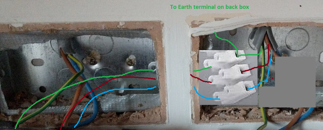

Removing a double socket
Why are you so worried about these sockets?
There was nothing wrong before you started changing things - now you’ve changed something that had a tiny chance of causing any issue into something definitely dangerous.
If you’re going to post asking for advice, then at least follow it and put everything back as it was - or better get an electrician in to sort it out.
I'm listening calm down that's the reason I posted as I was unsure.
I got told to remove the plug near to the hob as it could be dangerous which had me worried,plus I knew what the previous owners handywork was like
What I don't understand is as he's added that plug socket in before surely there wouldn't have been the extra 3 cables going into the new socket
A friend who's Mrs job is building regulations said that a socket should be 300mm away from a sink and hob.
It is a recommendation, not a regulation, to prevent stupid people burning their hands.
You can put her right so she might stop misleading people.
Also none of our neighbours have a socket which has been added in the downstairs toilet above the fusebox??
So? Consider yourself lucky.
And we've also got 1 socket in the build in wardrobe that the previous owner has added himself
So?
Which is piggybacked off a socket in the boiler cupboard ??
So? It has to be connected somewhere.
Using a 30 amp terminal block connect the cables together. Put an Earth lead to the back box Earth terminal. Cover with a plain cover plate.
Also if you are going to listen to Mrs Busybody, then you will have to remove the next socket as well. (300mm). She is causing you a lot of aggravation for someone without a firm grasp of her facts.
I've just noticed my kitchen is the same, cooker switch/socket within 5mm from the edge of the hob. It really isn't a problem.
Glad you have put it back as it was.
