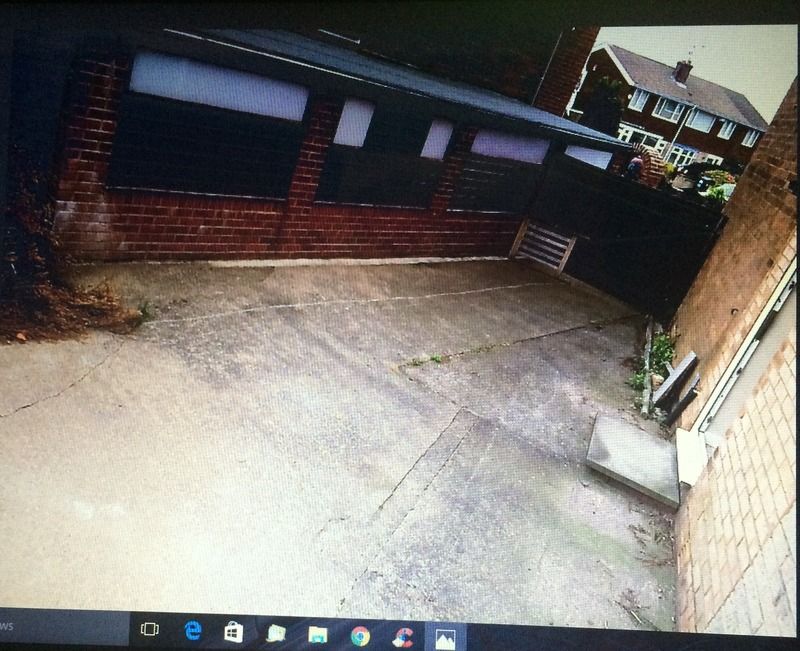

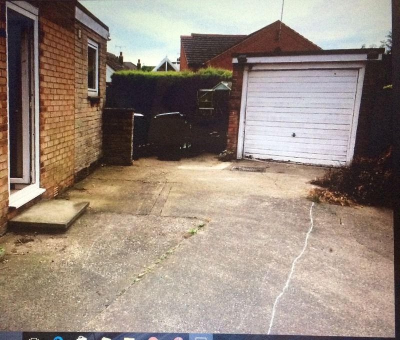

I'm looking to add a single storey extension to my house but I'm not sure if the size would be allowed. We already have a small extension which would be removed and rebuilt with a pitched roof. We looked at 2 storey but it seems overlooking neighbours could be a problem so we are thinking a longer single storey instead. From the pics we would start from the gate, follow the white line roughly and incorporate the garage as part of the house (demolish and rebuild the garage as a bedroom/bathroom). Does this seem like it could be done with planning permission?

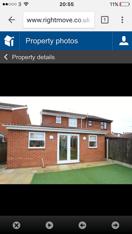

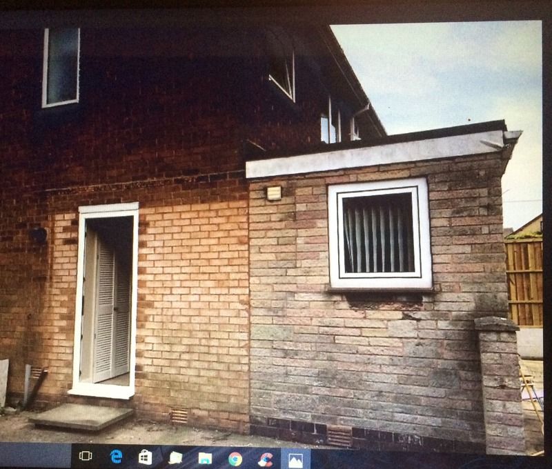

The old extension will be demolished as part of the build but then rebuilt as a sideways T shape I suppose to the original house. A bit like the pic below but the left side would be longer for the bedroom
I don't mind having to go through planning, it's more a question of if something like this is normally allowed at all. Most of the houses on the street have a 2 storey side extension or car port with bedroom above. It would look similar to the neighbours wooden lean to that's in the first picture but with the addition of the garage included as part of the house.
Better quality/un-filtered photos and plans would help. But why not stick in a planning application and see what happens?
If it's a 'wrap-round', it would need planning permission, though you should be OK.
Single storey side and rear extensions are rarely a concern to planners if you did have to apply.

Sorry about the pics, I couldn't get them off the computer to my phone to upload so had to photo the screen. We tried an architect for the 2 storey plan but he has been useless with the council. It was to be changed from single to double storey over the existing extension and a full side build but he couldn't sort out the roof and the angles for the neighbours with light restrictions. Hopefully the new architect will be better.
