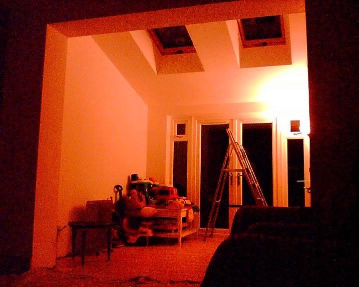

    Rooflights in a trussed roof are like light tunnels and have a habit of becoming a bit of a condensation trap especially in kitchens:
    [​IMG]
