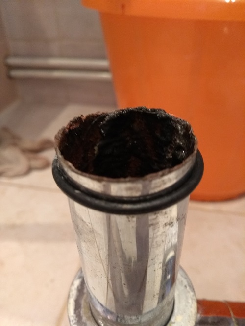

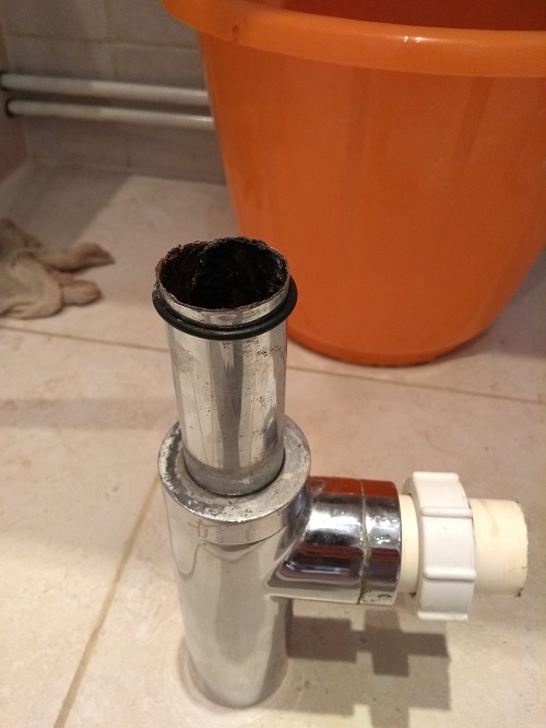

Hi all, this is a bathstore cylindrical tall bottle trap & 400mm extension chr btr0402C

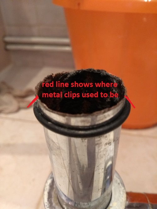

The rubber seal around the neck no longer works because the clips that originally attach to the metal have corroded up. This kit was purchased originally in 2007.
Is there anything I can do to modify this so that it can form a proper seal again?
I would like to avoid having to buy a whole new trap and extension just for the extension.
Any advice on this one ?

Not really, anything that could be attempted would just be a fudge. It looks like the flange on the top of the extension, that the seal is normally sandwiched between it and the waste, has rusted out.
To be honest though, getting 13 years out of a chromed steel trap isn't too bad and as such it doesn't really owe you anything. BTW it does come with a 15year warranty, if it's the same crosswater one ;)
I'd just bite the bullet and put a shiny new trap and extension in.

Unfortunately I think these traps will be made and supplied as a complete unit rather than being able to buy the components separately but you could always check. Take the actual pipe dimensions and go browsing, you never know...

Well I saw a complete bottle trap kit on screwfix and decided to get on with it:
https://www.screwfix.com/p/bottle-trap-chrome-plated-32mm/72487
But the extension is much longer than I need.
Is it supposed to be cut down to smaller size or is this not proper use?
If I do cut this down I'm assuming it will take off the chrome layer at the end and speed up corrosion.. ]
I can't use the existing plastic pipe because it's too big, argh !
