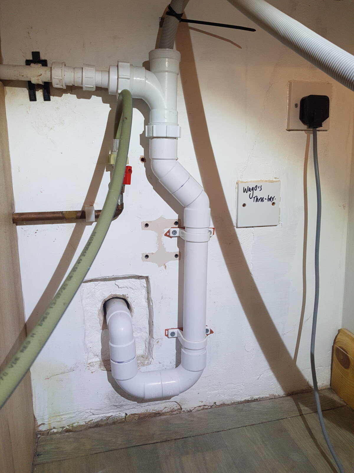

I have a separate waste outlet for a washing machine (sink outlet goes to a Grease Trap, hence its separate), the trap has had recurrence of leaks several times over the last 18 months, i have had it all apart several times, last time replacing all the rubber seals.
The leak is not a huge amount of water, more like drips, but over months its causing some issues with the floor covers, and must be fixed.
The length of pipe where the flexi is inserted is reasonably long, but I guess one comment - is the flexible outlet from the washing machine could go into a 'hose connector' with a jubilee clip to seal it - at the top there, but other than that I'm at my wits end with it.
Have I done anything wrong.
I am considering replacing it all with solvent weld, creating a U bend with it - and adding an access plug, if ever needed, I can't think of anything bad that can come of doing that
You need a longer length of pipe for the drain hose to go into. Leaks could be splash back from that Tee fitting. The supporting brackets need to be holding the pipe rigid to prevent any misalignment. The smaller pipes need to be aligned to prevent any push or pull on the various joints. Get it all aligned without any strain and a couple of wraps of ptfe should sort out any minor drips.

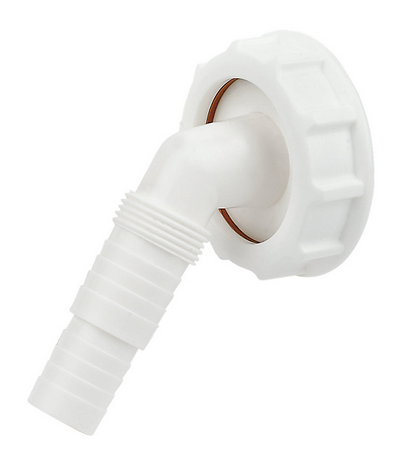

You have a leak because that is a bodge job, you need to install a spigot into the comp tee so that the flexi pipe fits properly
Thanks for your replies, all helpful.
I didn't actually fit this - but hey ho ...
Agree the clipping should have been better to stop any strain on the joints, not sure why I didn't see that.
I did find a small leak at the top of the trap where the pipe is indented to allow a length of 40mm solvent pipe to fit over the top (here a short length goes up into the 'T'), glue had been used but the pipe simply pulled off - I suspect the plastic of the trap was not solvent compatible, in addition the orientation of this join, if failed (as in my case) allowed the waste water to pass through it to the outside of the pipe and drip down - why it was designed this way I've no idea, rubbish, it should have been 1) solvent pipe as the male (pipe from above) and 2) Trap pipe as the female (coming up from below). Not other way round as it was, a Toolstation distributed no name product.
Any way, Solvented the whole lot, no more leaks, I need to fill in around the hole in the wall, that will stop any vertical movement, and strain on joints. I could have added an access point - but its a silly length.
Am cautious about using a 'spigot', if the 40mm pipe gets blocked, the pumped waste water will push its way up through the Condensate Drain into the boiler, which is not what one wants, when you say Spigot, I assume you mean:
Erm...I can kinda see why you did that, if you were at your wits end but the issue you may have now is that formed trap may gunge up and you have no way of cleaning it now without cutting it out, especially if it's a washing machine.

Yep I agree, but unless anyone using the washing machine is going to be a butcher or abatoir employee (ie grease) I can't see that getting blocked, I have 20 year old pipe doing the same job without any blockages.

I still think its worth adding a small length of pipe to the tee where the drain hose goes in. Suitably bracketed of course and it would need a waste pipe compression fitting to fasten to the tee.

Is that to make the overall pipe length longer, the flexi pipe reaches down inside to below where the T joins ...
To make the drain hose enter higher and prevent drain back
