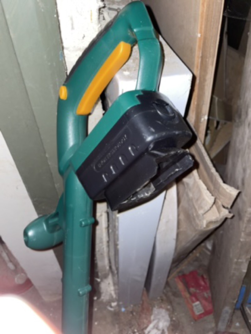

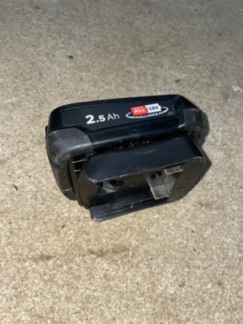

For a couple of cheap tools I have that are 18v, when their batteries went knackered I bought some plastic mounts designed to take my Bosch pro batteries, then hollowed out the failed batteries and soldered the Bosch shaped adapter to the terminals

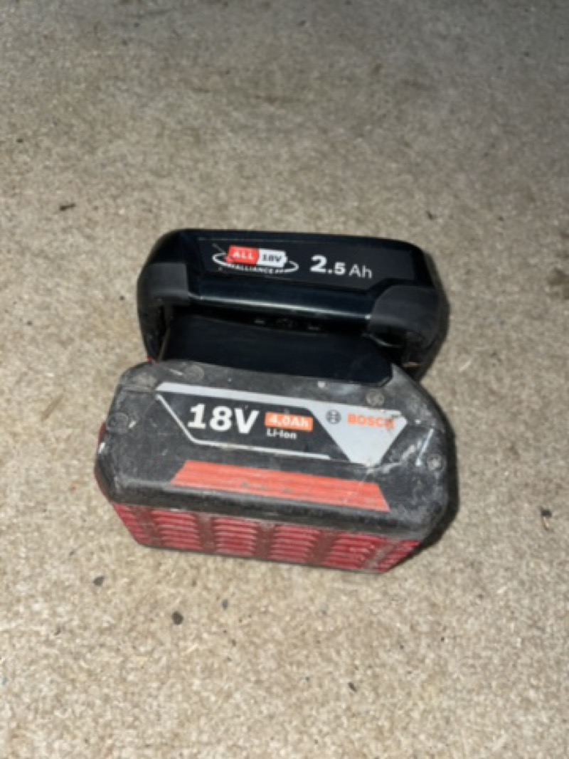

I've also pulled the same trick on a non-pro Bosch tool where the battery is slightly different mounting wise; the Bosch non-pro battery now has a pro receptacle on the bottom and the two batteries work in parallel for a 150% longer run time

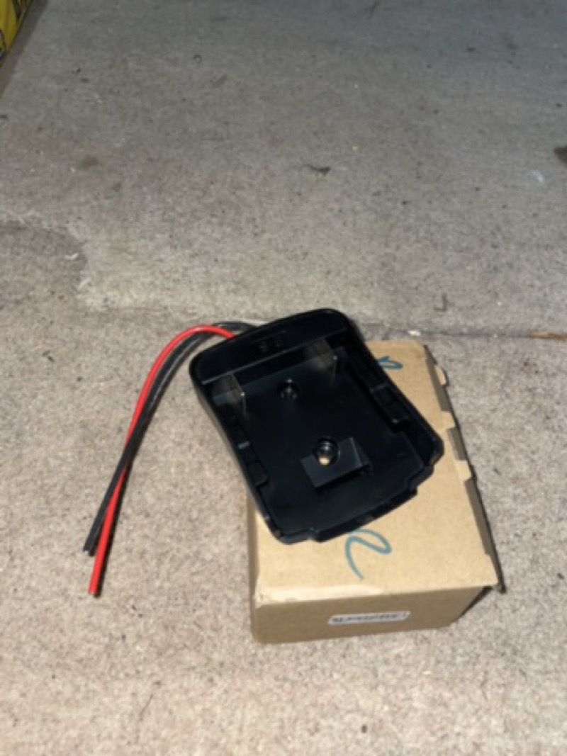

Blank Bosch adaptor, about 8 quid
One mounted on a no-name battery (failed, gutted and innards removed):
Mounted on a working Bosch battery (more capacity; the all4 charger will charge both batts if they're connected):
