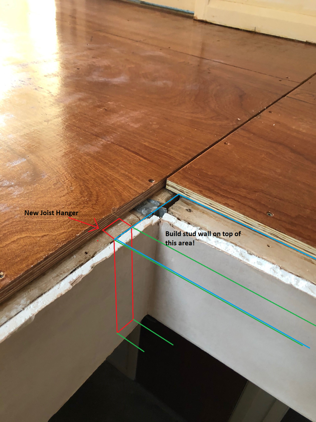

Hi all,
I'm planning on surrounding my landing with a stud wall (replacing what was a banister).
If I were to build straight off the existing outer joist (below where the previous banister sat), I would not meet the 900mm minimum width required for building regs.
The width of that section of floor is currently just over the 900mm requirement (without a banister). Therefore the stud wall would need to be built up off some sort of support that would sit directly next to the existing outer joist.
I'm obviously going to have a professional carry out the work, however I'd just like an idea of what size beam I would require in order to safely carry the load of the stud wall.
The stud wall would be 2.4m high, 2.4m long, it would consist of acoustic plasterboard on each side and would be filled with Rockwool 50mm insulation.

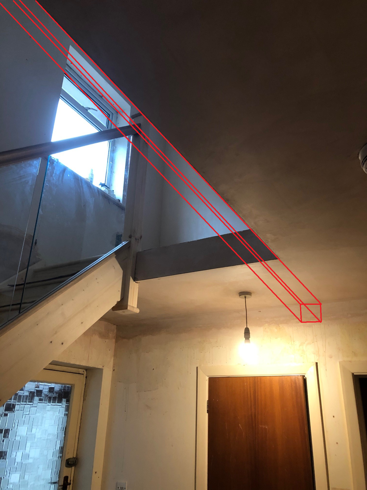

The wall to wall measurement that the beam would have to span is 10.5 meters.
I've done some research and it looks like I'll probably need a 6" x 6" beam, but as I'm not a structural engineer, I figured I'd ask in here in case some of you know how to calculate this stuff.
I've attached a picture showing where the beam would theoretically be positioned.
About 1/4 of the beam's length would sit directly below a ceiling (which as you can see if already fully supported).
Cheers,
Andy

I've just had another idea...
Would it be better to just use a joist hanger and hang an extra joist off one of the landing joists that run perpendicular to the joist that would support the stud wall.
Please see the attached picture to see what I mean :)
