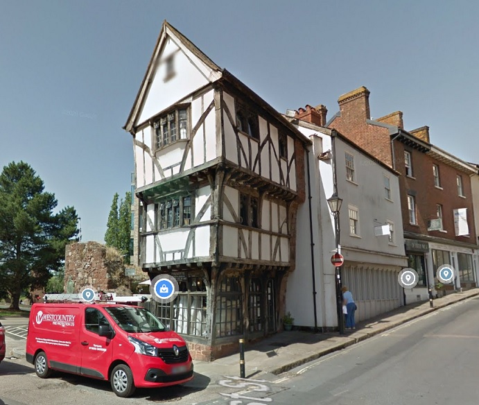

I know of a development of flats that have got brick but is "wooden framed"
I know of a development of flats which are not cheap but they've got brick on the outside but I was told they are "wooden framed" and I didn't realize we allowed timber framed buildings in the UK, they look as if they are built from bricks but they aren't apparently. I prefer traditional build for houses I think
What the pros haven't explained yet, is this. In a brick/block build (often called traditional), the walls are the structural, load bearing elements. They hold up the weight of the walls and roof; and bear the stresses placed on the structure by wind, snow buildup etc.
In the timber frame build, the structural strength and stress management is all on the wooden box inside (where the inner skin might be in a trad house). Outside, the wooden box is clad with anything you want. Timber planking, stone, exterior fibre boarding and render, block and render or nice bricks.
You have to officially love one and hate the other:D. It's an actual rule. no really.

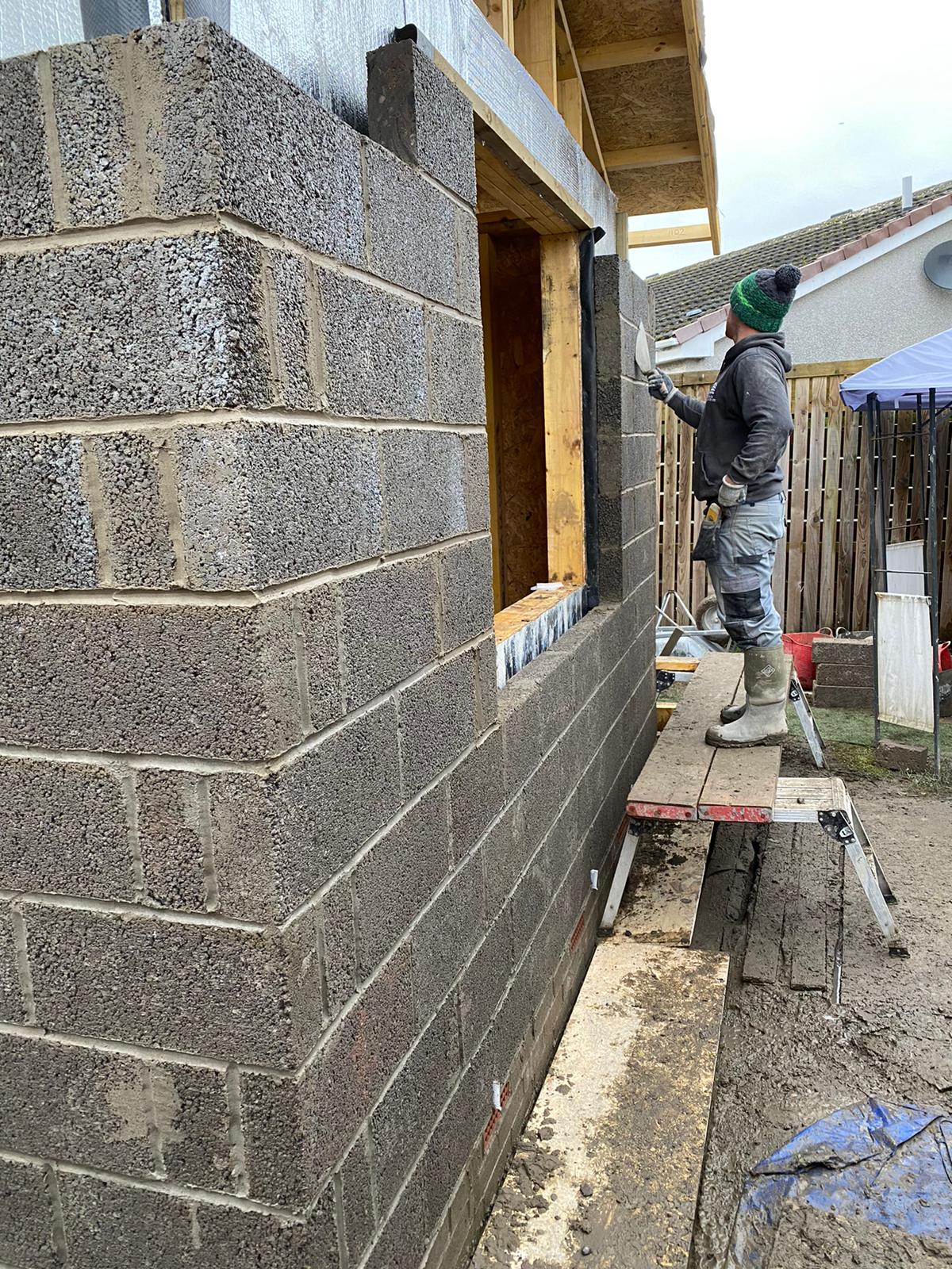

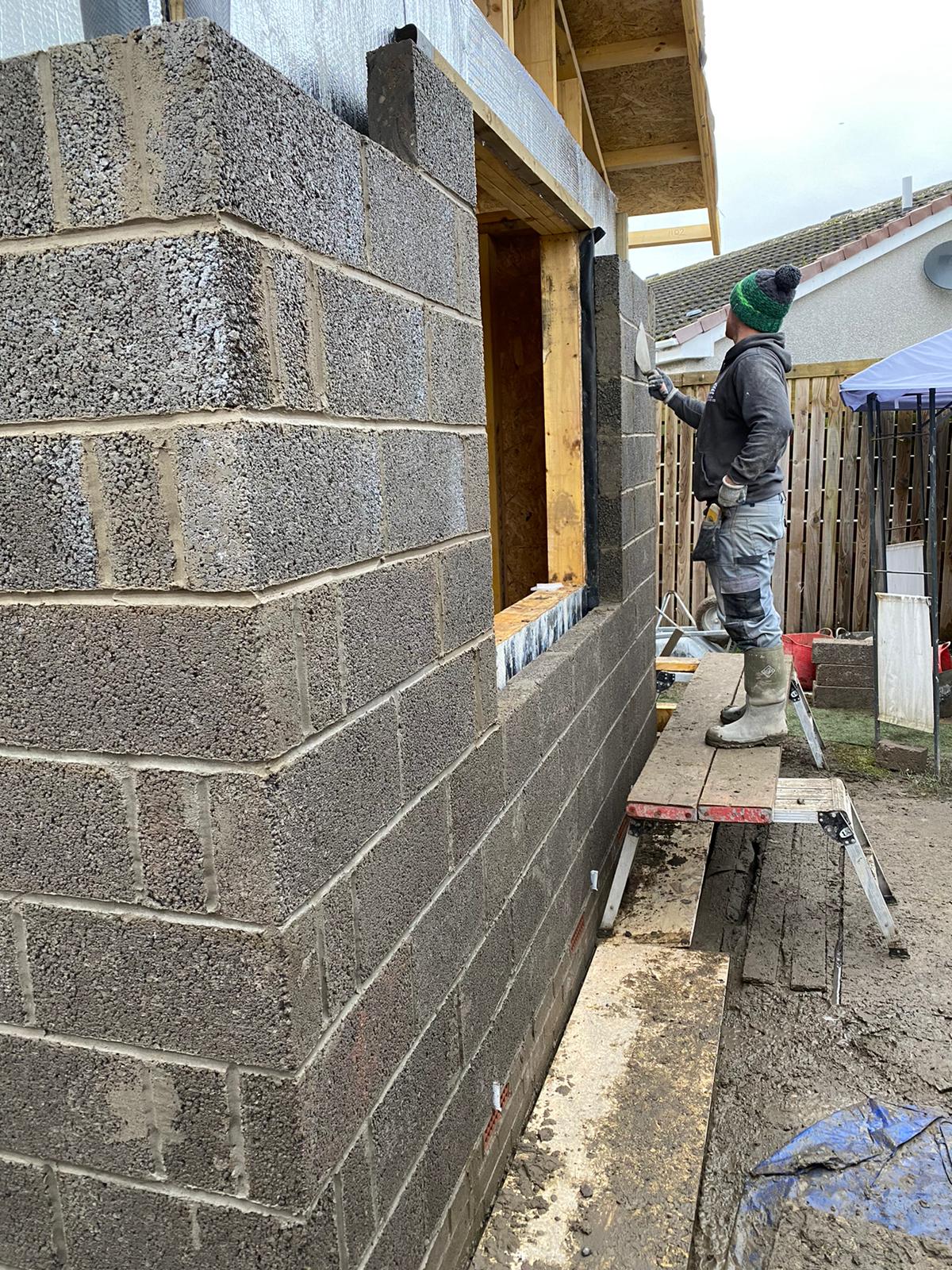

A wooden frame building being built today in the UK :eek::eek::eek:
It's becoming more and more common to build timber framed buildings in the UK. Elsewhere in the world (USA, Canada, Australia), it's by far the most common construction type for low rise buildings. To the uneducated eye it's often nearly impossible to tell the difference between a timber framed building and a traditional masonry one.
It's common for timber framed buildings to have an external skin of brick or rendered block, although not essential. If a rendered finish is required it is possible to do away with the masonry completely and render onto renderboard fixed to battens. The timber elements in residential buildings are rarely on display due to the obvious fire risk of exposed timber.
Timber frame is becoming more and more common on medium-rise buildings in this country too. I've done the structural design on a six storey block of student accommodation, but the world record is 18 (eighteen!) storeys in Norway.
https://www.theexplorer.no/stories/...tdiWo0mt23fEyS0m6sQ29kGvlDgEANORoCslQQAvD_BwE
One of the main issues with timber frame (and an area that can sometimes be overlooked by inexperienced tradesmen) is the fact that timber shrinks. I've recently had to survey two four storey blocks of flats where there were a whole host of problems evident around opening and soffits, due to insufficient shrinkage gaps being left. Considering the usual allowance is around 10mm per storey, this would lead to a required allowance of 180mm on an 18 storey building. I can only imagine there must be ways of reducing the amount of shrinkage on buildings of this size else it would be a real headache around openings.
