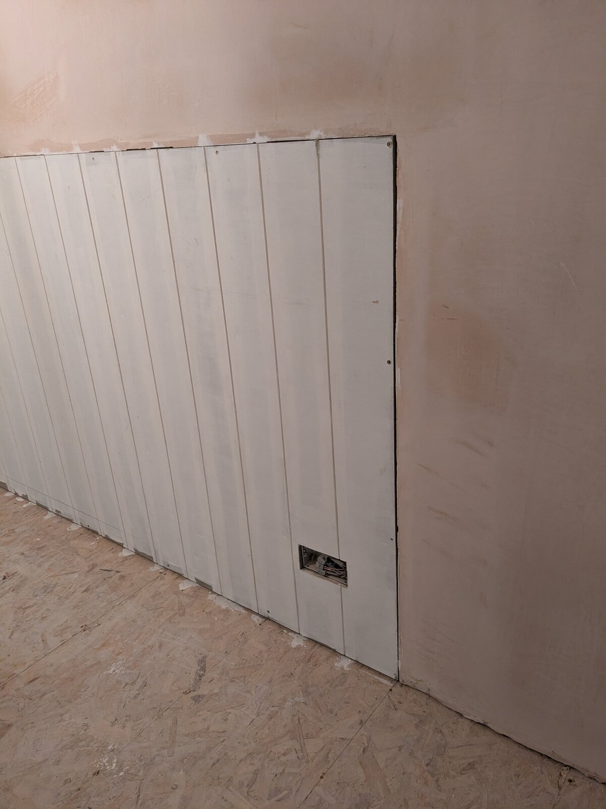

I thought I was being pretty clever here... I routed a sheet of mdf and fixed to a stud wall to act as a built in head board.... Plasterboarded rest of wall, skimmed, then..... Stood there looking at it scratching my head.. Not so clever..... Needs architrave/trim to cover the mdf/plasterboard join, but how to do the join between that and the skirting??
Thanks for any input!
Ops, photo attached....

It would just abut it, you would need to choose an architrave the same or narrower than your skirting.
