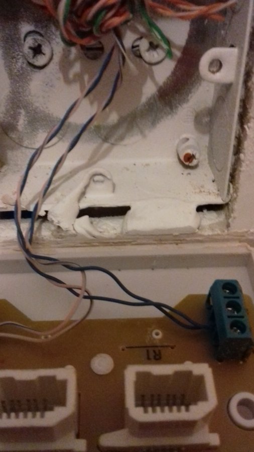

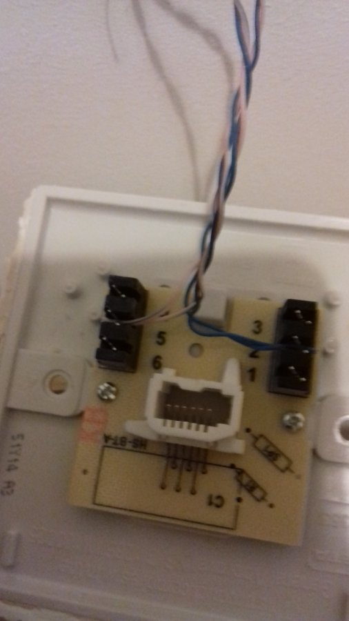

My daughter had the sky engineer out to install a phone and he has put a new socket in. He said he can't use the originals as they have been wired up wrong. The socket he installed is in the "airing Cupboard" as he didn't want to damage the walls. The flat is only about 6 months old. He said if we plug a phone into any of the original sockets they could blow, is this possible. How easy would it be to sort this out myself.

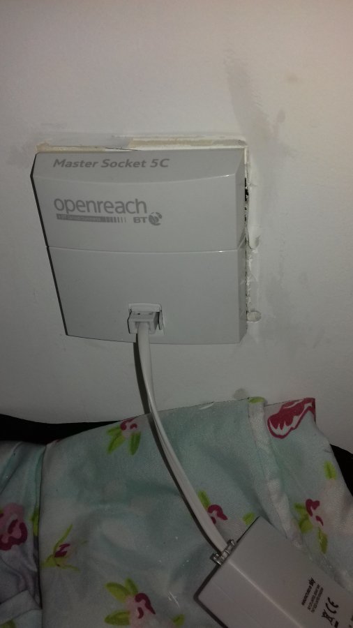

The existing sockets are still, he just put a new one in the airing cupboard. My daughter said he waved a wand or something and that is where the cable was easiest to get to. Plaster board in there and easy to cut and pull the cable through.
Was this actually a sky engineer or a OpenReach/BT one? If you can get some more info on what he actually did and some pictures that would help. I'm pretty sure a sky engineer wouldn't (or shouldn't) be fitting a master socket as this is BT's property and should only be done by them or authorised contractors.

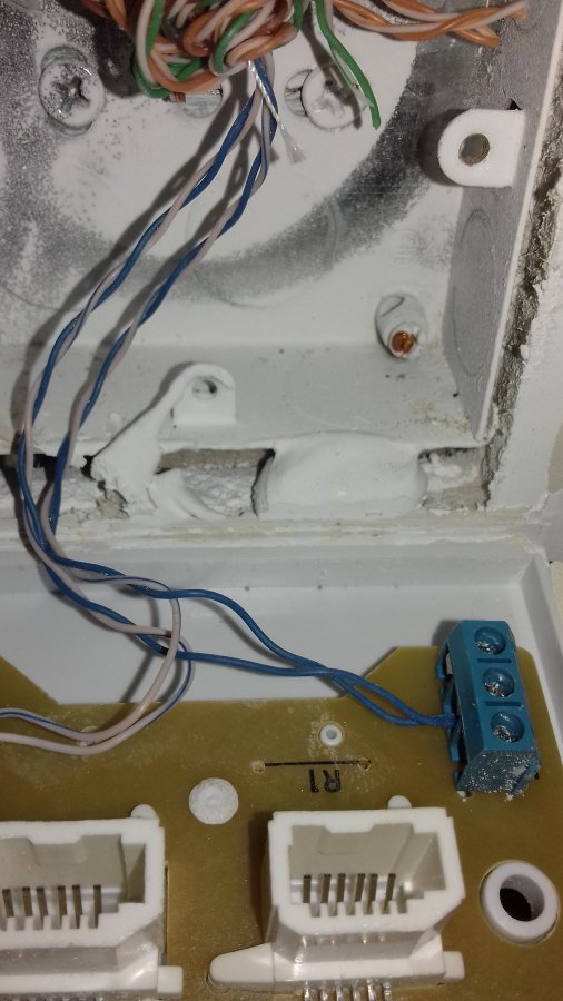

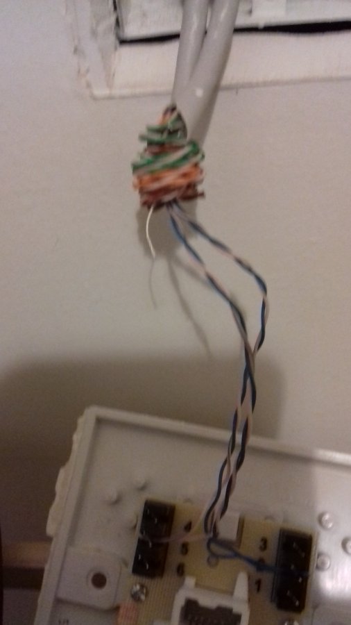

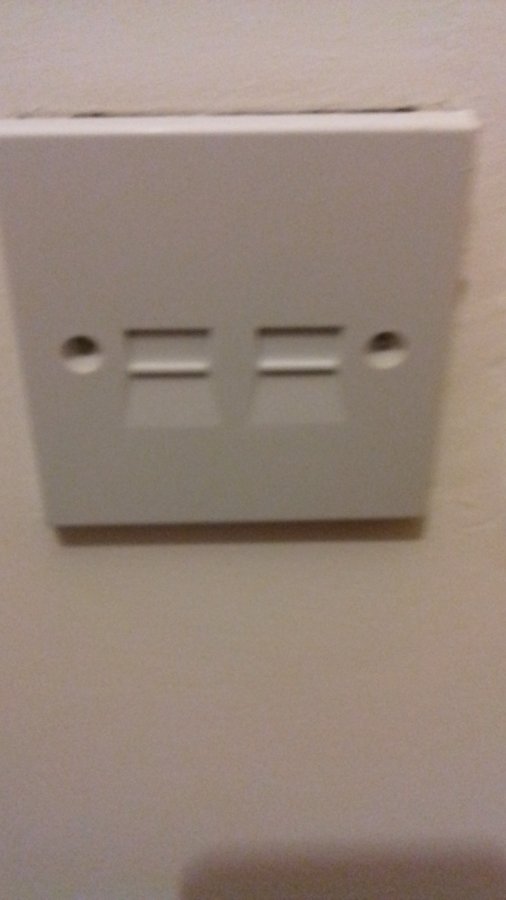

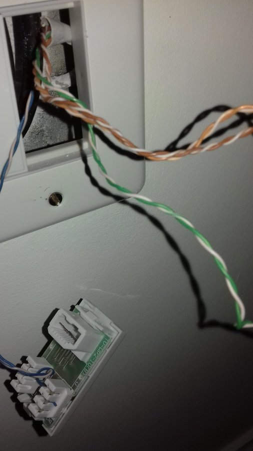

My daughter is the first to occupy the flat, new build finished just after Xmas. This is the first phone that has been connected. I have attached some photos, the master is the one installed by the Sky engineer/technician, the others were already in the flat. The service cupboard is located in the community passage way.

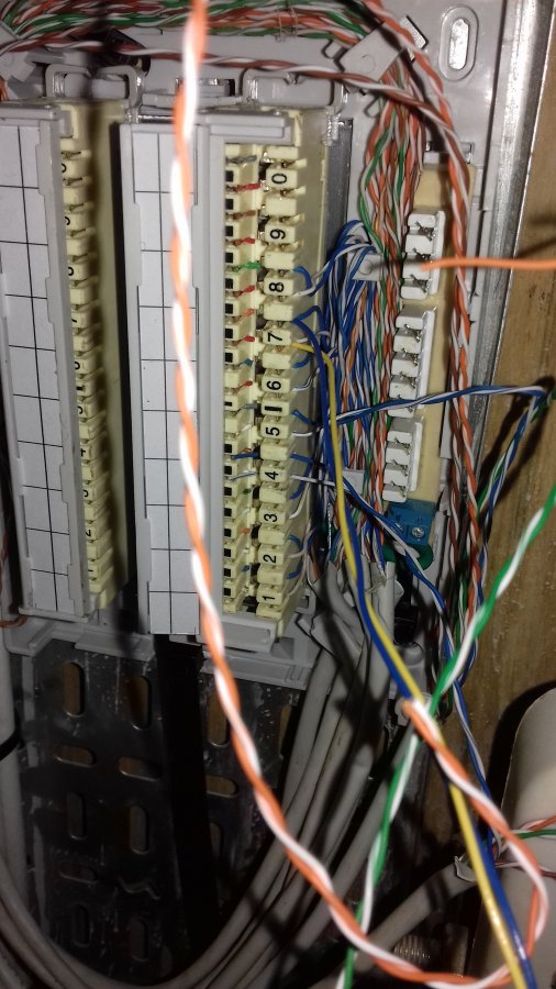

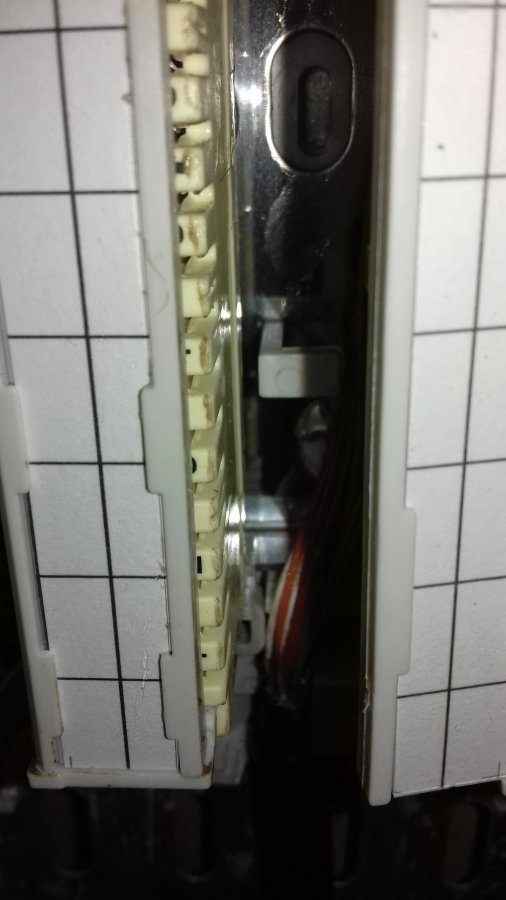

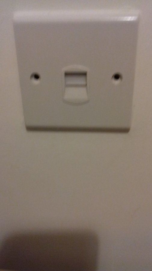

rest of photos. It would be nice to get at least the socket in the front room working. It's no good having a router and phone in the airing cupboard. I assume the service cupboard is where the outside line comes?. The flat is number 6 if that corresponds to the wiring in there.

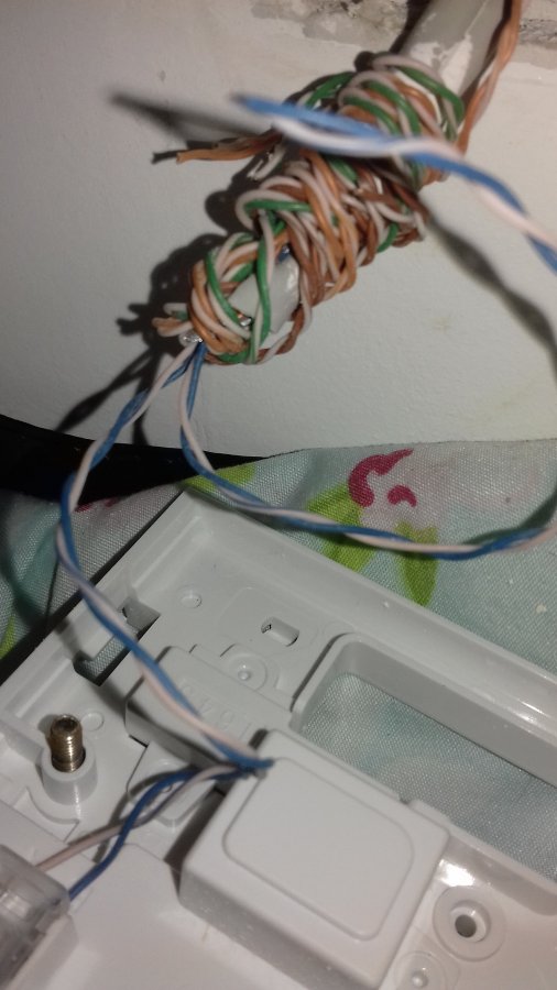

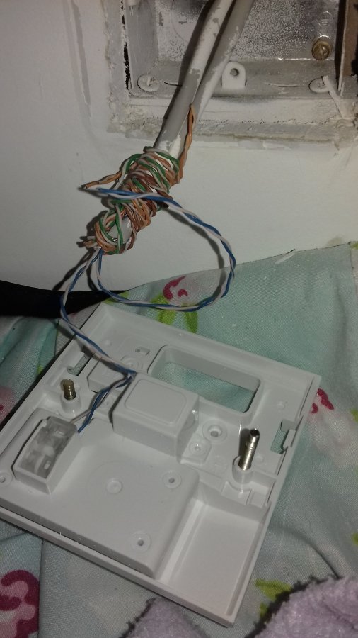

Do i have to connect terminal 3 from the master to terminal 3 on the other sockets. Looking on this site i have to http://www.wppltd.demon.co.uk/WPP/Wiring/UK_telephone/uk_telephone.html. Also the other twisted spare blue and white wires in the airing cupboard master, do i connect them as well to link the other sockets

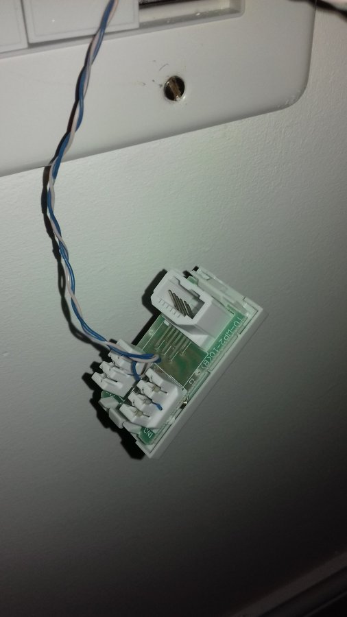

Is the front room the last socket, as that only has one pair of wires connected
The 3rd terminal is generally not used by modern phones, although you can connect it.
The blue and white wires should connect to the removable lower part of the front faceplate, not the same terminals the installer used.
