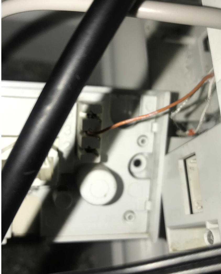

Here is how the Master socket is currently wired. There is one cable in #3 of the detachable plate:

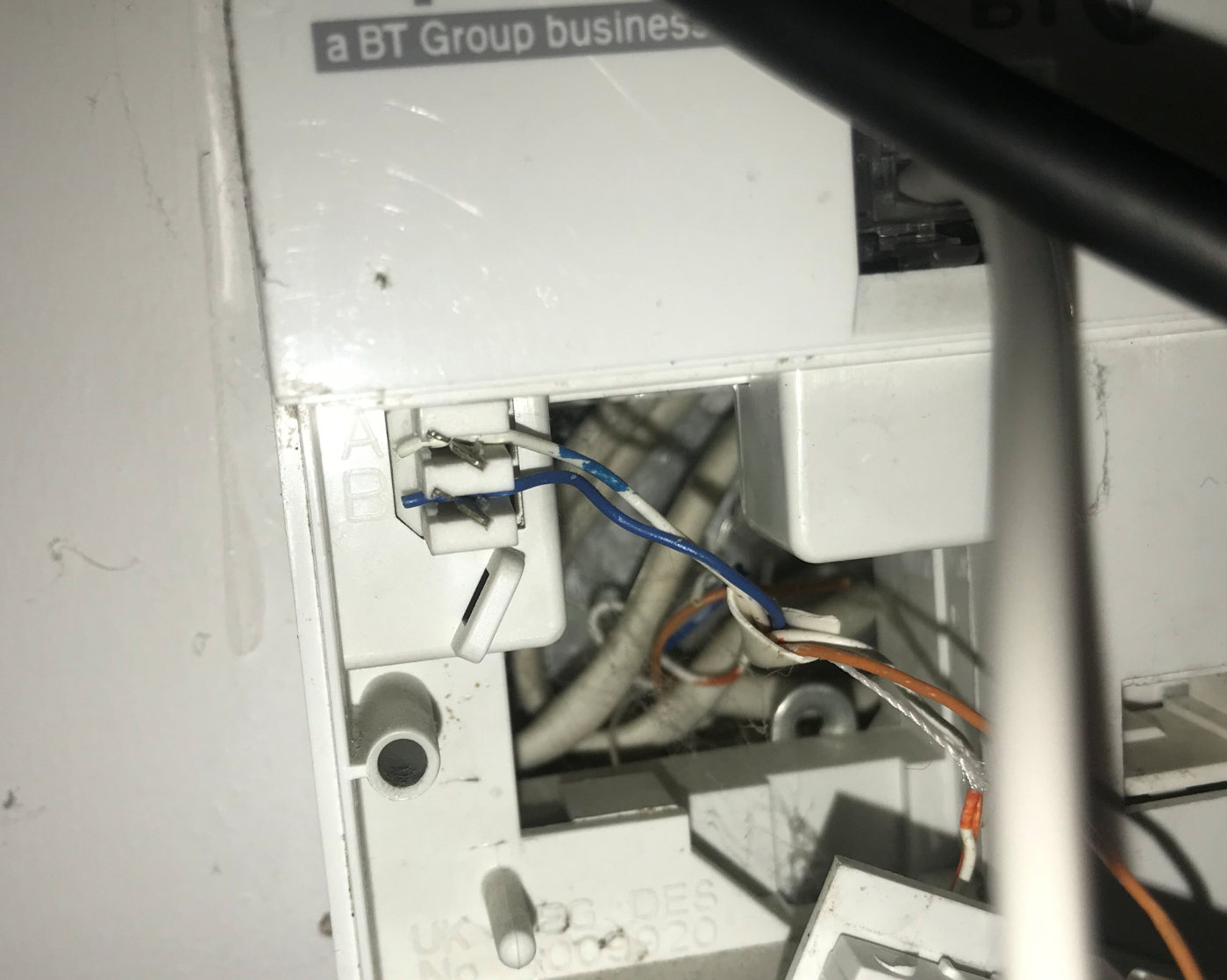

and a further two cables in A and B terminals:

Pull the orange wire(not cable :p) out of the IDC slot and leave it out. I doubt this will help much, but at least it will be correct.

The orange wire has been removed from terminal 3 and to my surprise, the landline still rings. I could have sworn that this cable was put in because the phone wasn't ringing when I did this over a year ago...

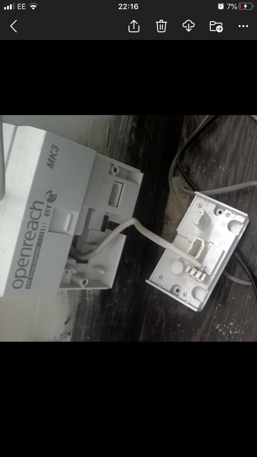

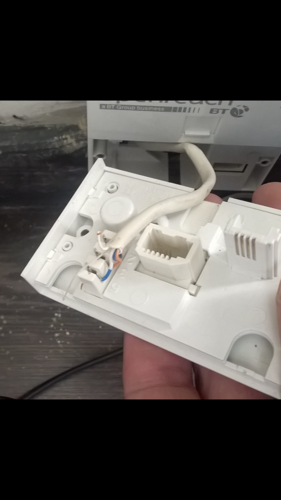

At the master socket your pictures above show 2 cables in the IDC pair labeled A+B. but it looks like there are more than 2 cables behind the socket. Remove the master socket from the back box and check to see where the incoming Dropwire/UG feed connects. Also let us know where the 2 cables in IDC A+B go to.
