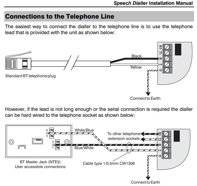

Some telephone diallers will not work if the polarity of the telephone line is reversed

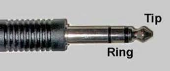

T ( Tip ) should be Positive and R ( Ring ) should be Negative ( reminder tiP Positive and riNg Negative )
This "Ring" is not the ringing of the bell but the ring on the plug that used to be used
The third contact is called the Sleeve
aha...
Since nothing else has changed on my setup, would it be easiest to swap the R and T wires?
Bit of an update that I wanted to share with you. I went to make this wire switch and thought it would be wise to test the dialler prior to making any changes. The test completed successfully. It managed to call my phone..
Yet, a couple of days ago, I returned to a false alarm and hadn't received any calls. Nor had any of my designated contacts. I am inclined to create a alarm activation tomorrow and see how the dialler responds.
Puzzled.
When I was testing this yesterday, I did notice a log on the speech dialler. Would that shed any light on this situation?

At the time we found a dialler that appeared to have the functionality we needed. It was claimed that incoming calls would not prevent the dialler making calls albeit a bit later than planned. This dialler answered incoming calls ( A resistor between A wire and B wire ) but did not release the line until the caller hung up. If the caller did not hang up then the dialler could not make the ( urgent ) call.
If you did a test call from the dialler, was it by firing the output or bell that is the trigger or directly from the dialler?
wrt to the phone line, there is more than one way to wire it and i am sure it advises that one way the calls are routed via the dialler, so that if the dialler dials out it cuts off the call to give the dial out priority.
Not used this dialler in a very long time so would have to refer to the manuals (engineers/ installation manual) i believe covers it.
it will cut off an outgoing call and after a pause re-seize the line ( picks up the phone ) and make the alarm call.
An incoming call will be disconnected from the phones in the house but it then relies on the caller to hang up and terminate the call. If the caller does not hang up the line will be held busy by the caller until the telephone exchange frees the line. This used to be a delay of about 20 minutes but in recent years this time out has been reduced to about a minute or less.
have to admit last time I used was to change the numbers stored in it about 3 years ago and installed the last one of them about 3 to 5 years before that
I previously tested the dialler using the menu option on the speech dialler keypad. I have since tested this by creating an alarm activation situation. This also activated the dialler and I received the call. Puzzled as to what may have happened that day. An incoming call preventing this seems plausible.
Does an incoming call even when not answered prevent the dialler from calling out? I can appreciate that this will be the case of the call as been answered by a human or an answerphone.
