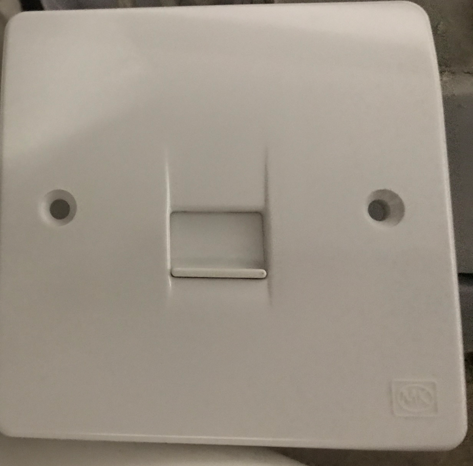

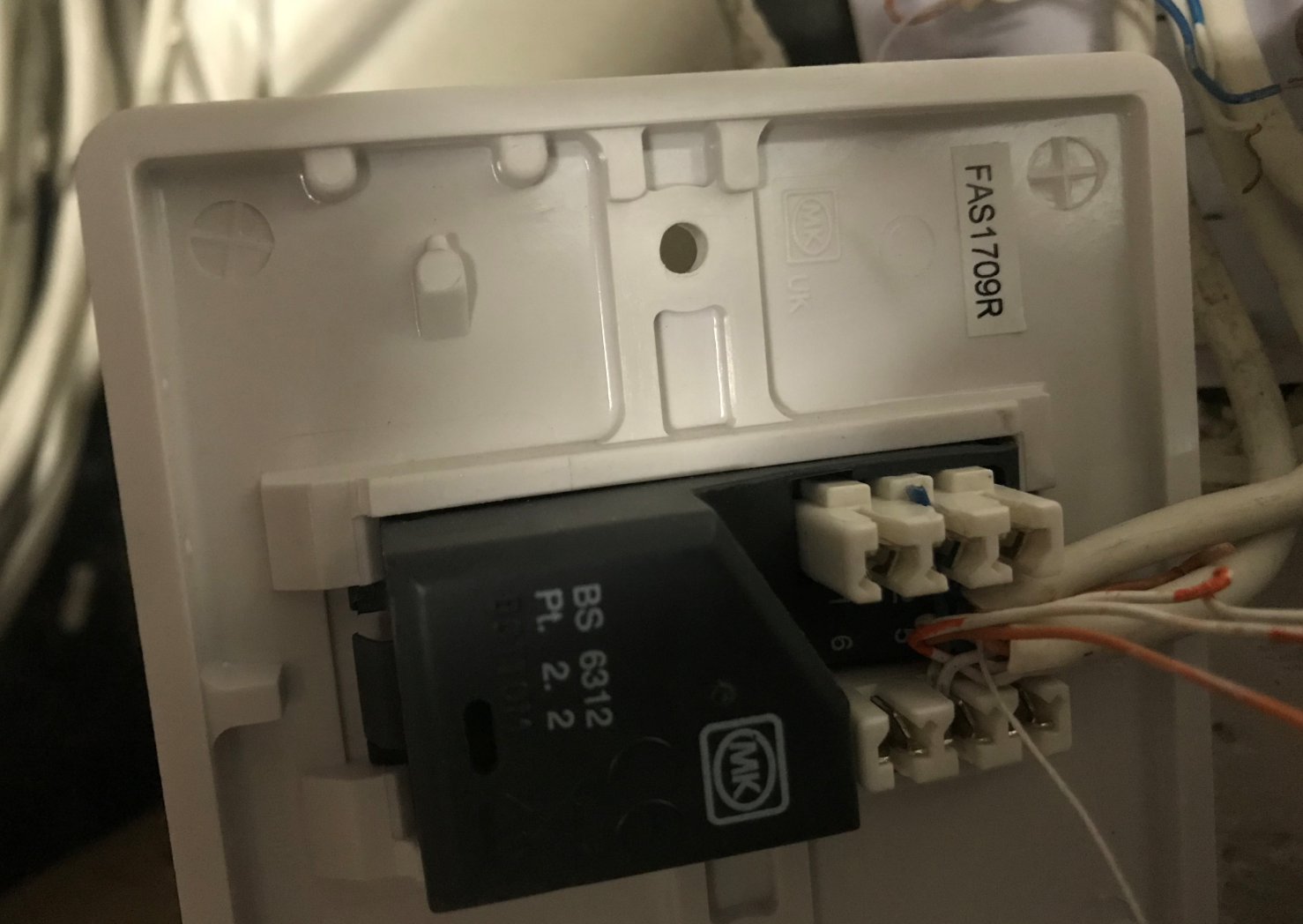

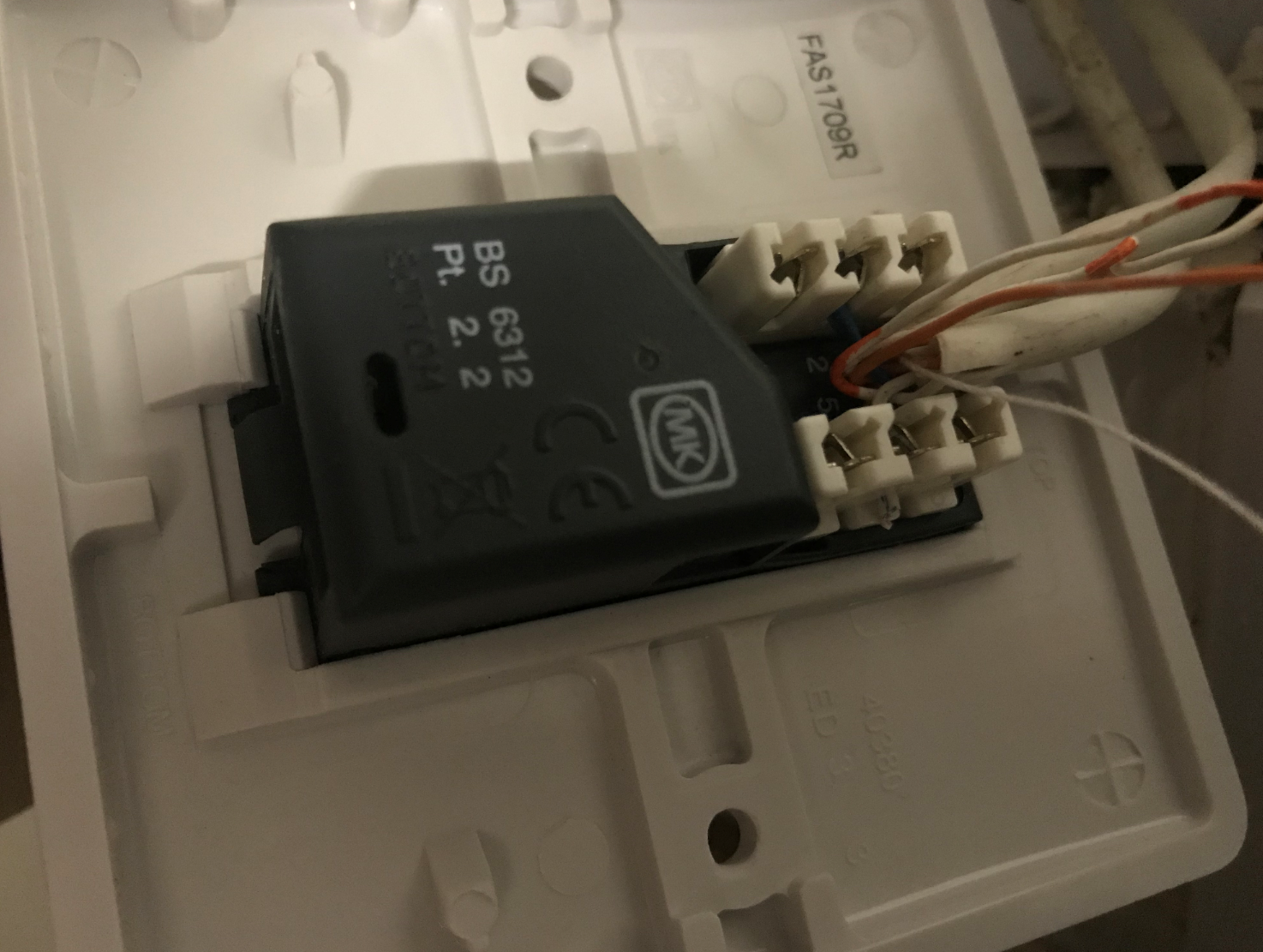

I was getting speeds of 30-33 MB with A&B wires disconnected. When I connect these back in, it drops to 11-13 MB. I have reduced the length of wire outside the sleeve and punched them down again at both ends. Here's a picture of the garage socket:
Not sure how well you can see in this picture but the blue and blue & white wires are connected. The orange was also connected and I have now disconnected. I am sure the orange will be connected into all other downstream slave sockets too. Not sure if this is having an impact on speed too?

As long as the pair 'colours' are connected to the same IDC connector in every socket - No.
