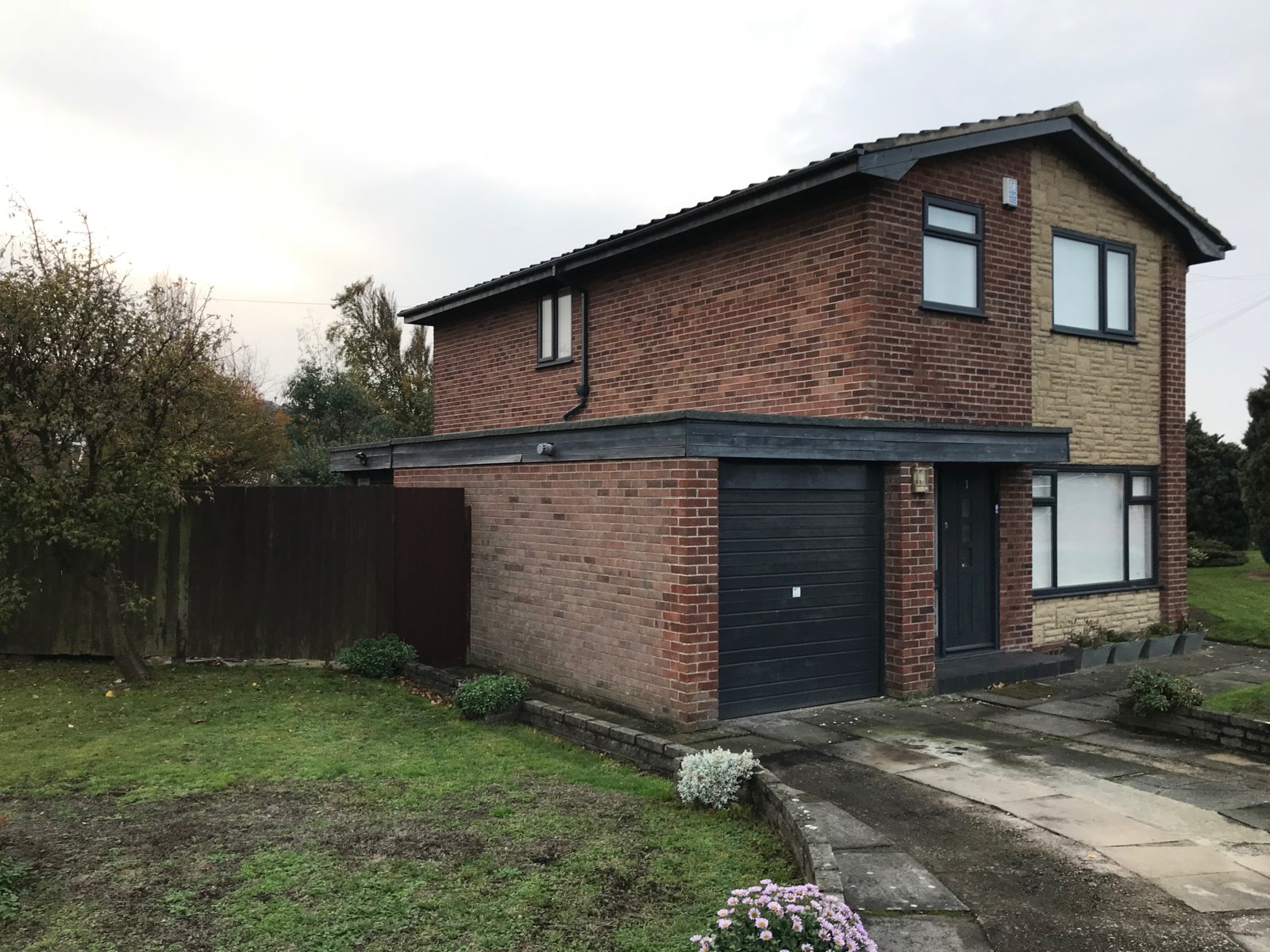

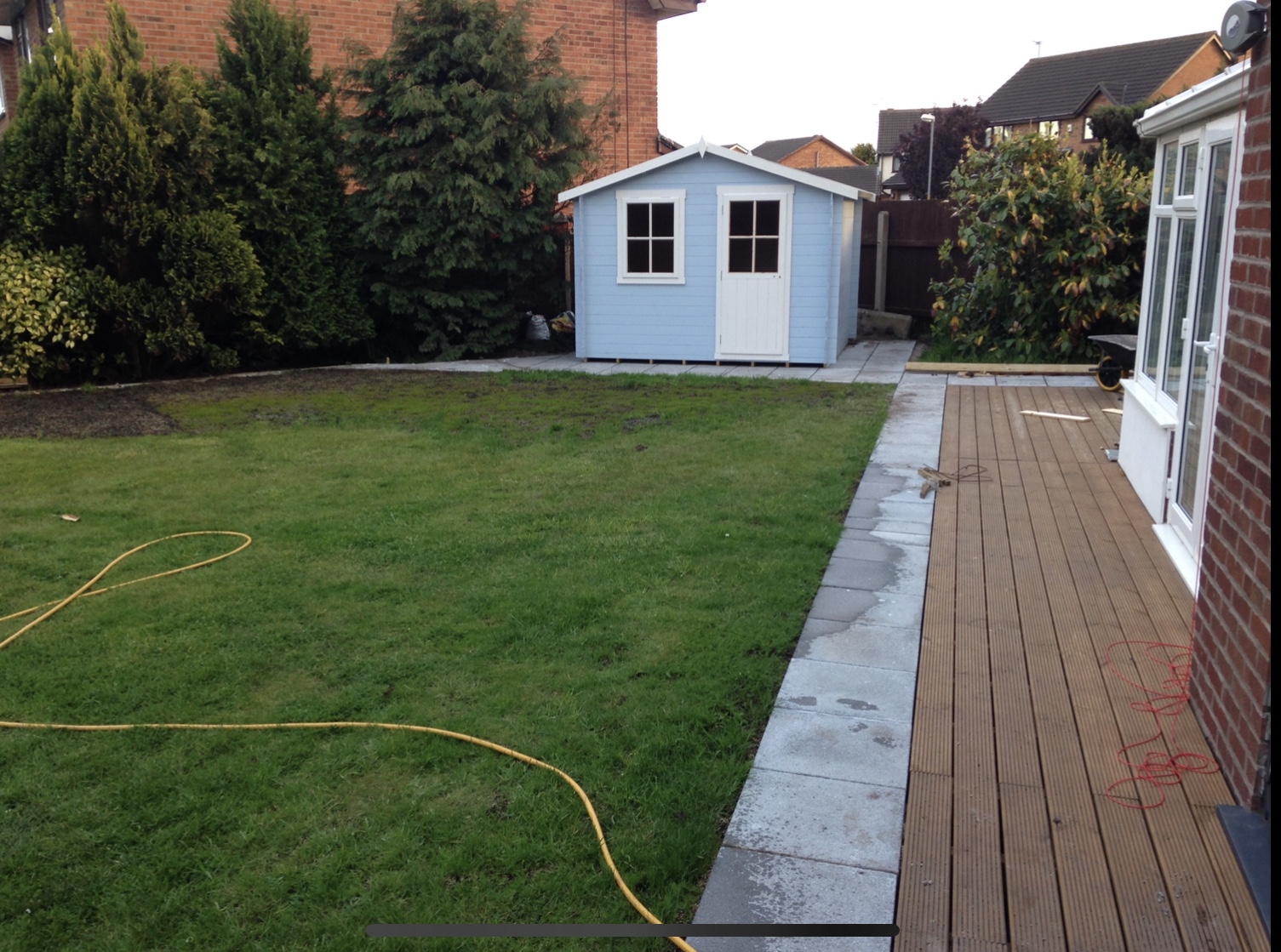

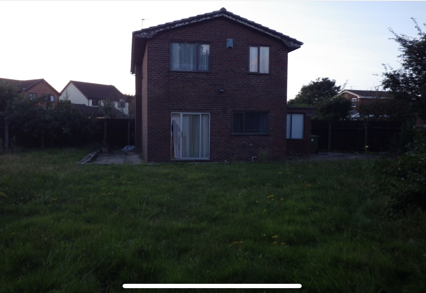

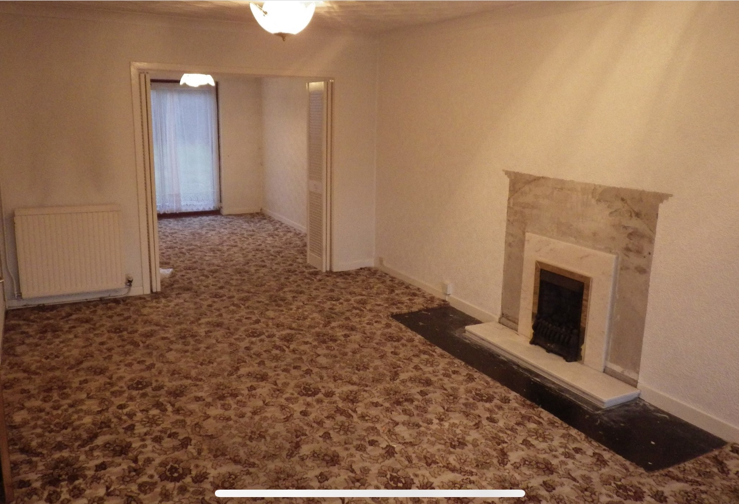

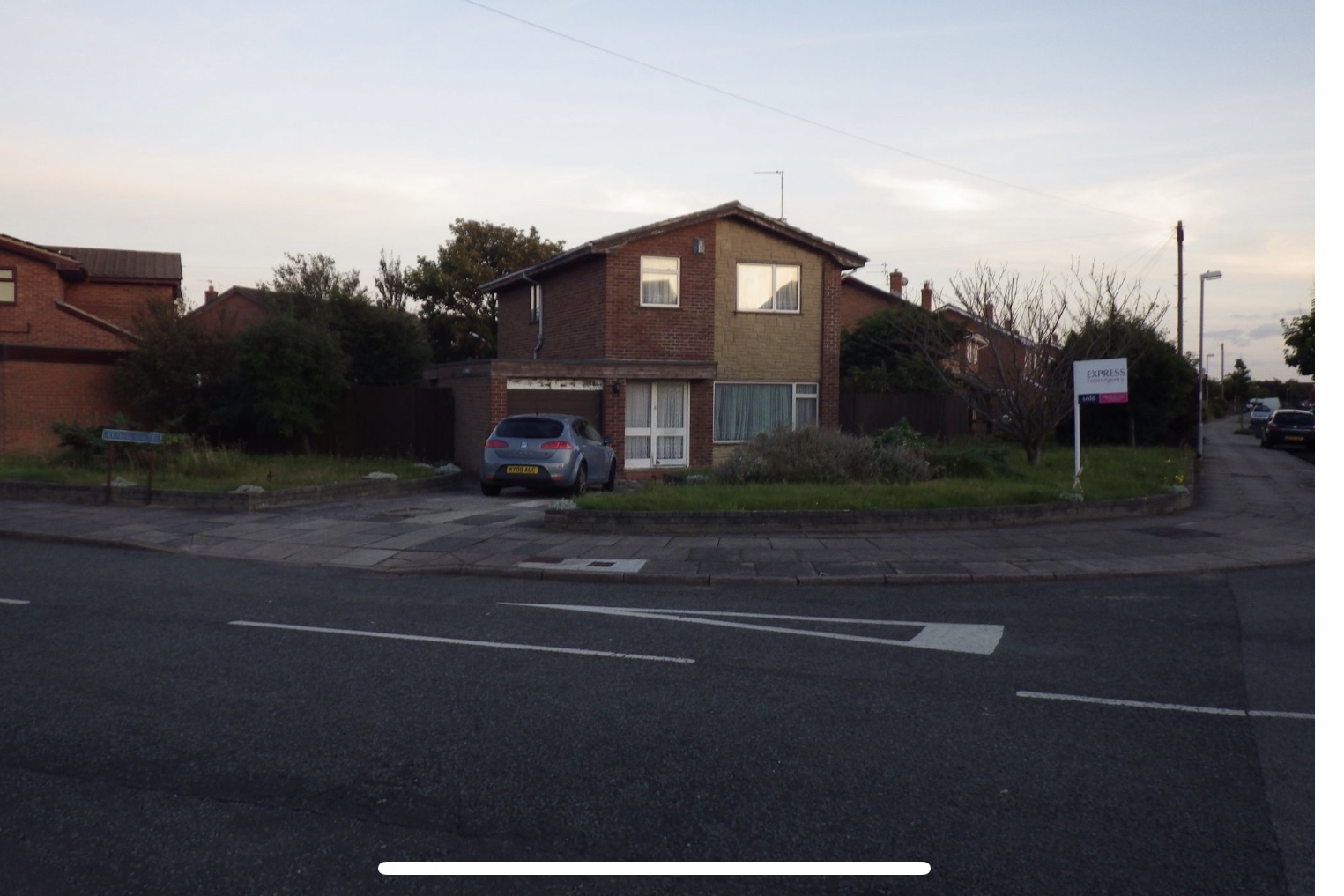

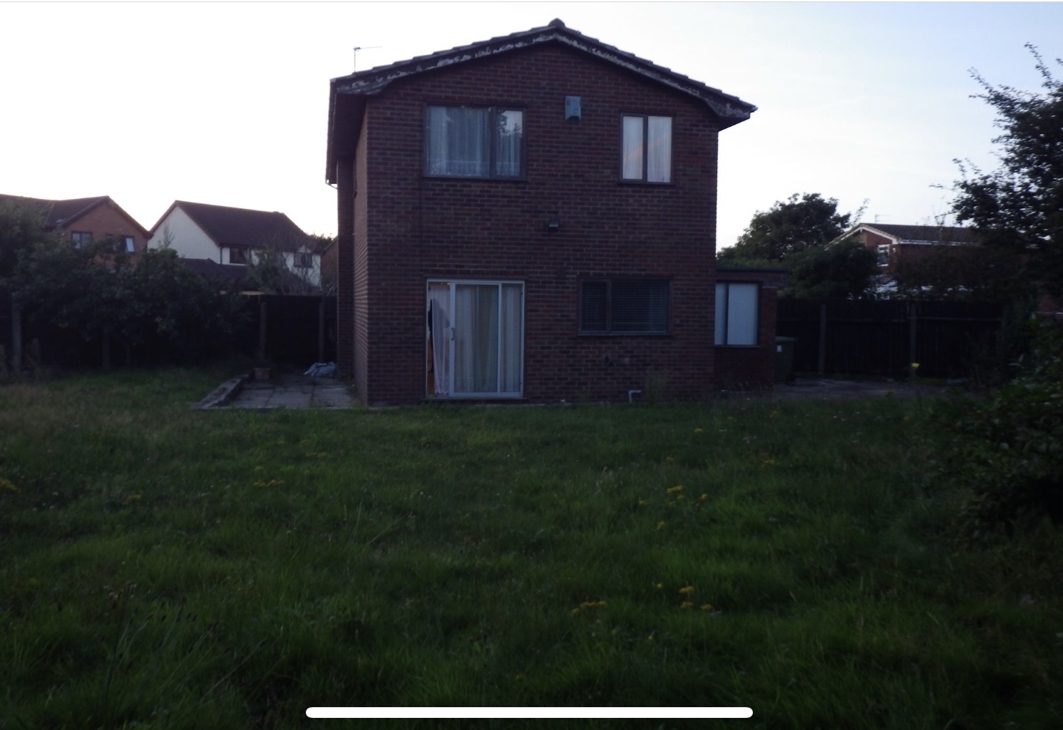

We bought our place in late 2012 as a very ugly 1979 detached property which needed a total refurb. The area was nice and the house has a fair bit of land with it (relatively for the area) and we thought it had potential. All the garden both left and right in the first photo is ours.

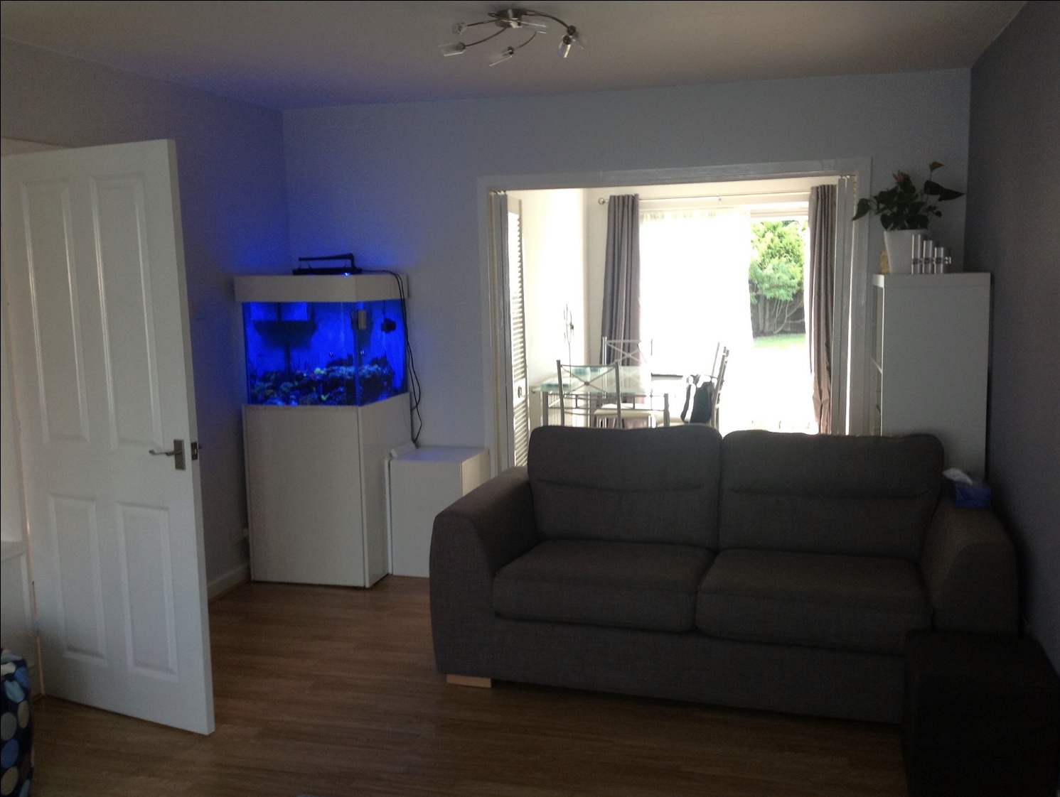

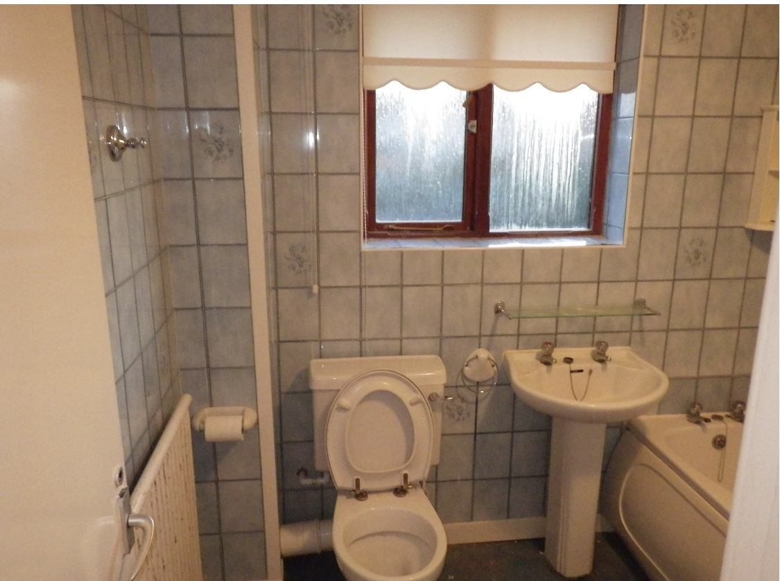

Fast forward 9 months and the inside was pretty much renovated (including 3 months of living upstairs!). Turned out ok inside but the refurb left the old kitchen, boiler, etc in situ as we had decided at this point we wanted to extend the house on the left hand side (when looking from the front), which would ultimately relocate the kitchen.
We then had to get the house remortgaged so we were looking at ways to add value to get the LTV down, so I bought a second hand K2 conservatory from eBay for £1.7k. Probability a bit steep for a used conney, but glass roof and steel floor and steel walls (with brick slips) made it a doddle to install...and I also made my first door opening ever as the French doors were into the house were into what was previously an exterior wall. Total cost of the install of the conservatory was £2.5k in the end. And then another £1.5k for the new shed and decking for the garden...

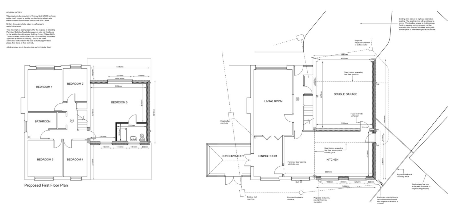

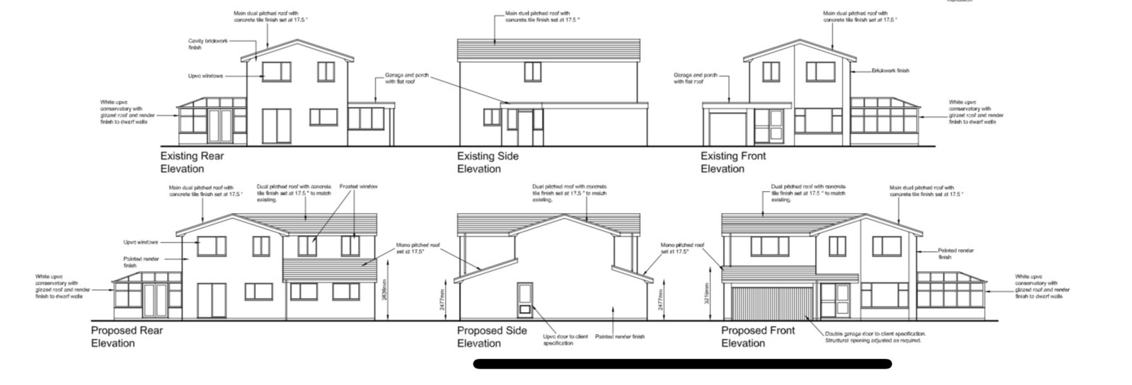

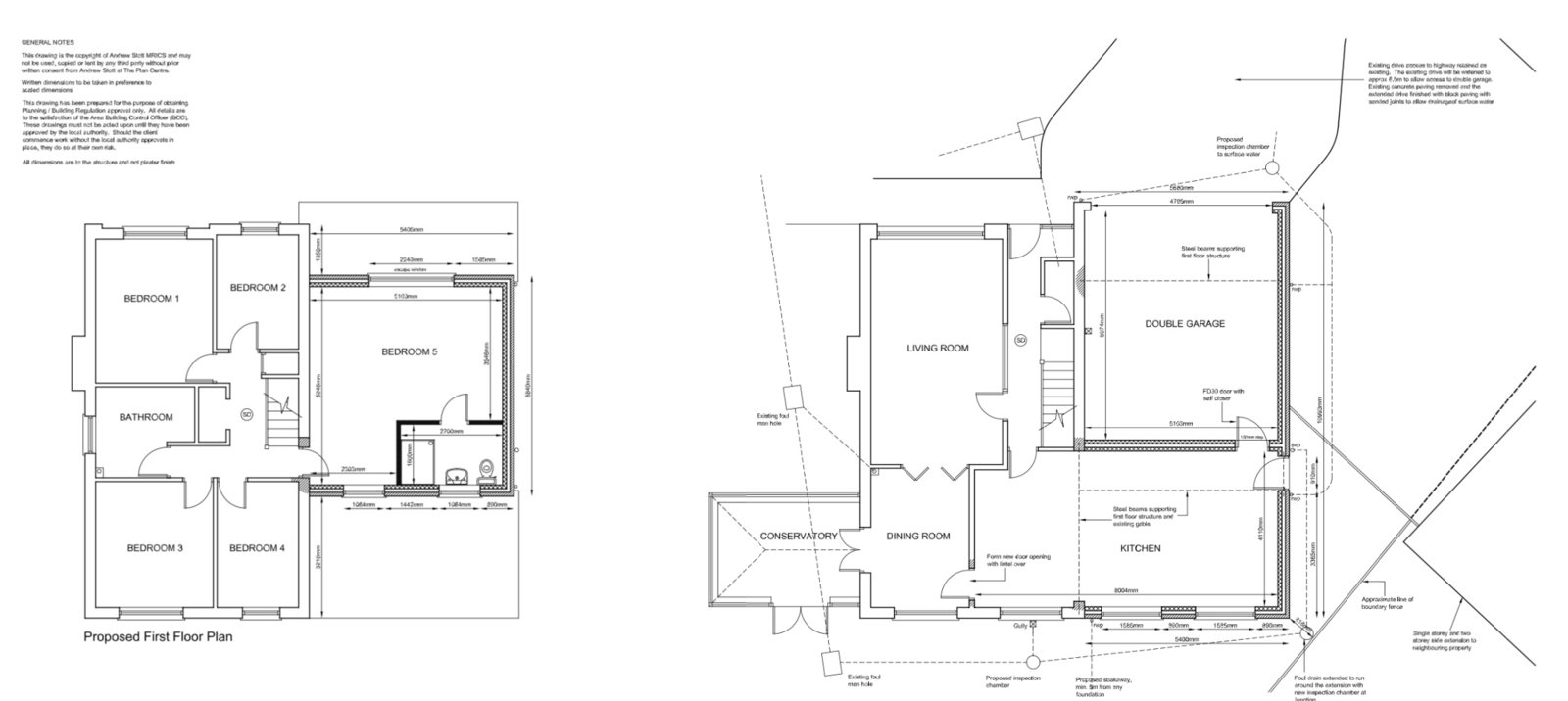

2014 we got our plans drawn up for the extension. We wanted an extra bedroom as there was no true master (biggest current bedroom 3.5 x 4m). Most houses on the estate have a double garage whole we had a single, so we wanted to have that extra storage space. We also wanted a bigger kitchen/diner.
Originally the idea was a straight up double storey extension, but as soon as our designer can round that idea was canned as the house has a really low roof, so joining the extension roof at 90 degrees mean that the width of the 2nd floor room were limited somewhat because of the roof line and maintaining a suitable angle for a pitched roof.
Eventually we ended up with these plans, which give us what we wanted.
We also wanted to change the look of the property, with the now popular look of white render, grey windows and some wood cladding to hide the ugly stonework.
The planning application went in during 2015 as we weren’t in a mega rush (more of this later), and was approved in December 2015.

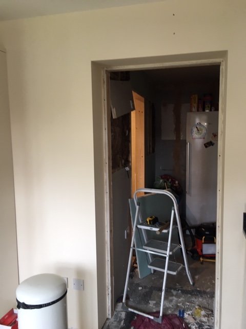

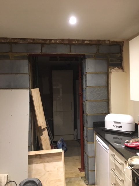

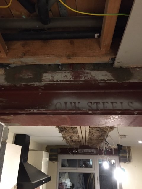

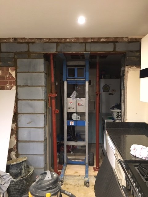

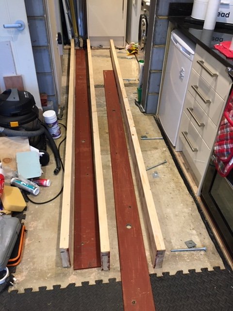

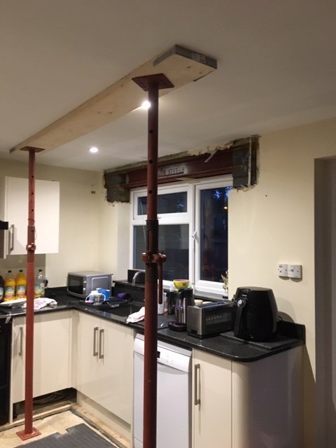

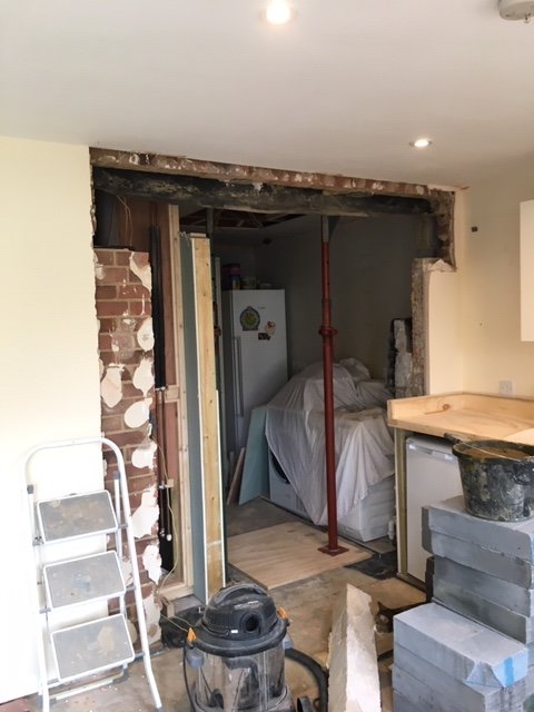

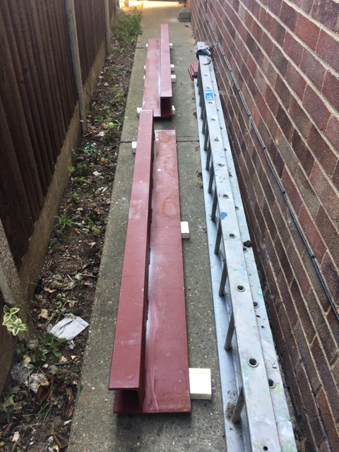

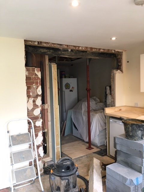

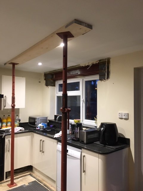

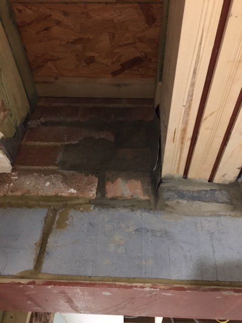

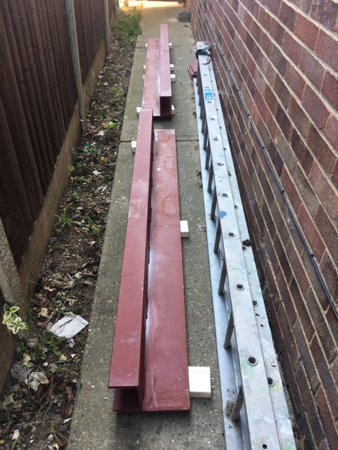

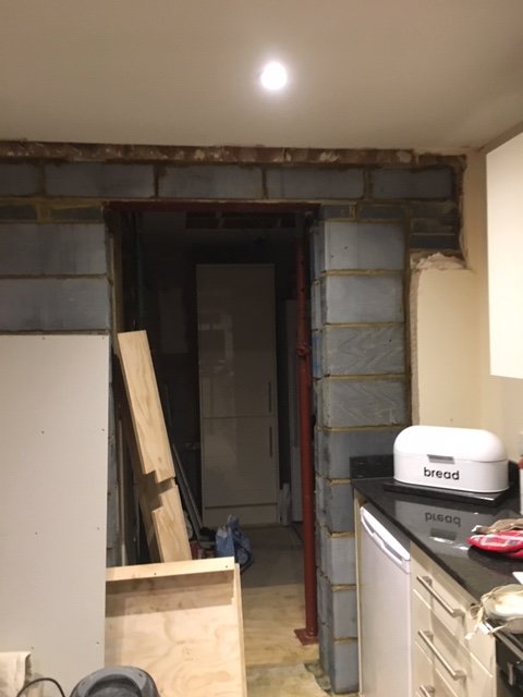

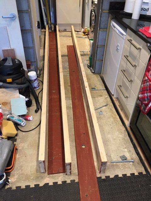

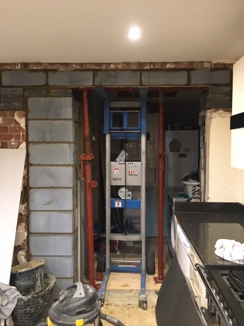

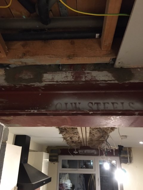

I'm down in Southend, Essex and started my first floor extension on top of the first one I built in 2000 ish. Had to put 2 steels in last November to support the upstairs bit. Had planning issues but got all of that sorted now as had to take it to appeal and was lucky to win.... This has been slow going as well....taken more time than I would of liked it to.

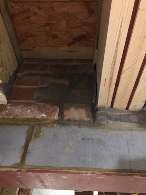

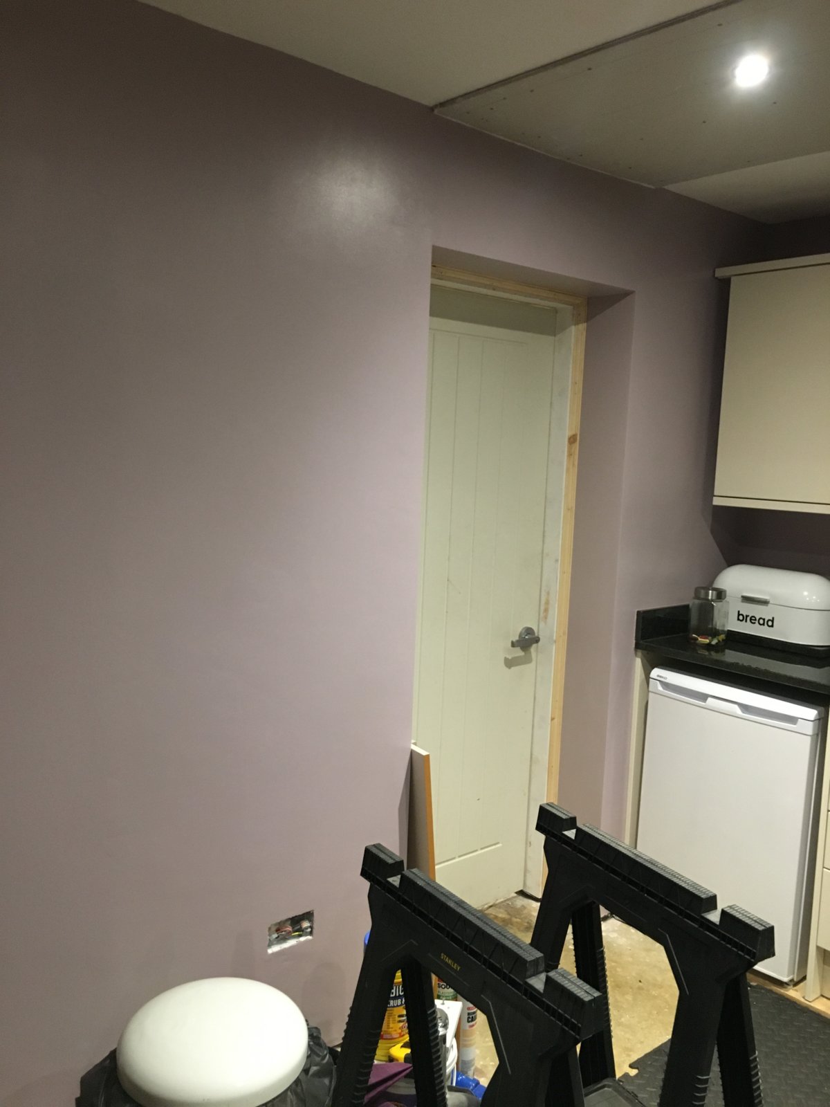

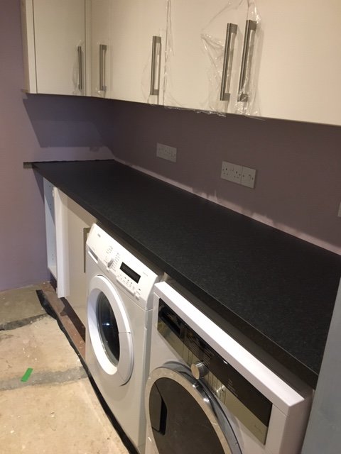

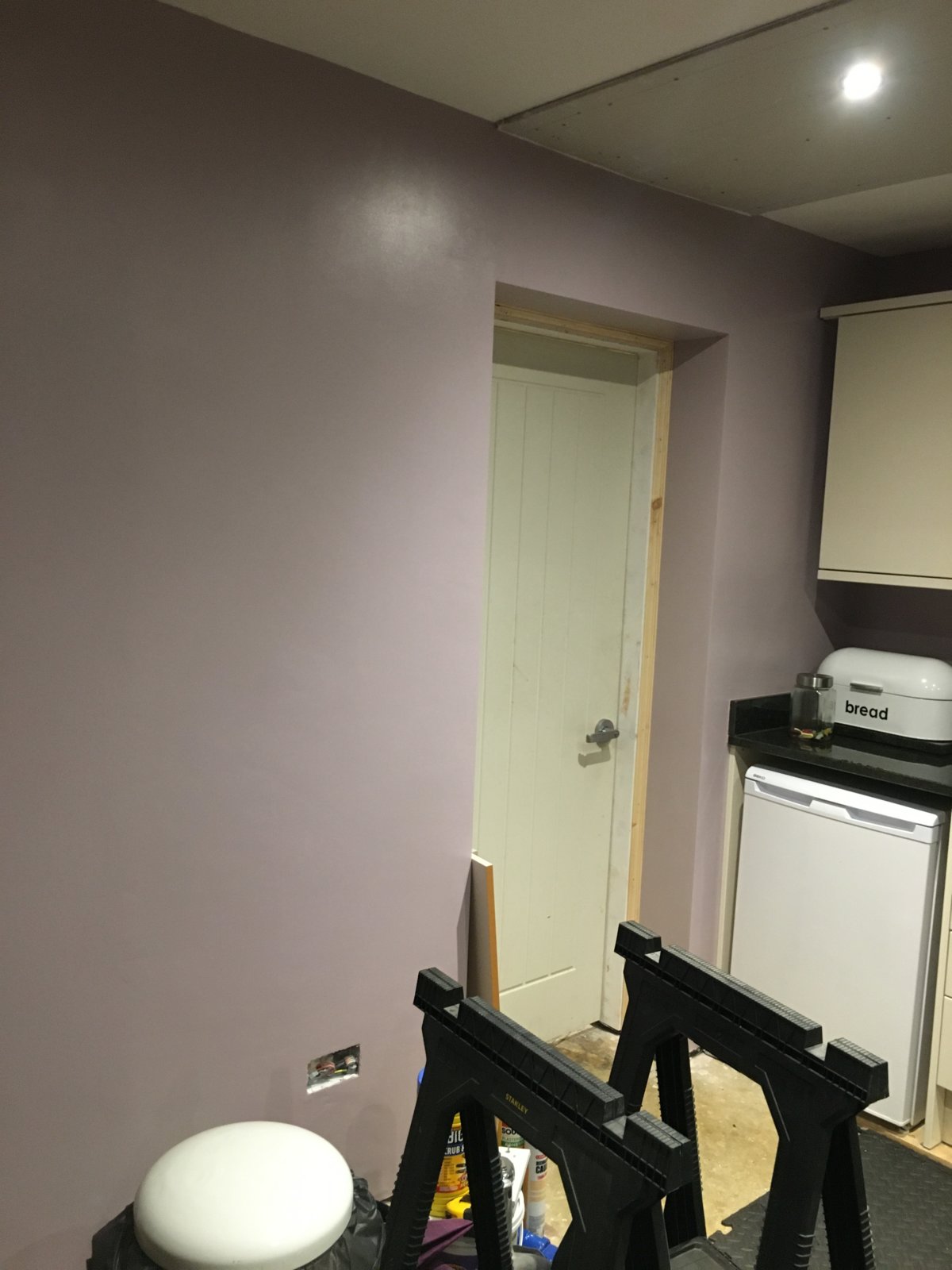

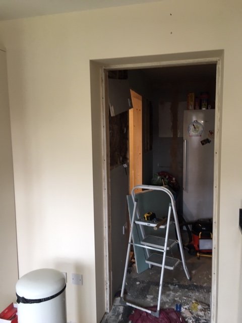

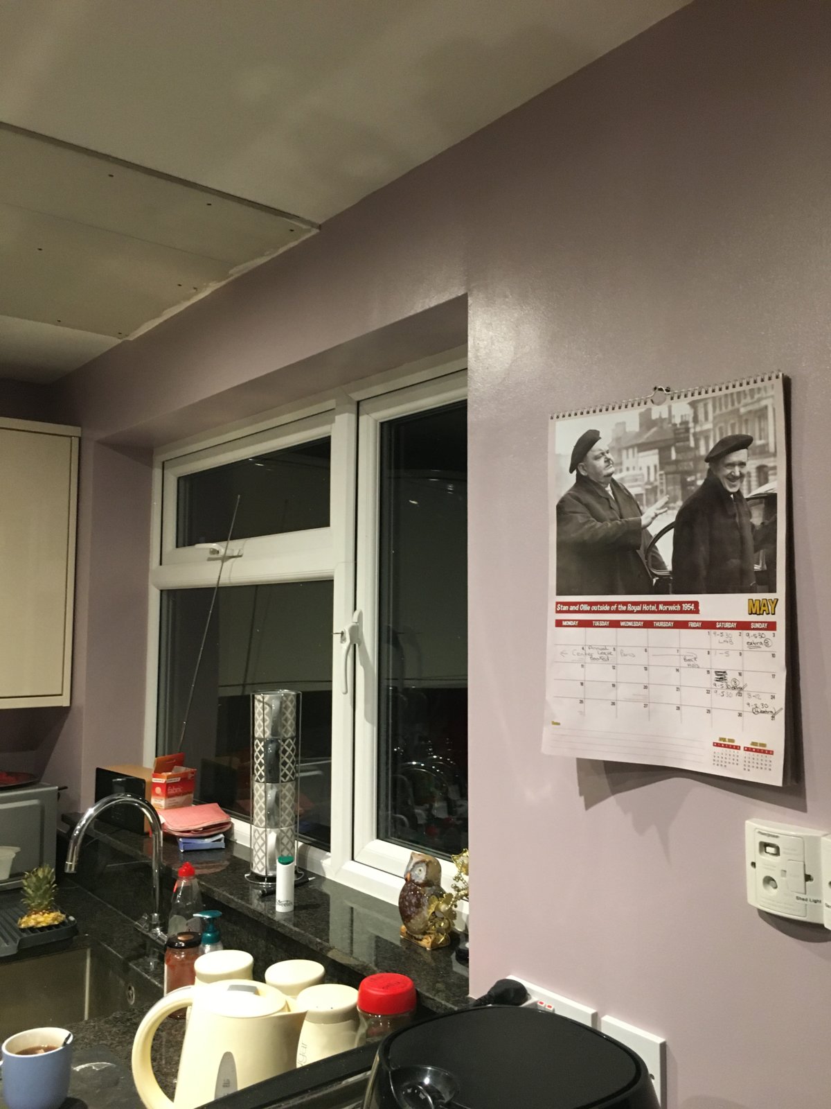

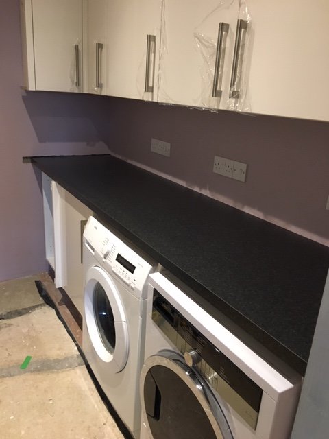

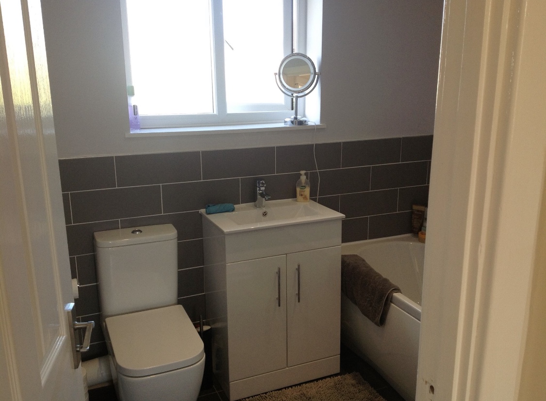

Re my post above and the pictures in the post above. I just finished making good a few weeks ago. I got a bag of plaster and the paint just after lockdown started so have had time to finish it and also the utility room behind it, next I have to do the ceiling joists and the bit above. The steels and flitch beam had to go in as I had a point load above the window and doorway and the existing lintels would not of been up to it. I had to do the bit below before I have to put the timber frame on above. Reason for the timber frame and not brick and blocks is the cavity is only 50mm wide so will not meet U regs. I patched in the plaster with fire the pink stuff plasterboard a bit of bonding and multifinish. Learnt how to plaster from youtube. Good luck with your project.......taken me a few months to get this far....
Looking great Glen, thanks for sharing! I love looking at the steels and how you’ve put them in...I’ve got a few chunky ones to go in to support the existing exterior wall and the first floor walls. @tony1851 helped me with the calcs for mine.

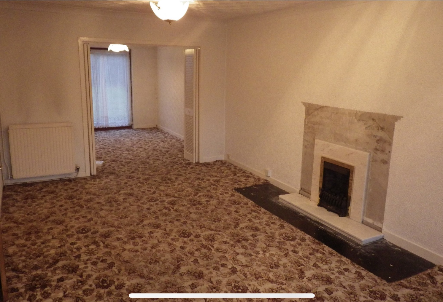

View attachment 192572 View attachment 192573
View attachment 192580 View attachment 192578

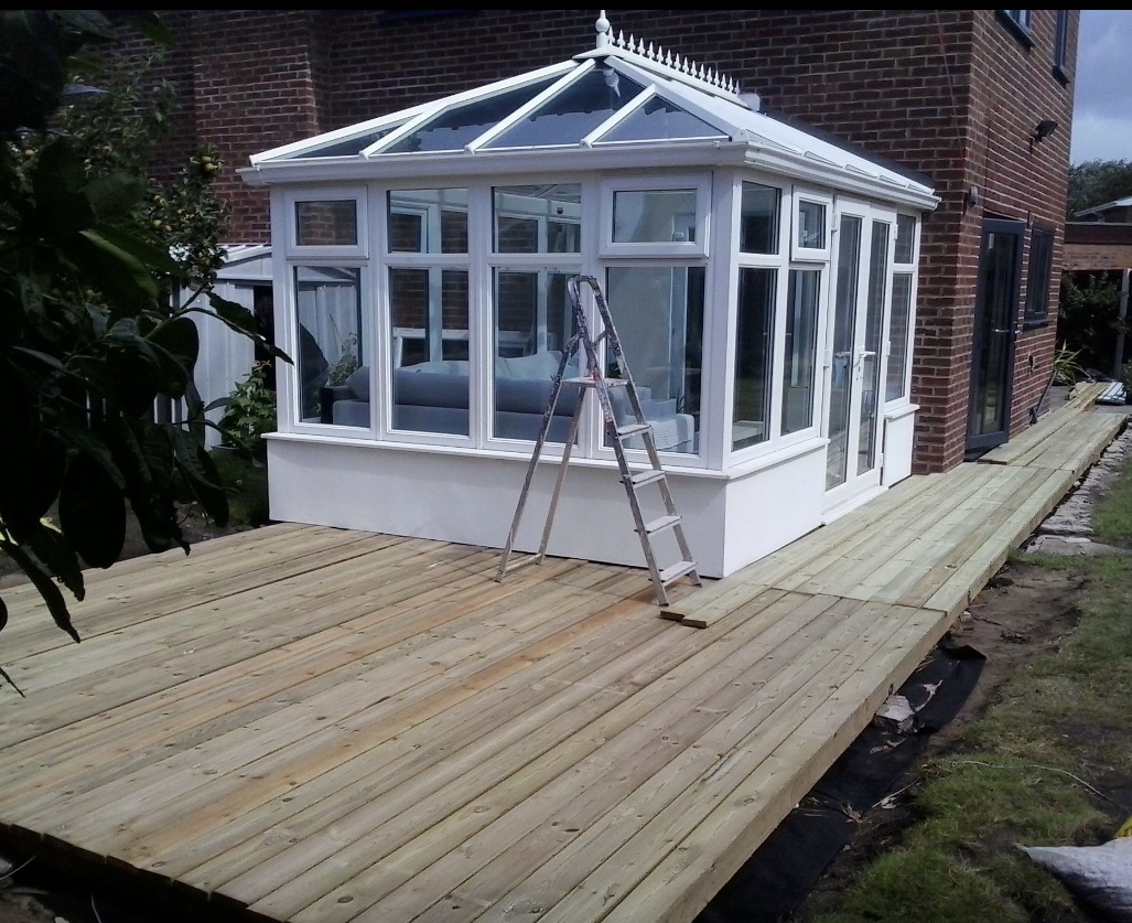

Haven’t put too many pictures of the conservatory build or refurb here, as this thread is mainly about the extension....

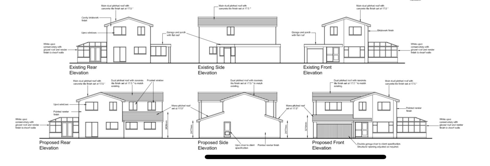

View attachment 192575 View attachment 192576

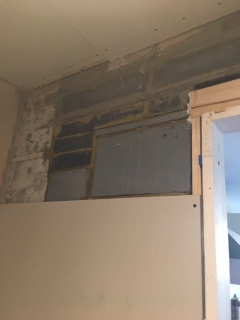

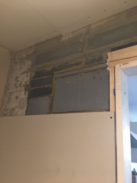

I'll post another pictures for you below. That's before I put the fire board on the pink plasterboard stuff around the steel as thats what my local building regs advised. Those guys are very helpful. The original plan was to cut a slot under the steel and slide a steel plate in to cause less disruption but in the end a couple of rows of engineering bricks went in, I got help from a local bricklayer as I am not that fast. The opening I had with the door in it used to be a kitchen window and because it was wider had stud work ether side before it got smashed out for the new steel. Instead of rebuilding it with stud work it made sense to put in some breeze blocks instead. I had already ordered the steels so just left it and put them under the steel.
I had an issue with the 45 degree rule and were they take the line from on the next door neighbours window. Some councils take it from the middle of the window and some from the edge nearest me. I would of lost a meter wider if I had not took it to appeal! That would mean I could not get a double bed in up there with room around it. I worked out that I would loose about 12m square I think from the build. I had to pay someone to write the appeal but was worth it. It was a gamble but well worth it.

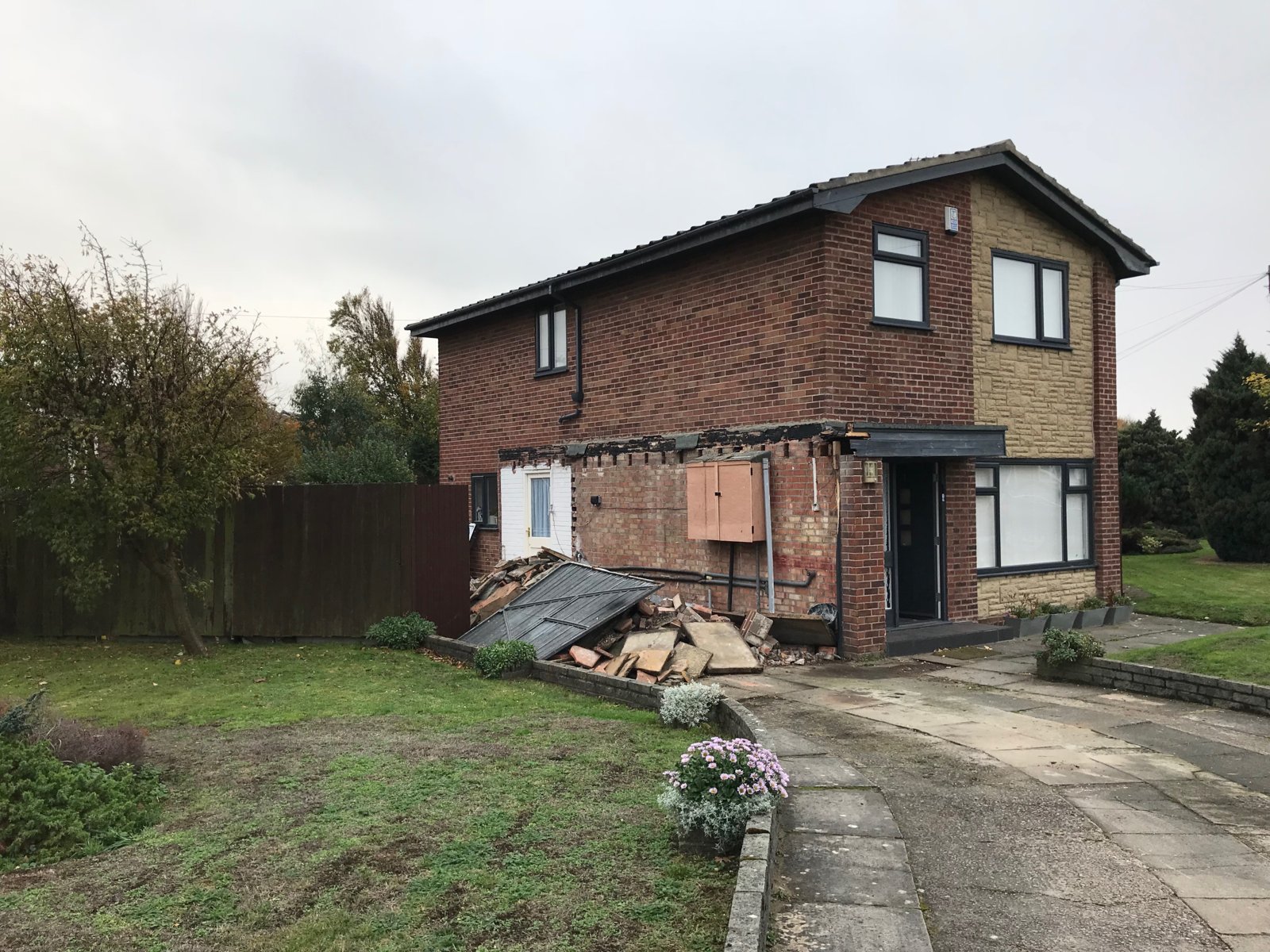

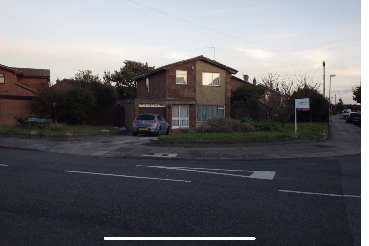

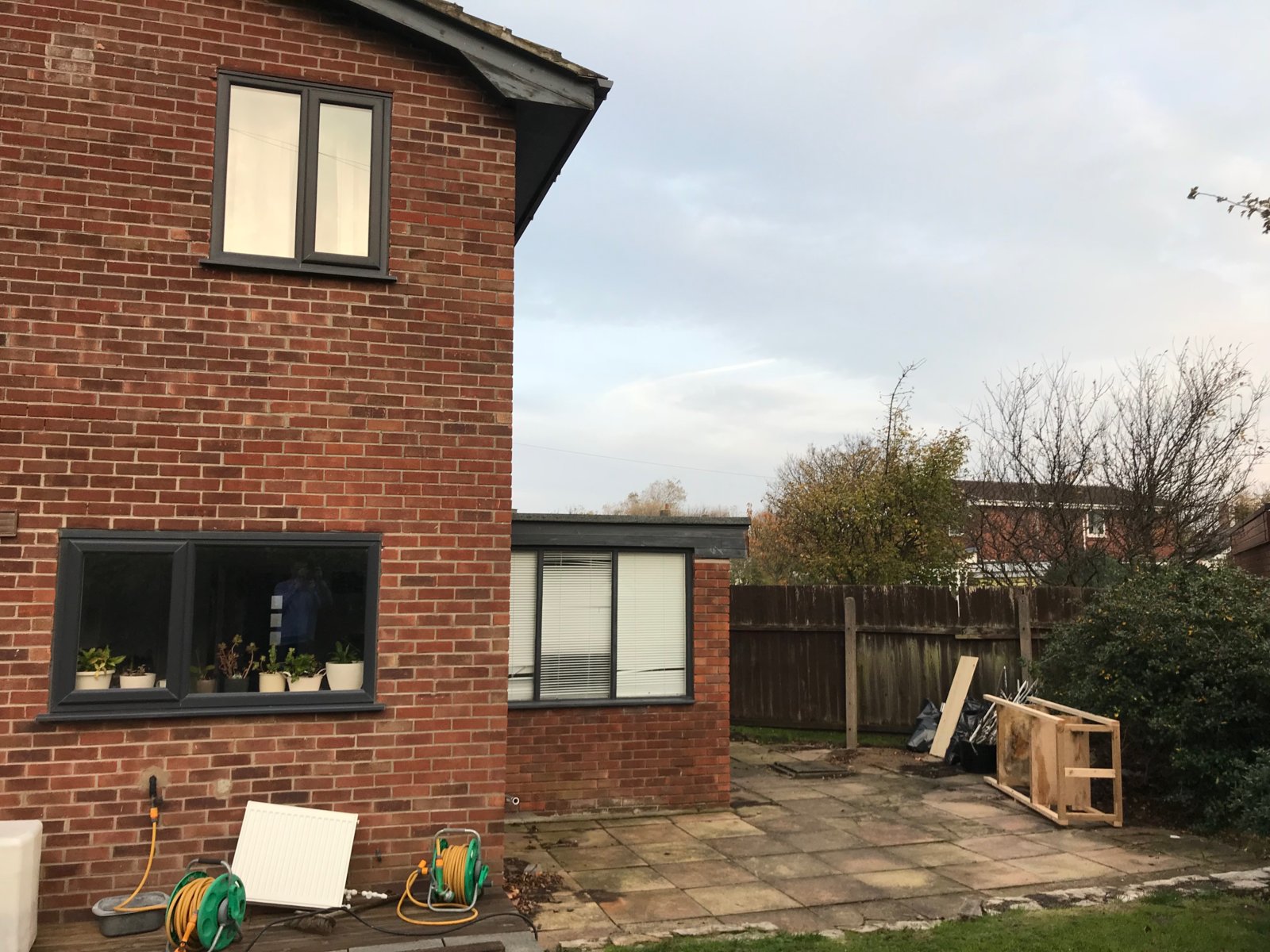

Here’s the house on the day the work started:
After a morning’s work, it looked like this:
And for the eagle-eyed on here you’ll see my rather sexy plywood box with felt roof on the wall. The gas and electric meters and the fuse box lived in the garage, so they needed to be made weather proof.

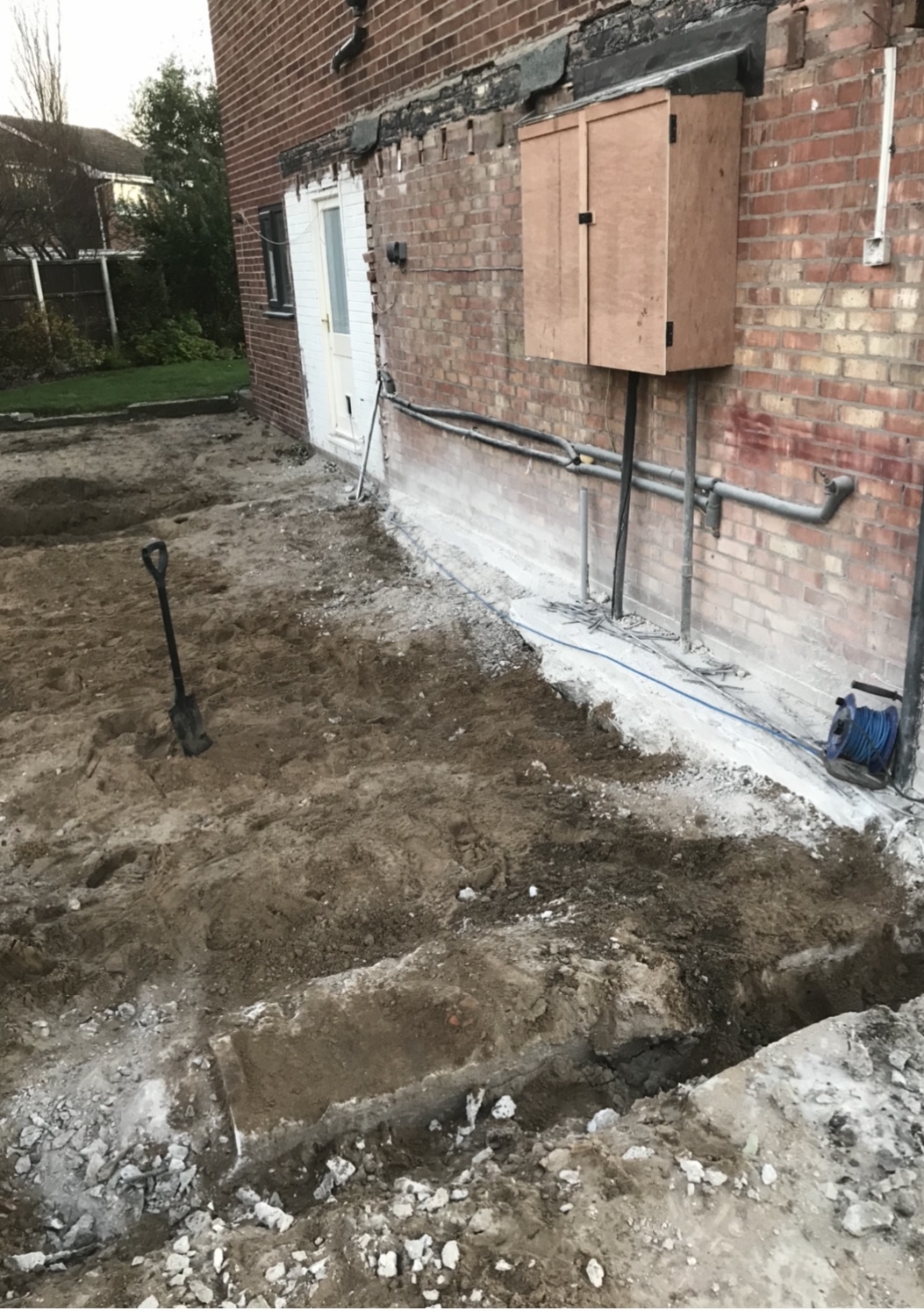

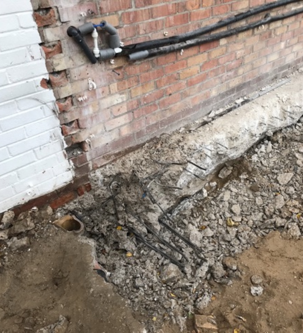

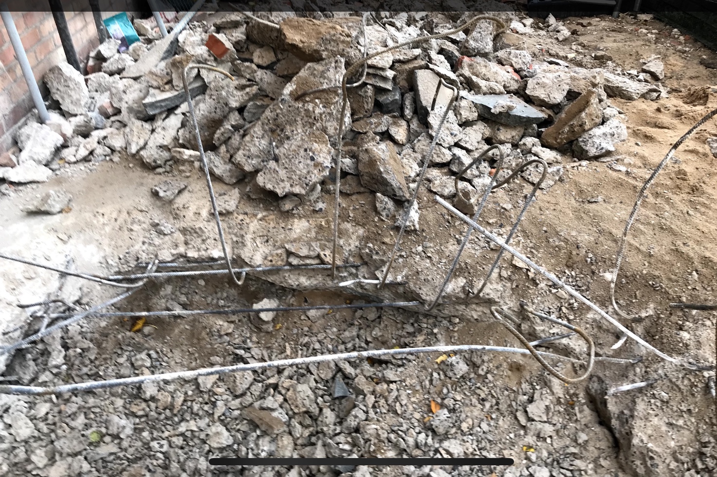

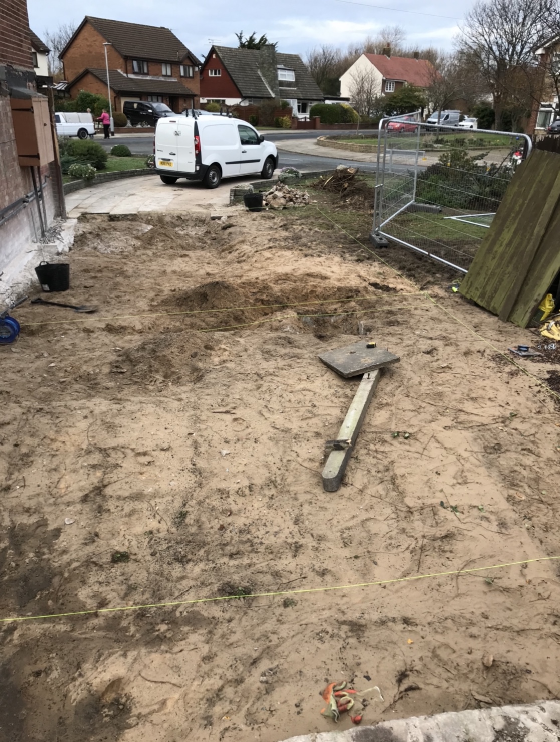

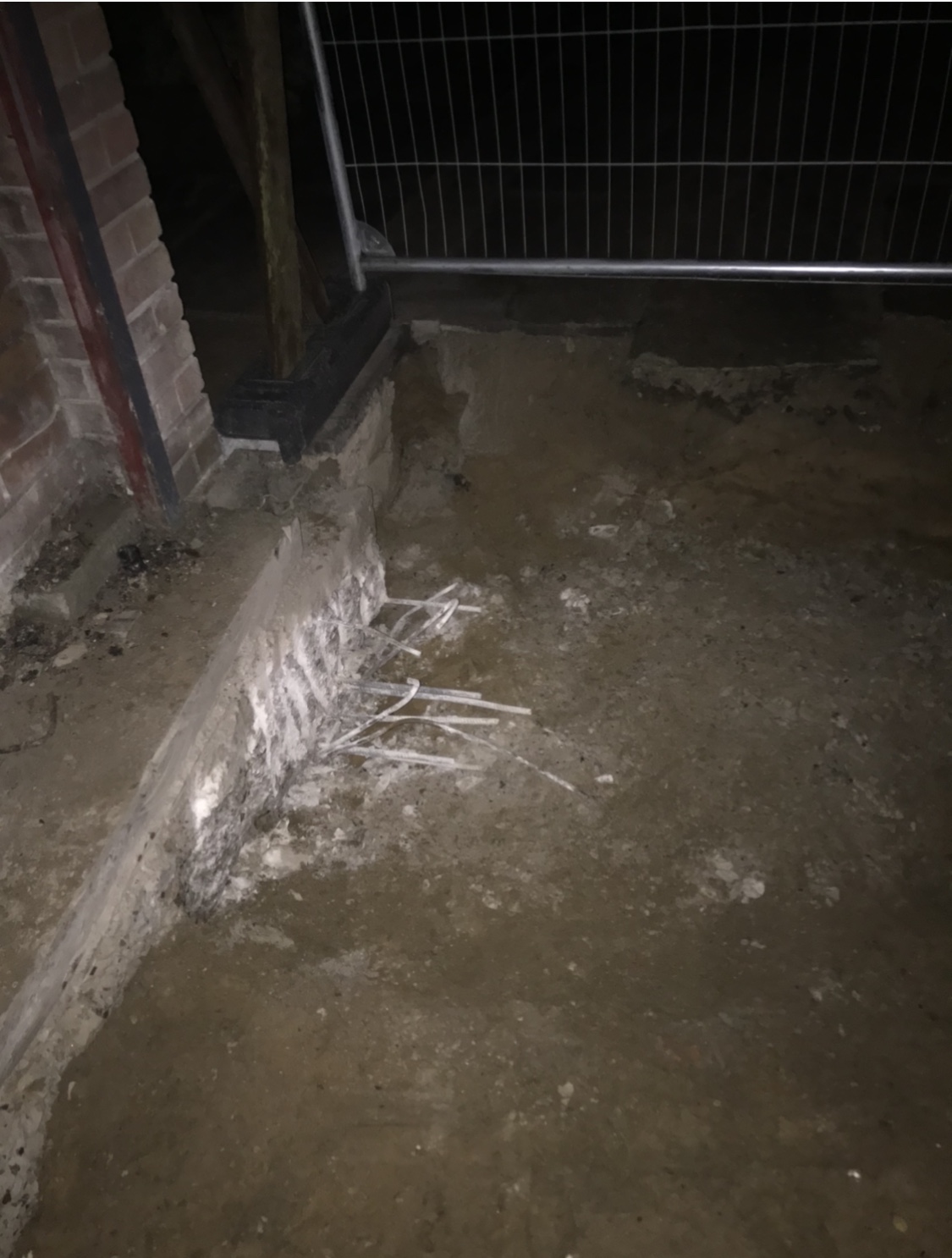

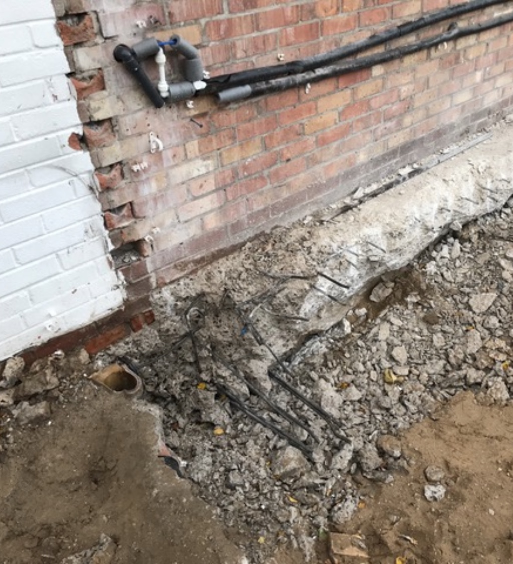

All was going well...then they started removing the garage floor. I hadn’t given it much thought, and the demo guys assumed it would be a standard garage slab...but after they started digging it up it turned out to be a beast of a reinforced floor, which was the same thickness as the rest of the house.
I guess that concrete must have been cheap back in the 70’s as they used a shedload of it!!!
I didn’t get many pictures of it, but basically after 2 days of pneumatic drilling the guys had only got about 25% of the way through the slab.
We had a powwow with the demo guys, who’d obviously not expected (nor priced) to be digging out a nuclear bunker, and we settled on another £1k to finish the job. Part of this money I understood was to get a mini digger and pecker on, which they did for a day before returning to their pneumatic breaker. Another 4 days of drilling and I think we were all at our wits end...as probably were our neighbours who are retired and home all day.
Unfortunately the demo guys left without finish the job fully, but I was glad to have them gone at that stage. In trying to save a few quid on not having the digger for 2 or 3 days they ended up breaking both their pneumatic breakers, and seriously cheesed off our neighbours!
They left with a 2m strip of 600mm deep reinforced foundation at the front of the property and a really untidy edge against the house.

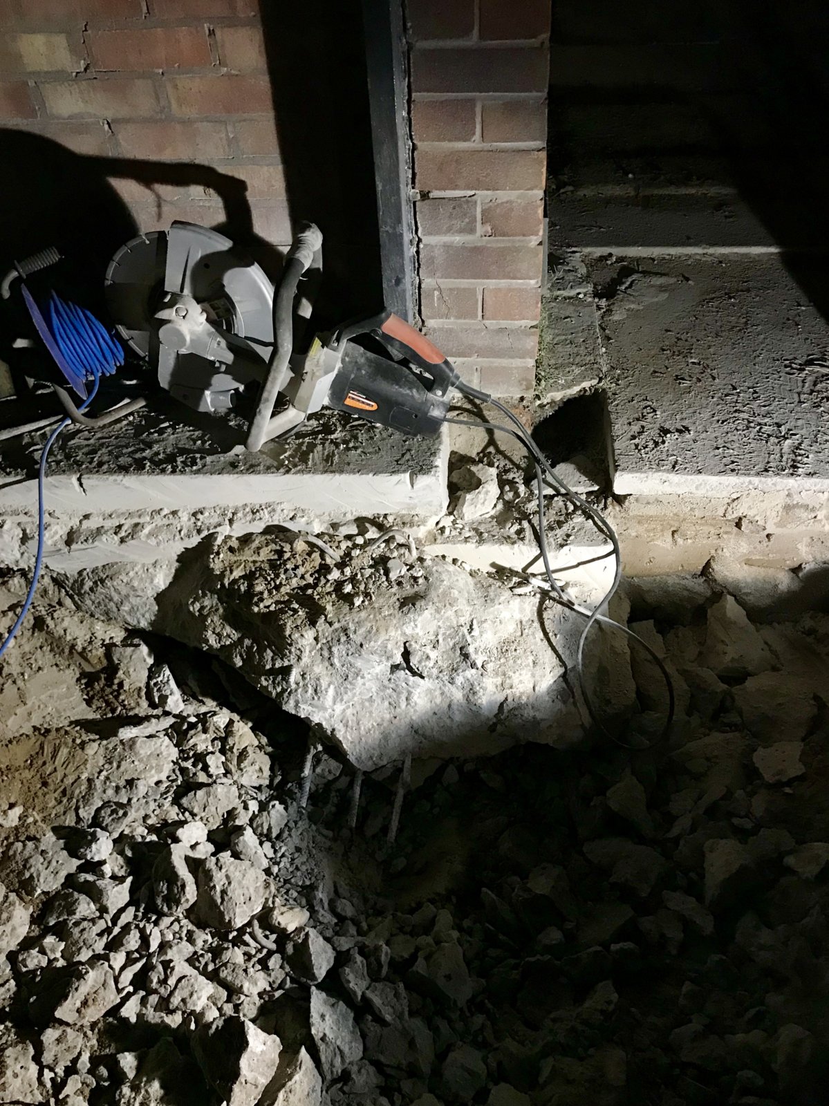

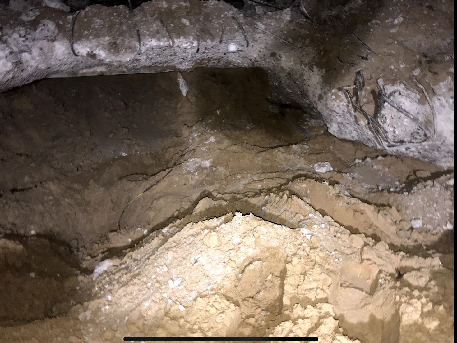

My plan was to hire the mini digger with pecker myself for a weekend and finish it off.
It was now-mid November, and the planning permission expired on the 6th December, so in the intervening period I’d been getting quotes for the piled foundations (more on that in my next post), but basically I only had one weekend within which to clear the rest of the site before the piling guys were coming. In that weekend I’d need to finish removing foundations the demo guys left in the above photo, and dig out a concrete manhole which was going to be inside the footprint of the extension and had was going to be made redundant by the building. No problem with the digger...I thought!
Digger turns up on the Saturday morning, but without the pecker I’d ordered. 1.5h hours later and they come back with the pecker....and the bloody thing doesn’t work. “Sorry mate, it’ll have to be next week now...” which wasn’t an option with the piling guys coming. The hire co came back with a pneumatic breaker and compressor, but the first one was leaking a bit of fluid...being a decent person, I didn’t want to bugger up their gear, so I shot up to their depot as it was shutting in 15 mins and swapped the breaker. When I got back that ‘new’ breaker just didn’t work at all and I was fuming as the hire shop was now closed! So it was off to screwfix for me, where I bought an electric 15kg breaker.
Oh my god, it was an absolute nightmare - just like the demo guys had found - the concrete only broke off in tiny little chunks and it’s was slow, hard and noisy going. My easy weekend turned out to be a proper slog. Invariably I overran the weekend, and as I couldn’t get time off work, I had to work by floodlight in the evenings to get ready for the piling company (as you can see from the darkness of this next picture!). This may me even more popular with the neighbours of course, but a bottle of wine and some chocolates delivered with an apology did go some way to appeasing them.
In the end I was using my disc cutter to slice into the foundation, to then chip off slightly bigger bits with the breaker.
With 2 days to spare, we were finally ready for the piling guys.
The above picture was taken on the 25th November, with planning permission expiring on the 6th December. While I knew that technically I could argue the demolition constituted the start of the build, and thus validated the PP, in my mind I wanted the sign off from BC for the foundations to be done before the 6th so there was an indisputable record from the council that the work was underway within the 3 year period....
