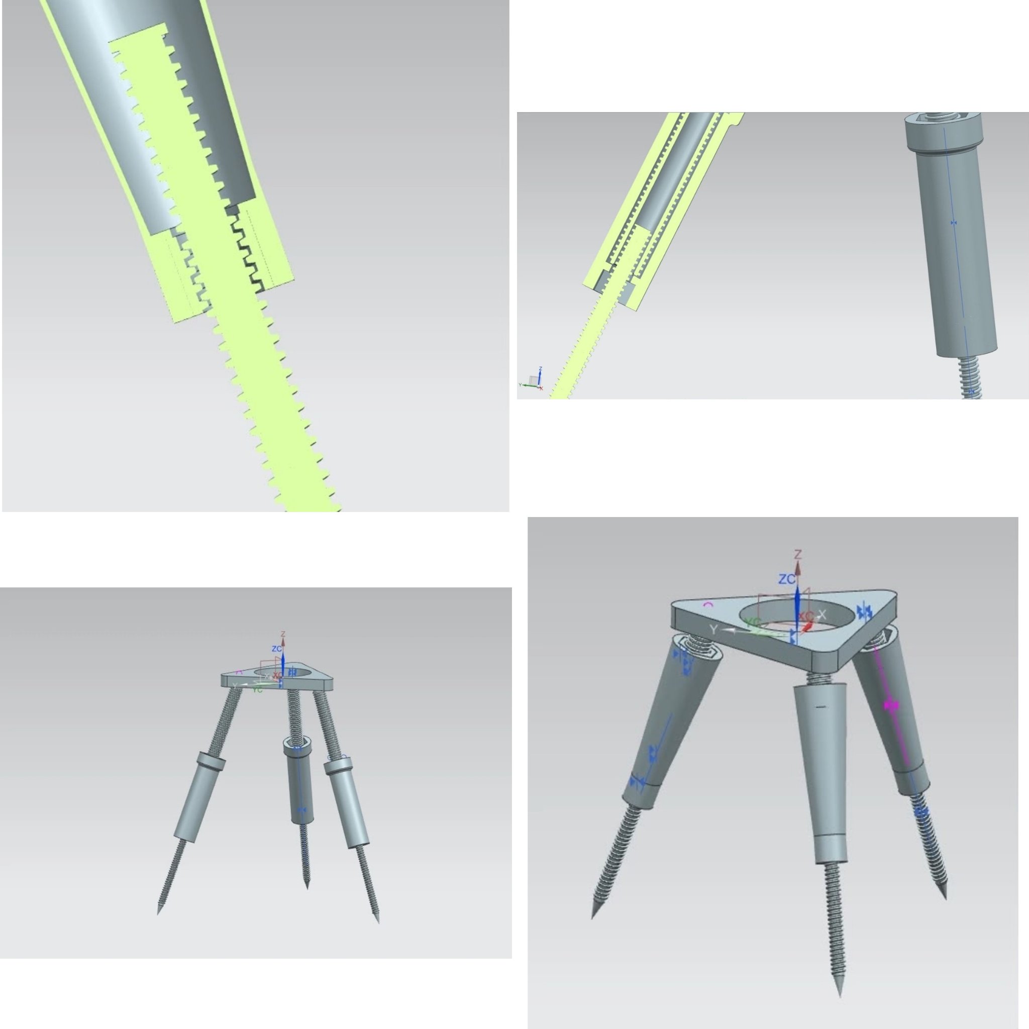

Following the discussion here, I’ve taken the idea a little further and made the first CAD model.
One important point that wasn’t clear in my original post: this is not intended to support Sonotube or another rigid form.
The concept is a system of two parts: a cheap flexible stay-in-place sleeve and a simple adjustable support that positions the top of the sleeve at the required height and location during the pour.
The sleeve carries the concrete itself; the tripod mainly controls its position and level. The idea originally came from watching someone with no construction experience spend a surprising amount of time cutting, bracing, adjusting and correcting conventional forms.
This is still an early prototype. I’m planning to print the support and actually pour a few test piers before deciding whether the idea is worth taking further.
The feedback I’m most interested in now is practical: what part of this would fail or annoy you on a real job?

OK I can see your thinking, but we don't normally put a simple cylinder on ground as we want to spread the load.
Economics then kicks in. Most of the time concrete is cheaper than labour so dig hole and fill. No shutters, no backfilling and compacting the ovrebreak. Or if you're at the back of beyond and concrete is expensive then you can afford to pay proportionately more for shutter and labour.
Your method would mean: dig hole, concrete base, wait to set a bit, set your tripod (you're on hard concrete so not easy or maybe wet concrete so removing legs without disturbing coumn a problem), fill the tube, wait again for some setting, strip tripod and backfill.
The already invented system widely used has a simple plastic form shaped like an upside down funnel which produce an insitu version of Rusty's Easypads. Dig hole set form fill with concrete, backfill round. All done in 1 hit
