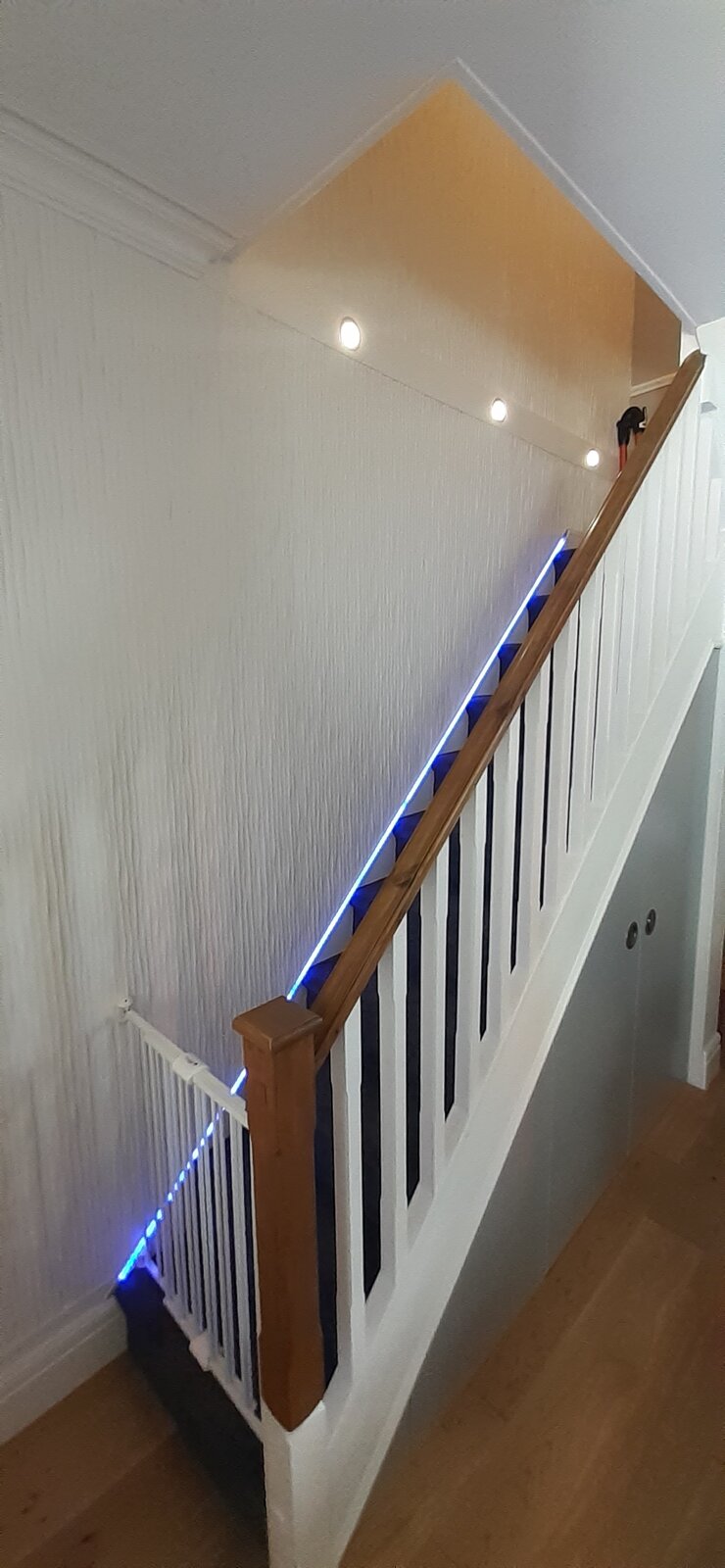

Have you considered decking lights?
E.g:
https://www.screwfix.com/p/lap-cold...brushed-chrome-4-4w-10-x-19-5lm-10-pack/7258X
They come in a variety of sizes and are (extra) low voltage, so there are no concerns about installing them yourself.
I've used similar on interior projects:
