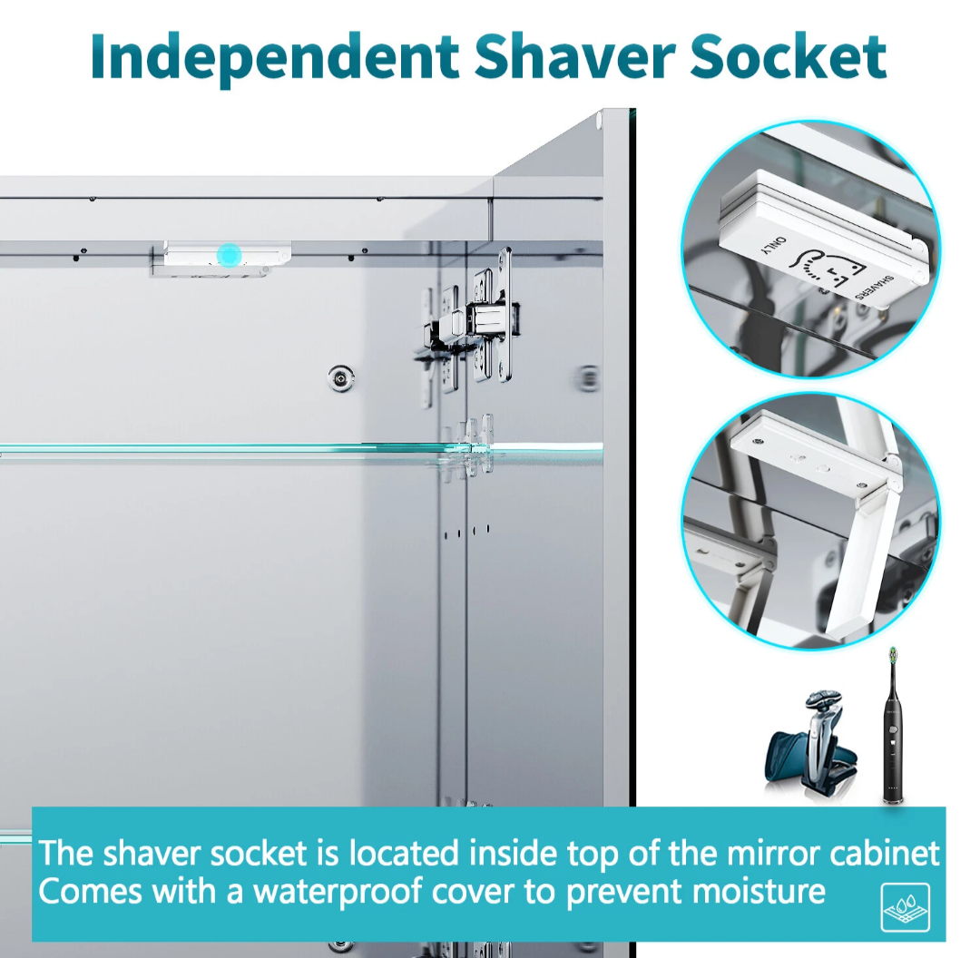

Hi any idea where to get a very small euro/shaver socket as per the attached picture? No isolating transformer needed, it's in a WC so outside the zones.
The smallest I can think is a single euro module from MK or similar but I can't find a small architrave box or similar to put it in, only a standard 1G box.

I think this is a full sized plate.
Probably wont take the full sized older shaver plugs though.
It may do if it does have the flats near the middle

Careful, a 2 pin euro socket is not the same as a UK BS4579 shaver socket. A 2 pin euro plug will likely be a poor contact fit and get stuck in a shaver sized socket, the euro pins are much thinner and the metal contact caps overhang the pins and cause them to be stuck on the shutters of most shaver sockets when trying to remove them, the pin spacing is different too.
The BG module above states it is rated 16A but 2 pin euro is rated 2.5A max (as is a UK shaver socket). 3 pin euro is of course rated 16A. It's difficult to find information on that unit as many online wholesalers appear to be using AI for the product descriptions, and as a result many of the descriptions are technically inaccurate dog shyte.
