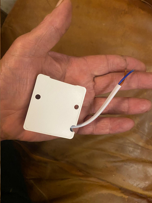

Thanks. I actually got one of them, to see what it was like, but there are some issues.
Firstly, the 12W one (which is what I got) is tiny (about 85mm diameter), not really large enough rto cover any sort of 'backbox', should one wish to use one.
Secondly, the 'base socket' is sealed, and has just literally a couple of inches of 2-core cable emerging from it (see pic). It would not be easy to connect that to the supply within any sort of enclosure, so I'd probably end up with just a couple of Wagos/whatever poked through a hole in the ceiling. I suspect some might regard this item as "eBay tat" :-)
If I did use something like this, I'd certainly buy at least one spare at the start, because I can't inagine any future fitting being compatible with that socket!

I used a couple of similar ones, in my kitchen, a good even light from them, and they have been in use for quite a few years now. As supplied, the lead was short _ opened the socket up, and soldered a longer lead on, did a joint in a wago, and pushed that up the existing holes. The fitting didn't quite cover the holes in the ceiling, so I turned up some sort of circular trim, to make them look tidy.

They clip onto a ceiling bracket, but do come with a short length (approx 6") of two core flex, that will need attaching in a manner similar to what you have said above.
...and just to say, they are possibly user serviceable (if you don't mind some soldering)? The light is provided by an LED strip stuck around an inner ring, rather than by PCB mounted LEDs.

I used a couple of similar ones, in my kitchen, a good even light from them, and they have been in use for quite a few years now. As supplied, the lead was short _ opened the socket up, and soldered a longer lead on did a joint in a wago, and pushed that up the existing holes.
That was my first inclination, but it looks as if it would need a 'tin openier' to open up the socket, so I hesitated - but they are so cheap that I might try.
In fact, provided that Mr Jobsworth is not looking, I may try just using the (very) short cable as it is, and a couple of 'in-line' Wagos, perhaps encased in shrink wrap 'as a gesture'! That would gop through a very small hole :-)
