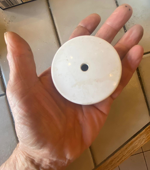

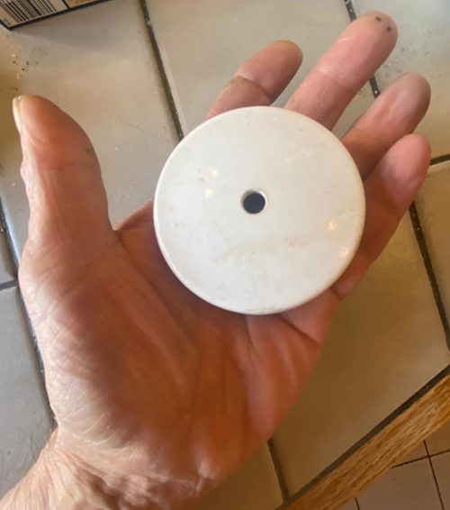

This is the smallest 'rose' that I seem to have on 'my shelf' - about 68 mm diameter and 18 mm 'high'. Although undoubtedly sold as 'a rose', it's not really quitre a 'rose' in the sense that we expect today - it's really '4-pole' JB with a screw on cover which has a hole in the middle - but would do the job.
It is, but it would be nice if, like the 'full-size' ones we are used to, it had more terminals - i.e. three for the permananet live (in, out and 'to switch') and more than one terminal for CPCs.

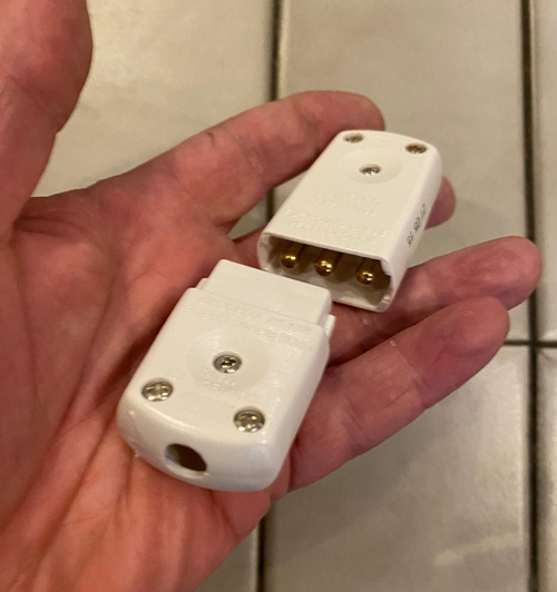

A bit of an update, since I will soon be making a decision. As you may recall, with thoughts of 'who might replace the light fitting with what' in the future, my desire is to find an approach which minimises the size of the required hole in the ceiling.
I'm no great fan of 'non-accessible' JBs (whether they are 'MF' or not). However, since there is yet no ceiling, I do have the option to put some sort of JB above it which would not through the hole (at least, the 'initial hole') in the ceiling.
My current inclination is therefore to install a MF JB (J804 or Wagos in a Wagobox) above the ceiling, with 3-core flex coming from that for the light. If I can get easily 'into' the light fitting, that flex could be taken all the way to the light fitting or, alternatively, I could some sort of 'small' plug/socket that would fit through a small hole in the ceiling - something like this one, which would fit through a 35mm diameter {or 35mm x 20mm} hole. Should the need ever arise in the future, the hole could obviously be enlarged to allow the MF JB to be fished out.

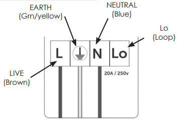

That's really bigger (bigger hole in ceiling) than I would like. Furthermore, I think that I'd probably need the 4-pole version (which is probably even bigger?) - since, without bodging, I don't think there would be any where in a 3-pole one to parl the CPCs, would there?
That one has 4 (internal) contact points for the wires (L, N, Loop, E)
But you are correct it is only three external connections (L, N, E) - which is the same as your image.
.... I think that I'd probably need the 4-pole version (which is probably even bigger?) - since, without bodging, I don't think there would be any where in a 3-pole one to parl the CPCs, would there?
I've just looked. The 4-pole opne is a bit bigger (113 x 55 x 22.5 vs. 110 x 42 x22.3), but it looks as if I would not need the 4-pole one. This diagram seems to indicate that, although there are only 3 pins, the 3-pole one has a fourth terminal ('Loop'). Does someone know if that is correct? ...

It's a case or "either/or", rather than "both". If I had a hole in the ceiling large enough for the Greenbrook connector to pass through (and we've now established that a 3-pole one would be adequate), I would not need an MF JB above the ceiling.
The only reason I was thinking of the MF JB was that it would facilitate having an appreciable smaller (3-pole) connector (hence smaller hole in ceiling) downstream of it.
Given that any light fitting I was using would almost certainly be Class II, I suppose it could theoretically be 2-core cable and connector, but (as required by regs) 3-core would cater for any Class I fitting in the future! However, the 3-pole Greenbrook would go through a hole less than 50mm in diameter, so maybe that's the most sensible way to go. Do you agree?
Having just looked, the Scolmore ClickFlow and Volex equivalents to the Greenbrook connector look virtually identical to it (other than colour!!), but all are much the same size.
