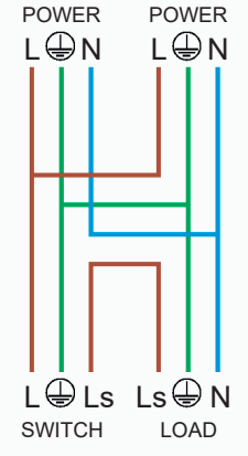

Functionally, that is just what I need (see diagram below). However, the one apparent issue is that, in my application, the "load" cable would really have to be flex (very probably the pre-wired bit of flex sticking out of the light fitting) and I'm not sure how/if that could be got into their 'push' terminals. It could be that by using their "cable removal tool" (does one of those come with the connector?) one could open up the terminal enough to get flex in - do you know if that would work?

Can you run a 1mill cable and connect to the flex inside your light fitting?
Possibly, if I can get the fitting apart - it currently just has a 6 inch bit of 2-core flex emerging from it.
If getting into the ('throwaway'!) fitting proves problematical, suppose another, but rather messy (albeit virtually never seen), possibility would be to have a second small connector joining a short bit of 1 mm² T+E to the fitting's flex.
You could use a "switch and load" to handle the switch along with a "T-Connector Plug & Socket" to transition from T&E to flex. Both items could then be fed through the hole.
I agree it's suboptimal to have to use two separate items though.

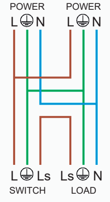

could you use 1 of each type in series
Yes, that's the sort of "second small connector" I had in mind - but, as you go on to say ...
As for the "T-connector Plug and Socket", the spec says that the plug has screw terminals which are suitable for "1 x Flexible (Class 5/6 conductors) or 1 x Rigid (Class 1 conductors)", so I presume that must be true (although I don't know what these 'C;asses' of conductors are), even though the instructions talk only about the push-in terminals (presumably for the 'socket'). Do you know if that is the case?
You could try connecting the flex. If that fails, is the well deep enough for you to run t&e and connect using a couple of wagos?

Presumablly IEC conductor classes.
Class 1 is "solid"
Class 2 is "stranded" (conduit singles and similar)
Class 5 is "fine stranded" or "flexible" (flex and similar)
Class 6 is "extra fine stranded" or "extra flexible" (often seen in test leads, welding cables and similar)
