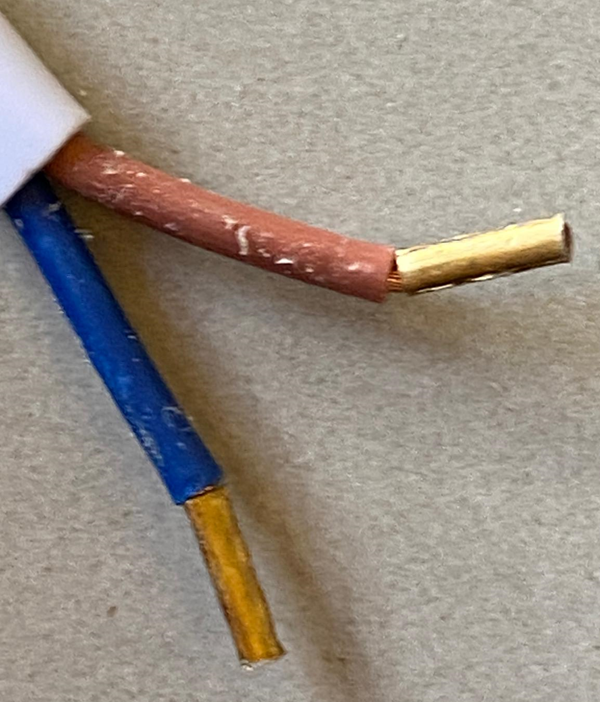

Possibly, copper coated steel?
That was my first though, but my magnet said 'No'(unless it's stainless steel!).
However, it's a case of needing a tripto Specsavers (which is actually true, since I have very recently undergone cataract surgery, and therefore need new 'near-vision' glasses) - since, now that I've got out a magnifying glass, it's apparent that the stiffness of the end of the conductors is due to there being ferrules on them (see pic below).
The ferrules are pretty short, but I nevertheless think that they will probably work OK with the Quickwire connector, thereby rendering moot most of the recent discussion and allowing me a 'one connector' solution (just one 'switch & load' Quickwire connector).

However, as I've recently written, I think I may have 'solved the problem', by discovering that the ends of the captive cable' on mine has ferrules - so it may well go directly into a push-fit Quickwire terminal, despite the short length of the ferrules/
A bit of an update, since the Quickwire "Switch and Load" connector has now arrived.
It does do 'what it says on the tin' with T+E, provided that one strips both insulation and sheath pretty accurately to the specified lengths. The "cable removing tool" also works. However ...
1... Despite my hopes, there's probably no way that one could get flex into it, even with the ferrules. One locks/activates the spring-loaded terminals by pushing (pretty hard!) on the cable, and it is the sheath of the T+E that then does the 'pushing'.. It wouldn't work with flex. I'm therefore stuck with some sort of 'two connectors approach (unless I take the fitting apart and run T+E all the way into it).
