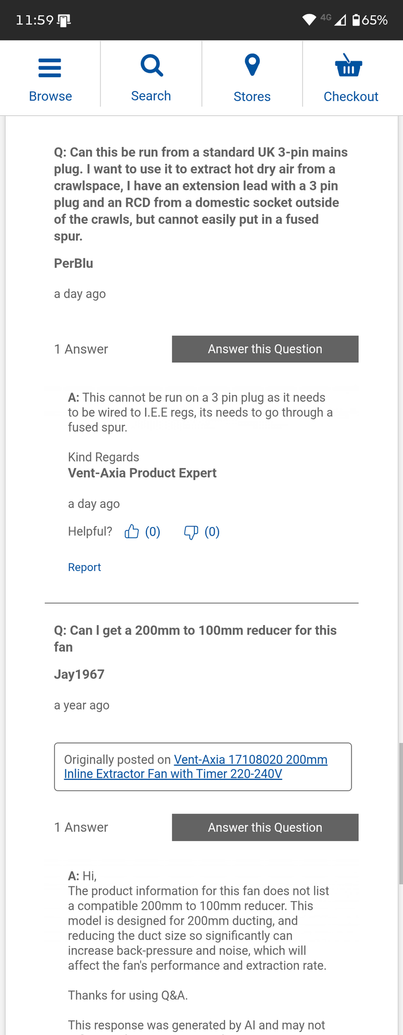

I want to upgrade my ventilation system to be controlled by my home automation server running Home Assistant, but I've been told that I must use fused spurs for the extraction system.

I'm being told that all fixed appliances need one. is this not the case.
No, that's not necessarily the case.
Whether they need one depends on the situation/circumstances, regardless of whether or not the applianceis 'fixed'.
