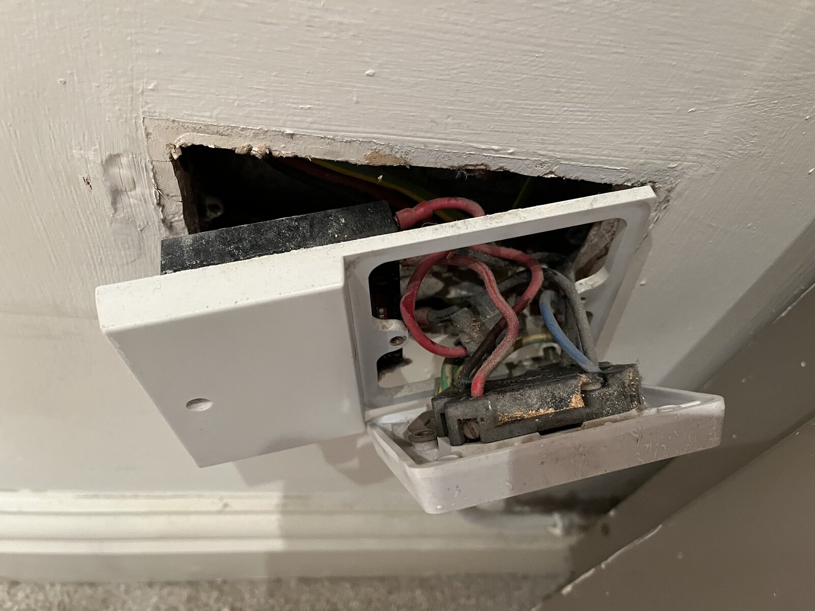

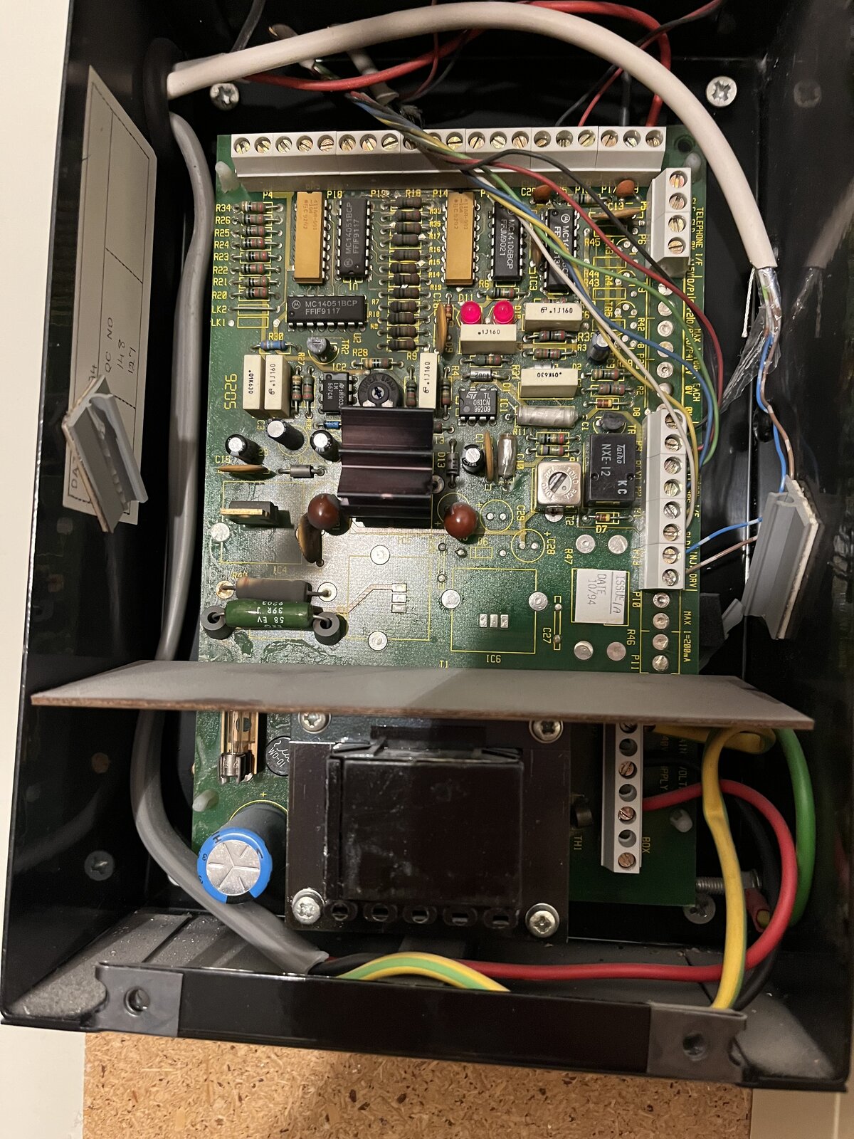

I went back to take some photos
He has a 5 terminal meter, but no idea where the 5th terminal is connected - there’s no contactor
The storage heater circuit is permanently live, so the Apollo Fixed Receiver is supposed to be switching
On the keypad, the storage heaters indicate “waiting for TC signal
No contactor here
Next to consumer units - no contactor here either
Next to each storage heater - permanent live feeds these

Possible that the main unit was previously connected to a teleswitch or similar, and as that's been removed it's not connected to it any more.
Look for a cable near to it and the meter that's not connected to anything.
Or the unit has failed, which given it is 30+ years old would not be surprising.
If the unit can't be made to work, then it would be a simple matter to bypass those 'fixed receivers' at each heater and use the switch there to turn them on/off until a more permanent solution can be found.
I found an eBay listing with a photo of the innards of the “fixed receiver”:
(Click “see original listing” then look at the second photo)
It contains an LM1893:
That’s a mains digital transceiver, presumably receiving on/off commands from the main box.
The photo of the PCB in the main box doesn’t seem to be showing everything, as far as I can tell. I don’t see anything that could be controlling the LCD and keypad, nor do I see a radio teleswitch receiver.
Mysterious!
Anyway, it’s 33 years old. Even I would be tempted to replace it, rather than trying to repair. And I would likely suggest replacing the CU too….

AFAIK the relay at the heater switch was controlled by a RF signal injected into the T&E supplying the heater
