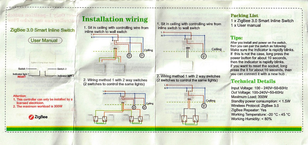

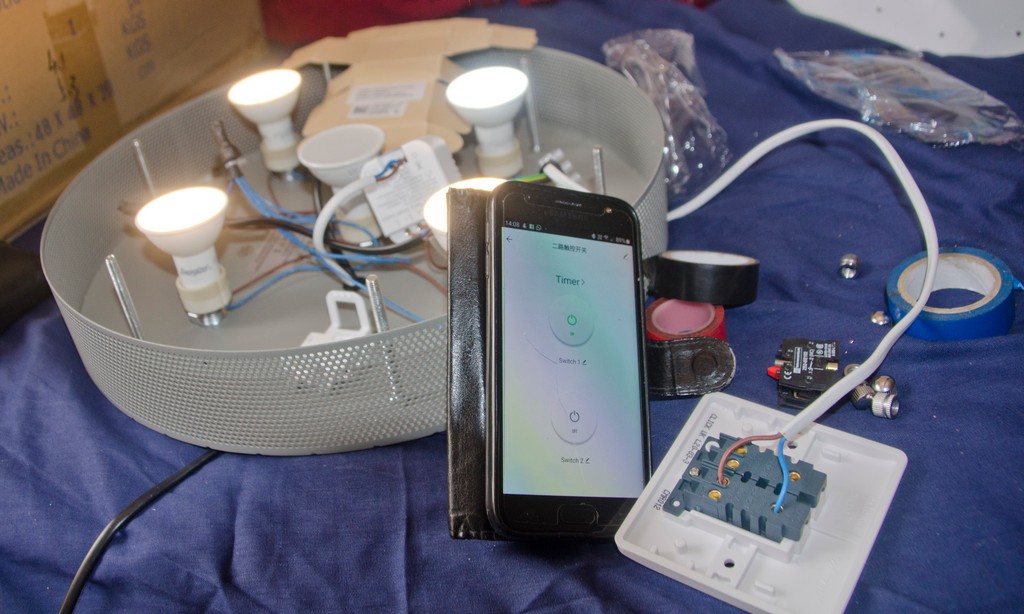

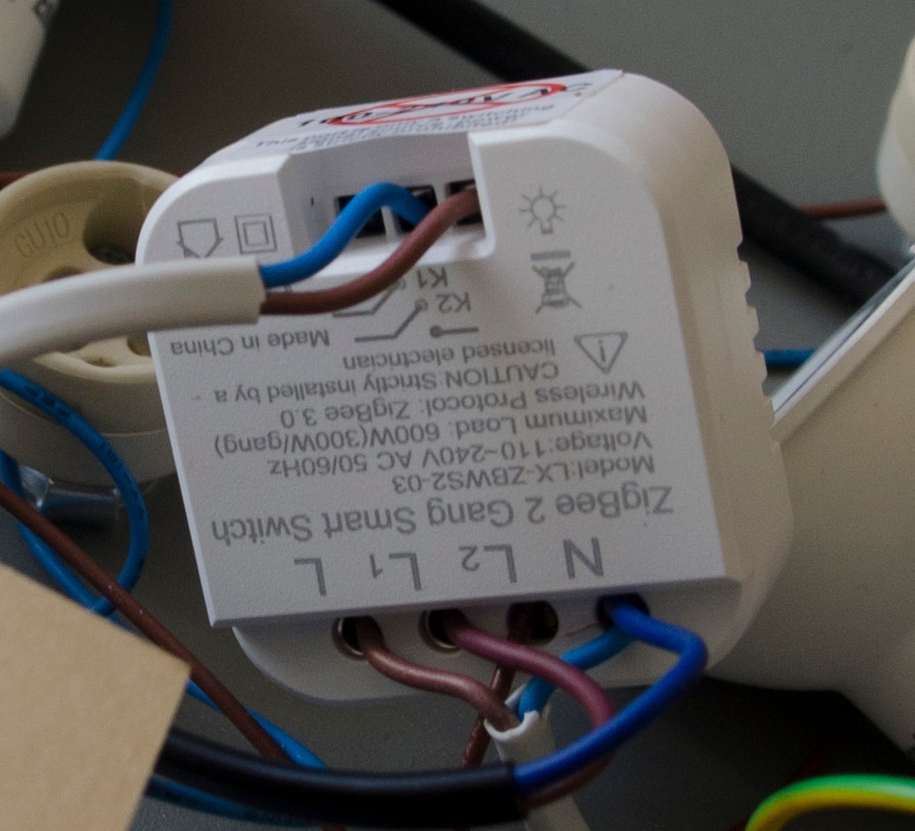

I intend to use a relay DSC_6060.jpg DSC_6061.jpg Landing-light-relay-instructions1.jpg Landing-light-relay-instructions2.jpg it means original switch becomes extra low voltage, and works like a two way switch with the relay.

Thanks guys. That's really promising.
I assume neither of these can work with the switch wire alone as that's all I have at the switch? I thought this may be an easier option as I could get a deeper back box for the 4 gang switch and loose this device in the back.
The live in and out (loop as I call it...) is behind this light and as you can see, there isn't much space behind this uplighter. I recall that struggled to fit the loop in here.
Look forward to your suggestions. Thanks again.
