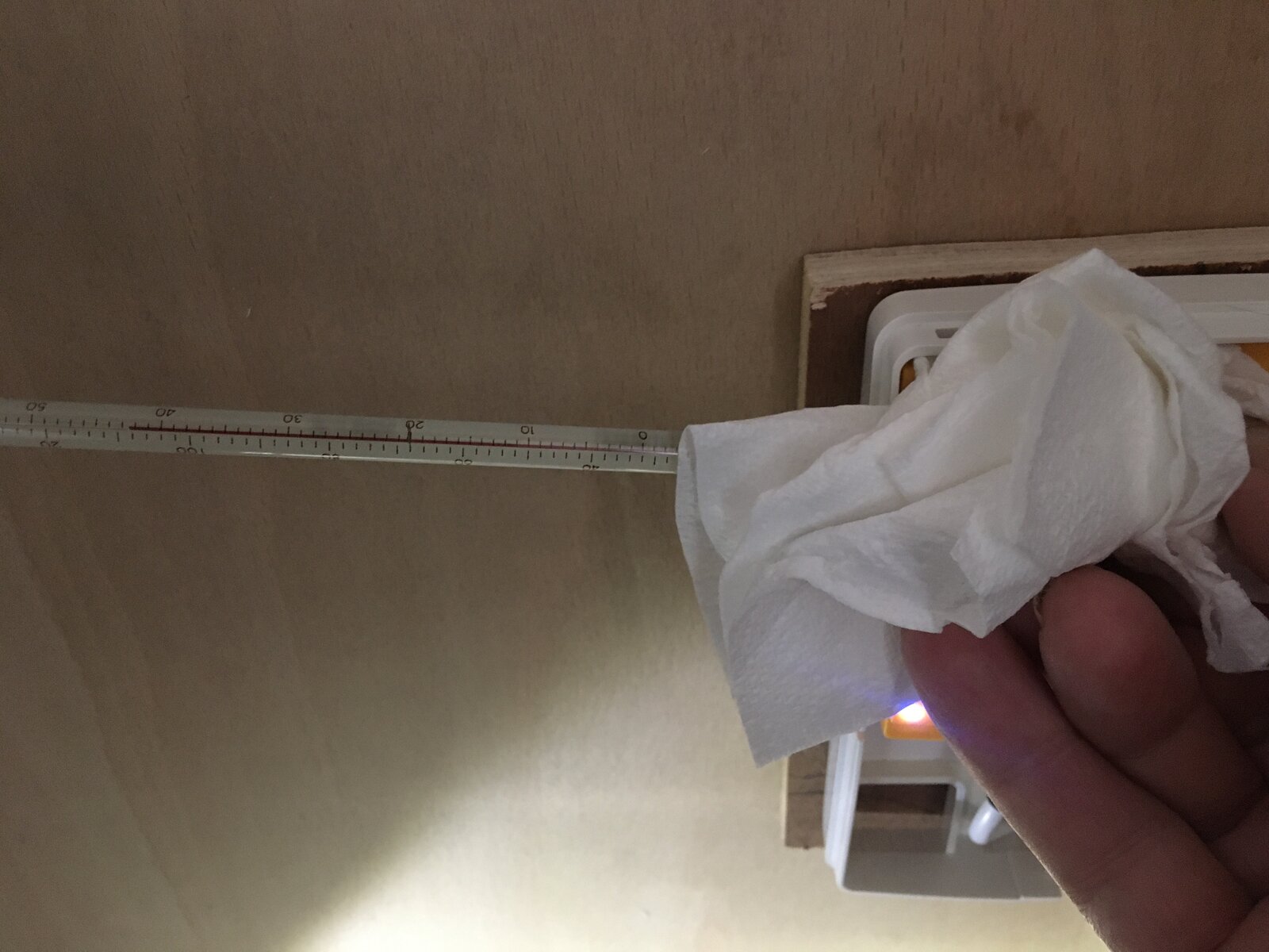

The yellow/orange plastic box inside the smart com is warm to the touch. I have used a bulb thermometer held against the plastic with multiple layers of tissue paper between my fingers and the thermometer so it gives an indication of the temperature of the plastic rather than the temperature of my fingers. I get the following results
Surface temperature of adjacent control box cover : 24 deg C
Surface temperature of yellow/orange box inside the smartcom : 42 deg C
I sent this off to Texecom and they say the smartcom is faulty so I am exchanging it.

Never seen one warm to touch, human adult body temp is 36.7oC so 42oC would feel quite warm, but given I got in the car a few days ago and it was 38oC and that felt bloody warm, wasnt a fault with the car, just it sunbathing.

I have now exchanged the smartcom for a new one, very efficiently done by Alert Electrical, I can recommend them. This is the second time they have sorted out a texecom return for me. They use dpd and I was kept fully informed by email, delivered new item and collected old.
The smart com is now working, set up was easy. Top of case is slightly warmer to the touch than the bottom, but nothing like before.
