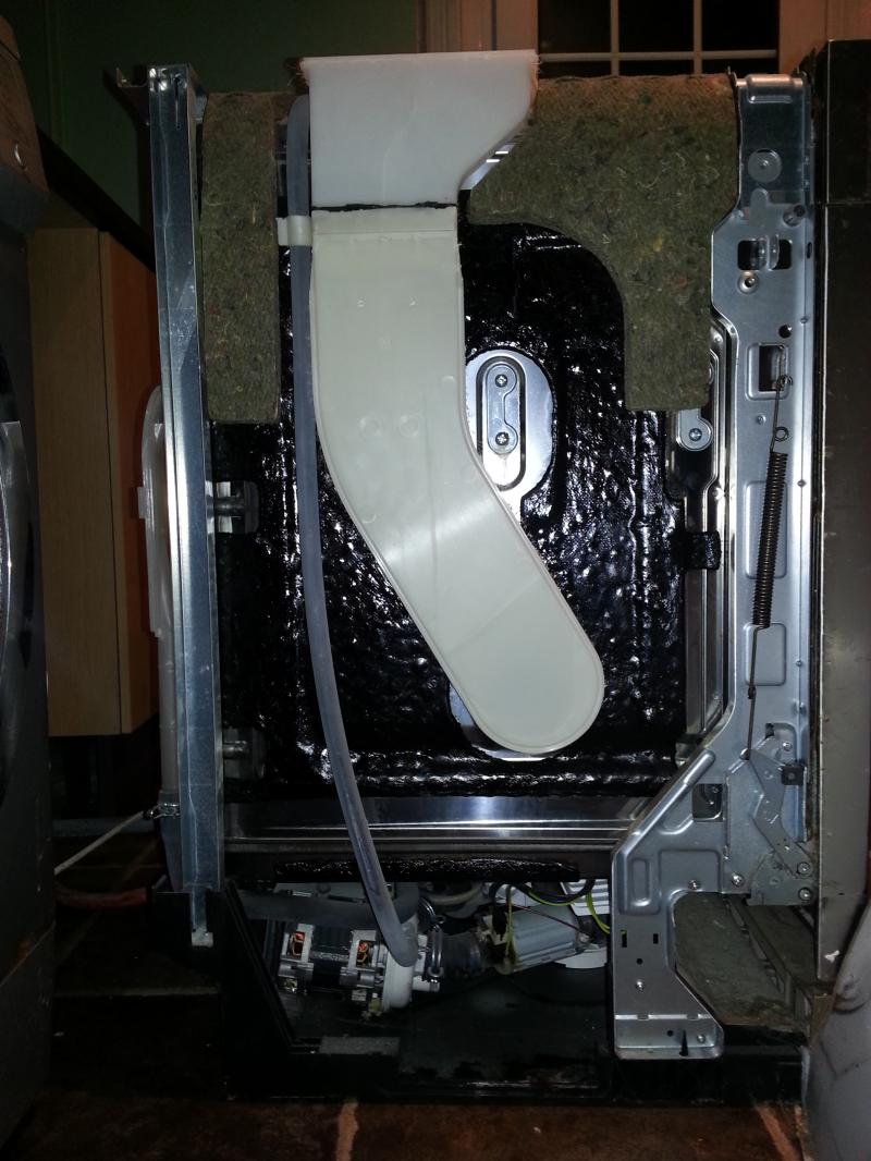

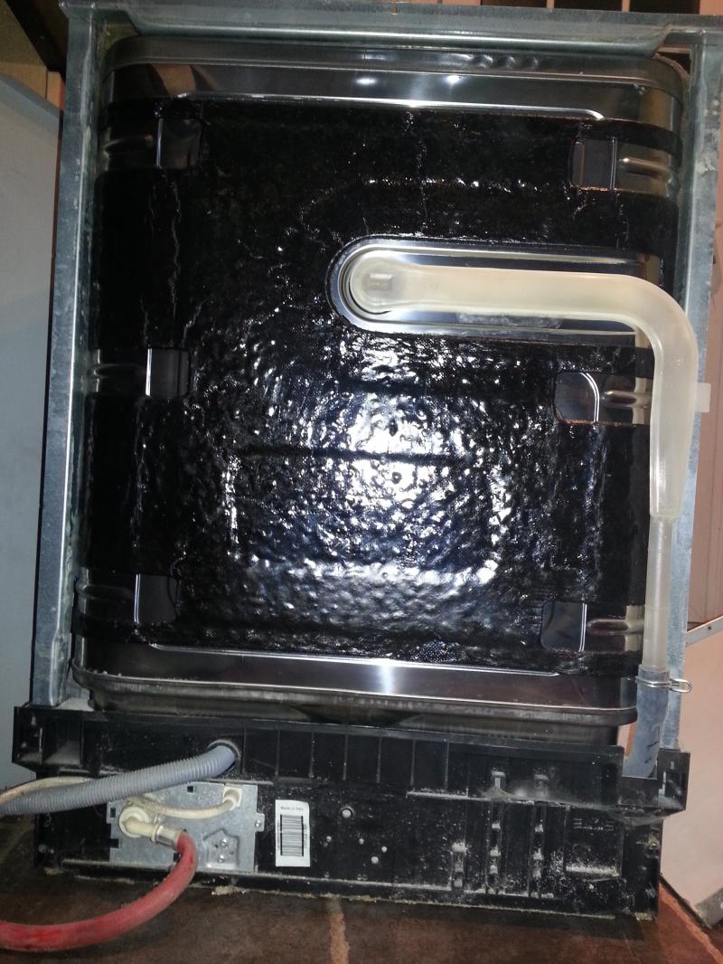

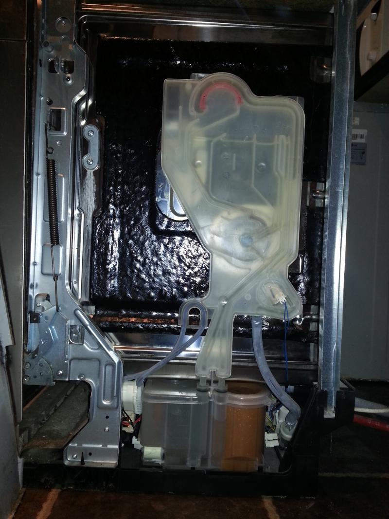

Ok, I've removed the lid, side and rear panels (photos attached), but not being all that experienced in such matters am not sure where the heater element will be. I have a multi meter so presumably I can just connect it to either end of the heater and measure the resistance/current...?
