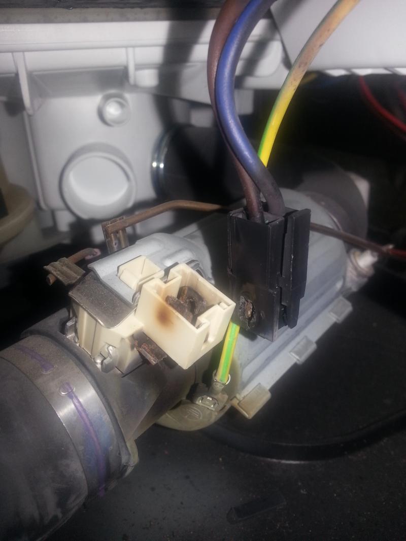

Smeg DF612SDX Dishwasher blows main fuse

In 1st photo the heater is the silver metal cylinder to the right at the bottom.

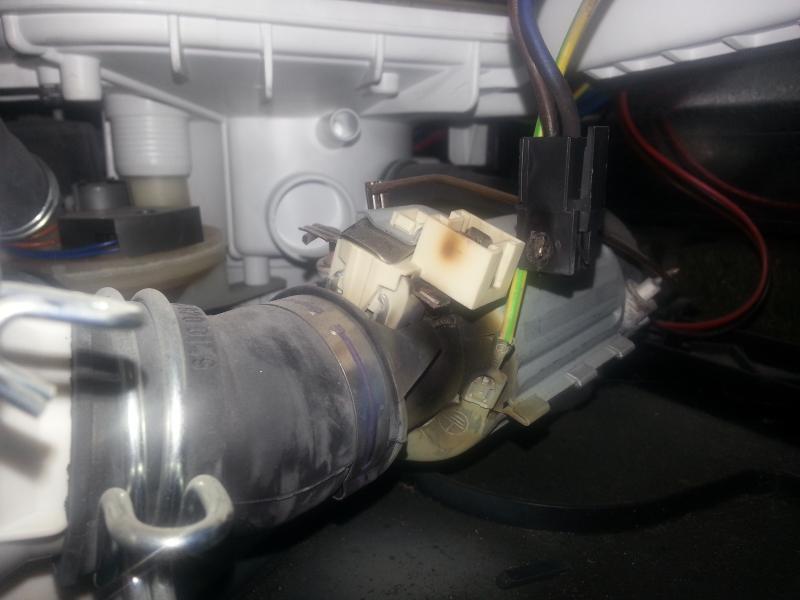

Well I had my job cancelled this morning so was at a loose enough end I was able to see about testing the heater element. I didn't quite get that far though. As you can see from the photos, after disconnecting the black plug from the heater it appears to have been getting rather warm. Is this an obvious sign of the heater element being knackered? Do I need to test any further? Looks like the element has been pulling too much power through the plug...? Is there likely to be another cause of the melting plug?
Cheers

Yes, there's little if any clean metal that I can see and the position of the terminals will make them hard to clean up. Will try the copper bars if needs be.
If the heater is ok it will be necessary to clean the contacts on the heater and the plug connector in order to continue using it.
Small flat bladed screwdriver to carefully scrape away corrosion./crud etc...

Same as when I connected to the connectors inside the black plug. THe reading remains at 1 and doesn't change.
Perhaps try running a wash programme (with heat) but with the heater connector left off.
It will take longer to run but will eliminate the heater if it does not blow the fuse.
The heater could be at fault whilst in use i.e as it heats up.
Whilst its running you could observe to see if any leaks and what the pump is doing. Bosch circulation pumps are exposed and easy to see, not sure about yours.
The dishwasher runs for longer without the heater being connected, to the point where it realises the water's not being heated and switches itself into error mode. I cancelled that and started it running again and got the same result.
I can't see anything going on to indicate whether the pump's working properly or not but it sounds like everything's ok. There's definitely water flowing through the machine. I can see it passing through the plastic channel that runs up the side.
No sign of any water leaking anywhere.
Yes thought it might error but seems as though it is pointing towards the heater being faulty.
Ideally to properly test the heater you would need an insulation resistance tester like a megger but too costly just for one use.
Try and find a 2nd hand heater on the cheap and replace. They are around £20-25 but one ending on ebay in an hour if it will fit for £10 plus £3 post and has no bids.

Ok, that seems sensible. Thanks very much for all your help here. I had a look on Ebay but can't see anything ending this evening. I saw several of these...
http://www.ebay.co.uk/itm/Smeg-DW16...nces_Oven_Cooker_Hoods_ET&hash=item2ecf6ad543
The machine model number stated is different to ours but the part looks the same. I should probably replace the melted plug too. Where would I find one of those? Electrical factors?
Yes thats it but check wattage matches yours, bore ends and length.

Probably easier to buy new female spade connectors with insulated covers.
