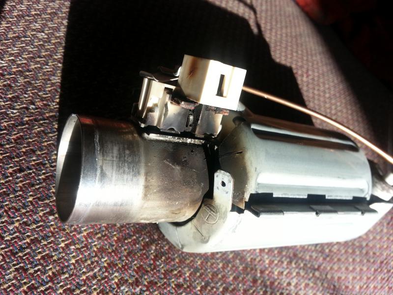

Ha ha, ok, I was looking for Smeg ones. I just bid £10 for the Zanussi one. Not sure if it's the same port sizes but the rest of it looks the same, connections, copper bars etc to will hopefully fit. Will check the numbers on the side for wattage etc before fitting.

Yes, I asked the same earlier this morning. He'll be wondering what's with all the questions :-) I'll get another look at the washer later today and get the sizes off the heater. Cheers :-)

No, no RCDs here. Just old fashioned fuses. It was definitely the fuse in the mains plug that was blowing.
if, as is very common, the heating element had broken down with age, the RCD would probably have tripped very quickly, preventing danger and damage.
Yes that was established but no mention of it tripping main board, just curiousity why main board not tripping but understand now as they are cartridge fuses.
The wattage on the playe on the side of the door says 1900kw but the Zanussi heater is 2kw. Will this be too much?
It will be fine, will just simply heat the water slightly quicker, probably won't be noticeable in regard to cycle lengths of time.
Pretty evident thats the culprit, be sure to use new clips when fitting new heater and check for leaks before re-fitting side panel and re-locating back to its 'home'.
Heater fitted, connectors replaced, new clips fitted and have run a full wash program with no leaks or cutting out. All seems to be well again.

Did you clean or replace the plug that fits onto the new heater? You don't want dirty contacts causing issues at a later date.
Other than that sounds like you've done a grand job!
It would also be adviseable to clean the filters inside the tub and check your spray arms are clean and clear or food particles etc. Run on the hottest wash programme with a dishwasher cleaner and hopefully it will give you good service for a few more years.
Er, I just crimped new connectors onto the ends of the wires and pushed them onto the connections on the heater, without using a plug. I made sure the connectors are nowhere near touching. Safer with a proper plug I know but seems to be ok for now.
Will see about running some dishwasher cleaner through the machine soon.
