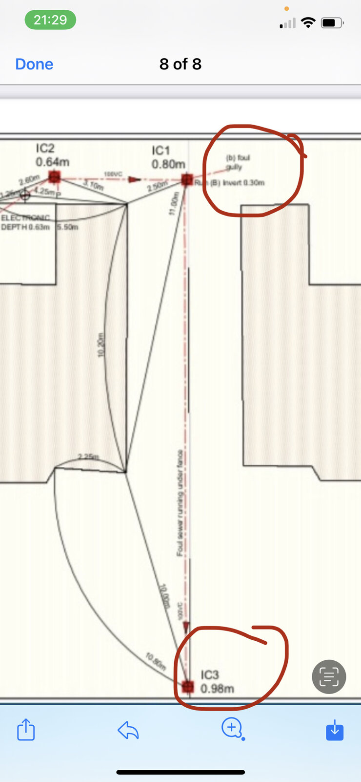

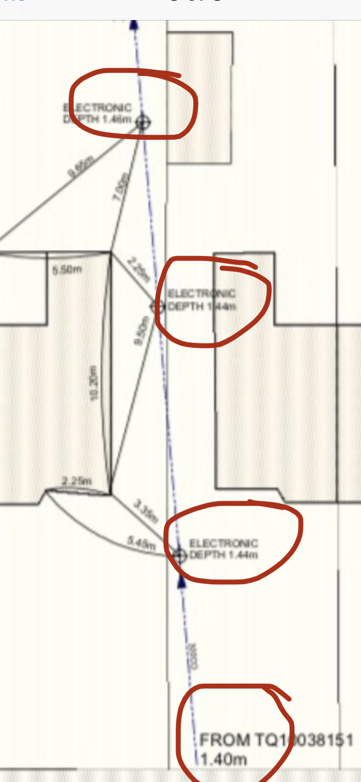

Soakaway for the street scuppering my extension
I'm reading the main sewer is 0.8m at the shallow end and the gulley pipe that feeds into it is 300mm deep?
I took it as these measurements, perhaps I’m looking at the wrong thing?

Southern water will want footings 500mm away from the pipe and anything within 3m will need to be 150mm below the invert. Just been through this with mine. They are pretty helpful on the phone especially if you have a building regs application number.

This just looks like standard foul and surface water drains to me. There is always a solution, the question is how much work is involved and at what cost? An application to the water authority normally costs £350, but you do have to provide details of what you propose. First stage for me is to determine the precise depth and location of the drain/sewer? There is no point making plans until you know the precise locations. The drawing may or may not be that accurate, so you can't go by that. When you know depth and location, you can work out what to propose.

The drawing was after a camera inspection of the drains, they have determined the depths from what I understand from the picture?
Next step then is decide on alternative routes and access points, prepare a plan and submit for approval. Once submitted you'll get to an engineer who are usually quite helpful. A bit of backwards and forwards and you should be able to agree on a solution. Involve your builder so they can advise on costs as you proceed.

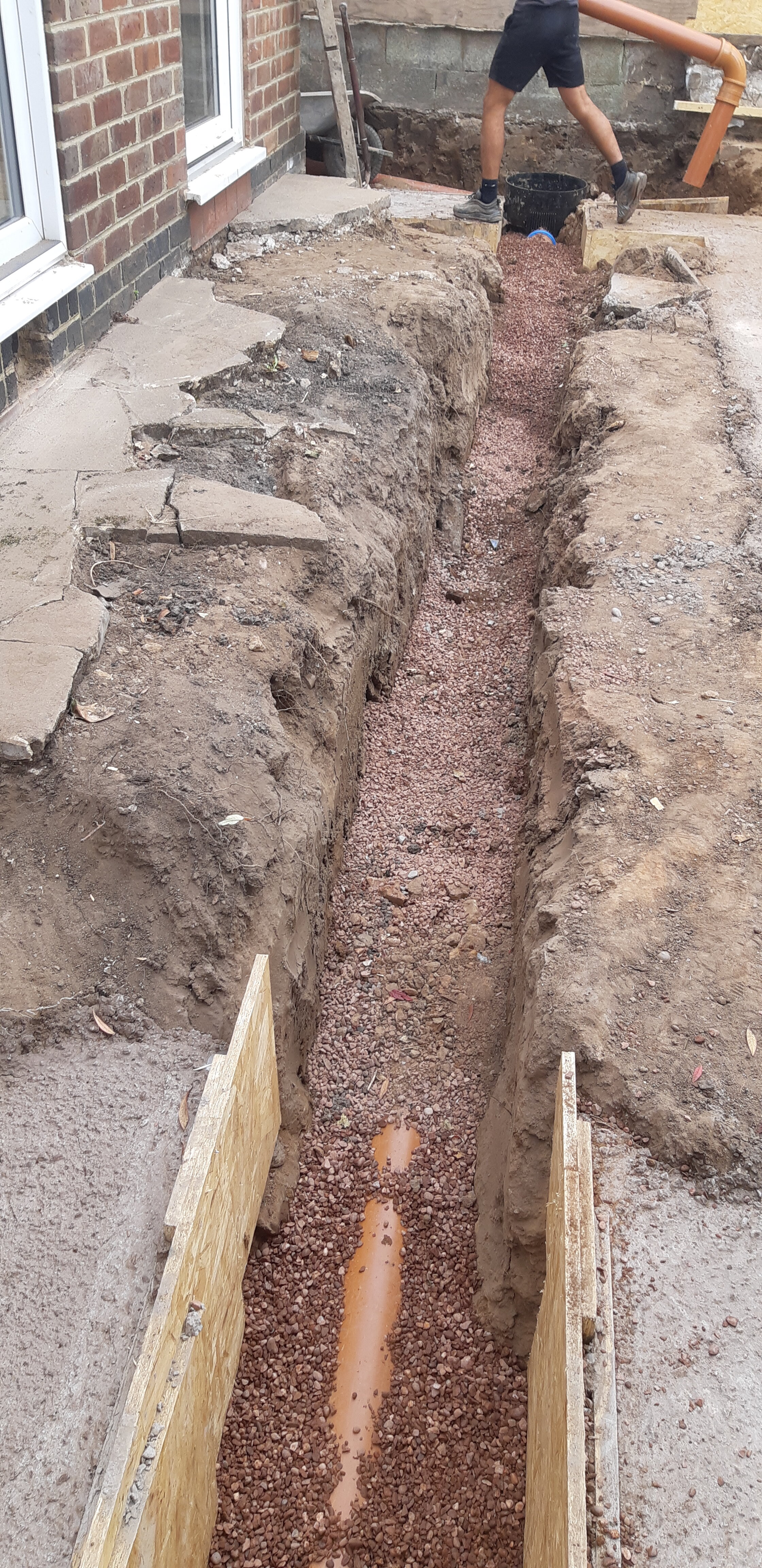

That’s a 6” main sewer running smack below the middle of a single storey extension as is the (different site) bottom pic.
