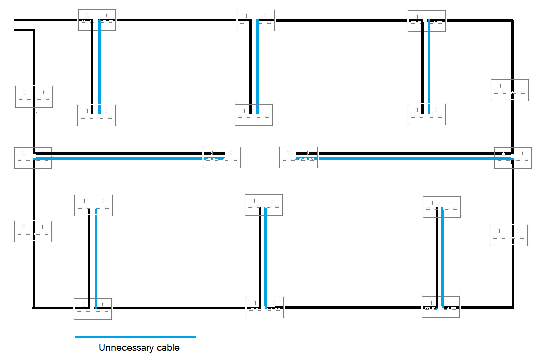

However, that has to be balanced against the fact that those sockets which are on spurs may well have a higher Zs than they would have done if on the ring.
Not if there are several such spurs and consequently a considerably shorter ring.
FWIW, I certainly don't personally subscribe to the view that it is 'wrong' (at least, 'bad practice') to design a ring final with spurs.
It is obviously not, but some people say it would be better with all sockets on the ring - just in case; it wouldn't.
Not to scale. :)
It is obviously not, but some people say it would be better with all sockets on the ring - just in case; it wouldn't. <diagram of ring arrangement, with and without spurs>
It may not be possible/practicable/efficient in terms of cable routing, but if that is not a problem, it is often possible to modify the topology of a ring such that having everything 'on the ring' uses little/no more (maybe even less) cable than does your arrangement with multiple spurs - see red lines added to your diagram:
Kind Regards, John

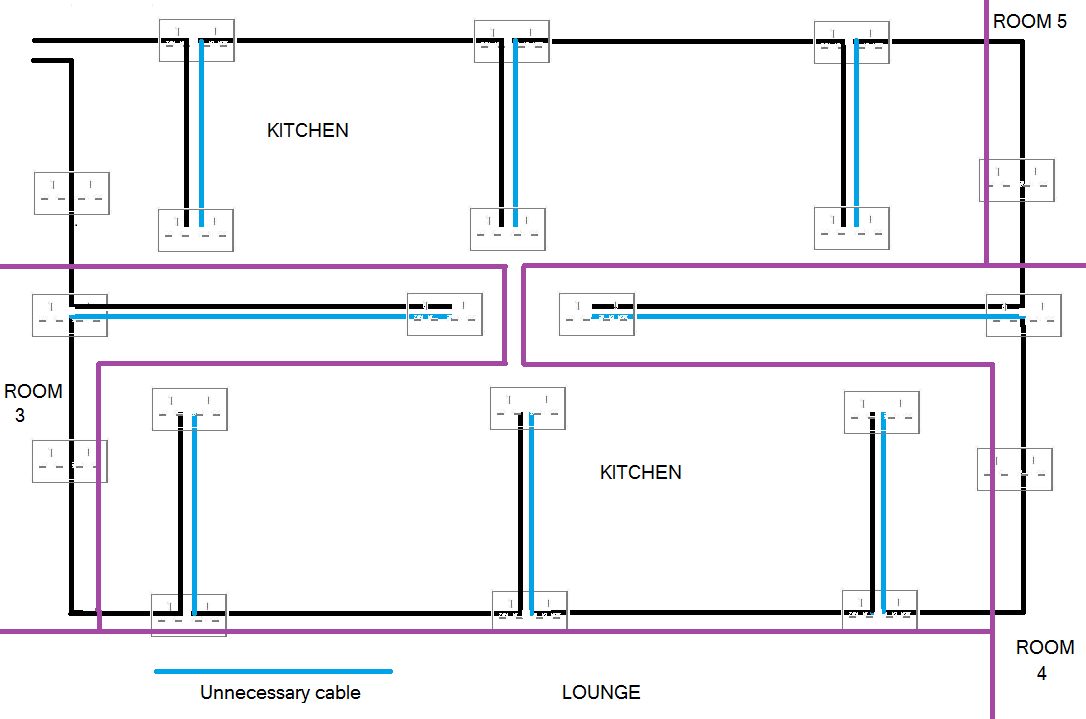

No. That's not possible. Several separate rooms.
I wouldn't have been daft enough to spur sockets which would be better on the ring.
I did say it was not to scale and, of course, the sockets are not on the floor.
I think you are taking my original statement a little too far,
OK - but unless you show me where the room boundaries are, I can't consider whether there might be a viable 'all on the ring' option! Mind you, the fact that sockets are not all in the same room does not necessarily preclude a ring which 'jumps between rooms' (if they are adjacent, horizontally or vertically)!
Kind Regards, John
It doesn't really matter.
Whatever you do, and even what you have drawn (red line), will lengthen the ring, won't it?
I agree that this may not matter but that is the point I am making.
Ok. so the whole diagram is one kitchen, the top and bottom lines are above worktop ring and the spurs are appliance below.
However the two centre sockets, on horizontal spurs, are actually in rooms to the left and right (drawn like that for ease).
Not necessarily. When printed out on A4, my 'red line' is around 980 mm in length, in comparison with your black line (ring with multiple spurs) at about 1000 mm - i.e. virtually identical.
Ok. so the whole diagram is one kitchen, the top and bottom lines are above worktop ring and the spurs are appliance below. However the two centre sockets, on horizontal spurs, are actually in rooms to the left and right (drawn like that for ease).
Fair enough - although I would probably question the wisdom of having one circuit (of whatever configuration) supplying a kitchen (including 6 below-counter double sockets 'for appliances') plus three or four other rooms.
However, I don't think that anything is to be gained by debating details. I have already agreed with you, both explicitly and by implication, that I agree that it can be appropriate to design a ring with spurs - and I certainly agree that one should not avoid using spurs "just in case someone wants to add spurs in the future". Most of the rings in my house have had multiple spurs ever since they were first installed (and have undoubtedly gained a good few subsequently!). The only real downside I can think of is that the spurred sockets do not benefit from 'CPC redundancy', but I know that you (and probably I !) do not regard that as very important.
