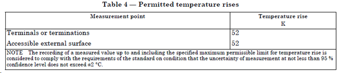

Not quite. BS1361 does not seem to say anything about "evidence of damage", but merely that, with the specified test current (14A+6A = 20A in the case of a double socket) there should not be more than a 52 K temp rise within 4-8 hours (see note below) - which I imagine would not be enough to result in any visible damage ...
