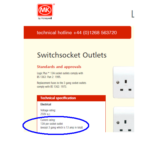

    What do you understand the term "socket outlet to mean? In particular, do you believe that a double socket has one or two of them?

    The MK technical data sheet says that their double (and single) sockets are rated at "13A per socket outlet". That presumably means that, depending upon how one interprets "socket outlet" (which is why I asked you) a double socket is rated at either 13A or 26A - and, given what you've just said, you seem to believe that it's the latter. Where did your '20A' rating for the MK product come from? The test current for the BS1363 temperature rise test is 20A, so that is the minimum requirement - but that does not in any way prevent MK manufacturing a product which exceeds that minimum requirement, hence with a specified (by them) rating above 20A.

    It has often been discussed on these forums that the minimum requirement to satisfy BS1363 is that a double socket has to be able to pass a temperature rise test at 20A total (14A + 6A). It has also often been discussed that this in no way prevents a company manufacturing a product which exceeds that minimum requirement and specifying its rating accordingly.
    As I have illustrated, MK specify the rating of their double socket as "13A per socket outlet" which, with your apparent agreement, equates to 26A total (13A x 2 outlets = 26A). If MK specify the rating as 26A total, in what sense can the 'rating' be 20A?

    Well perhaps I am wrong about a double socket only being rated at 20 amps but I have certainly seen double sockets fail at greater currents, the usual being a washing machine and tumble dryer both in one double socket.

    Well there are double 13A sockets that are rated at 13A the pair, always seem to be special in some way, USB outlets, filters, or RCD built in, most double sockets are rated at 26 amp the pair.
    But those with 13 amp per pair do seem to have a thermal overload built in, this is from MK filtered socket spec. Filtered socket spec.jpg Note reference to thermal overload.

    As I've illustrated, you are wrong in terms of MK's specified rating of their double sockets. However ...
    We do, indeed, hear reports of that, but we also hear similar of single sockets used toi supply loads which draw high currents for fairly long periods (again, things like tumble dryers). In those cases the thermal damage is commonly in the vicinity of the L pin, suggesting that heat is generated in/around the plug fuse and/or electrical connections to it. If that's the case, then I would have thought that what was current was being drawn through the 'other outlet' of the double socket would have little to do with the damage.
