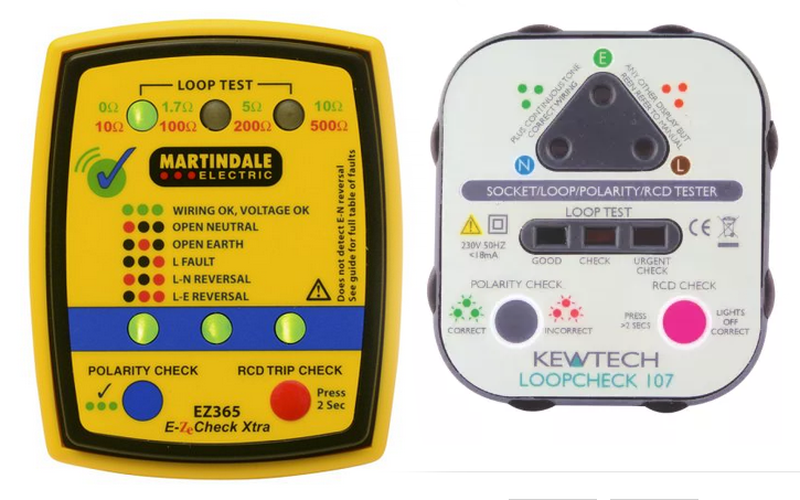

However to test a socket has a earth connection, only way without removing some protection like covers on the consumer unit is to measure the earth loop impedance, and the neutral loop impedance, which should not be the same. Even if very close to each other. And the socket tester with loop only tests the earth loop impedance, so can't detect if same wire used for earth and neutral, however if the RCD test works, then the socket clearly must have an earth, so testers like these

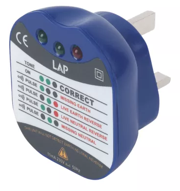

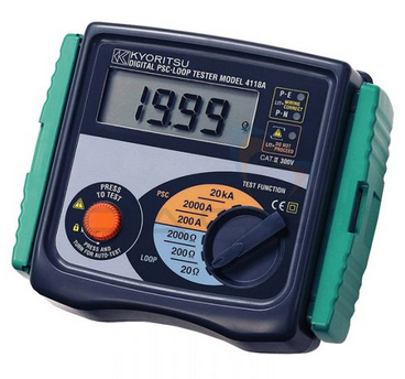

Do a reasonable job at testing the socket outlets, but one like this 1679126322206.pngis of very limited use, can check if plug correct way around when using a caravan abroad, and if a wire is completely disconnected, but without the loop and RCD test it can't show that much. But we are looking at under £7 to more like £65 for the one with Loop and RCD test. But for a proper loop impedance and prospective short circuit current tester 1679127044508.pngthey start at around the £150 mark so the EZ365 is cheap when compared with them. Most of the proper loop testers are over £250 so one shown is rather cheap. Did find this one 1679127502286.pngat under £120 but it only does loop and PSCC so would still need other test gear to do other tests. Insulation testers I have found down to £35 but loop and RCD testers not found any really cheap versions.
